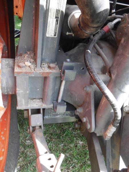

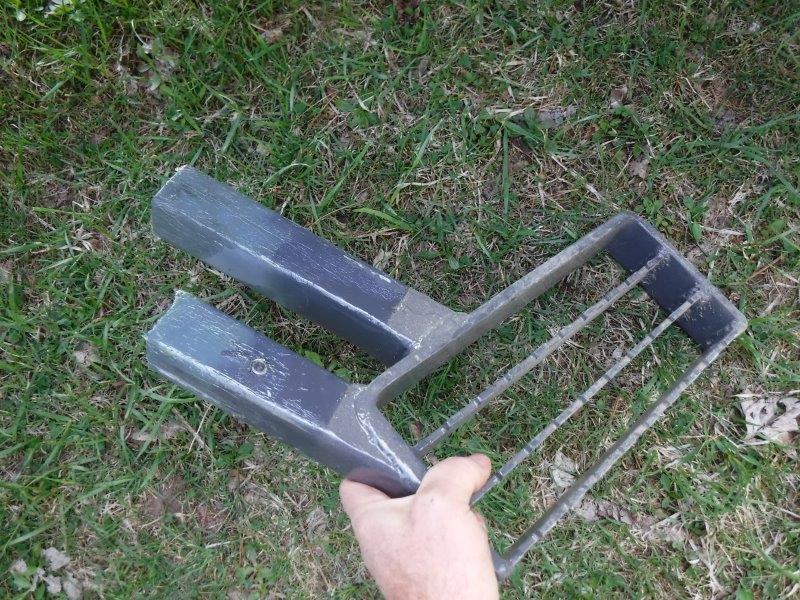

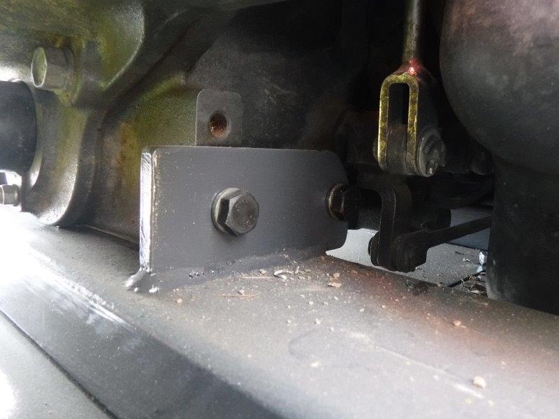

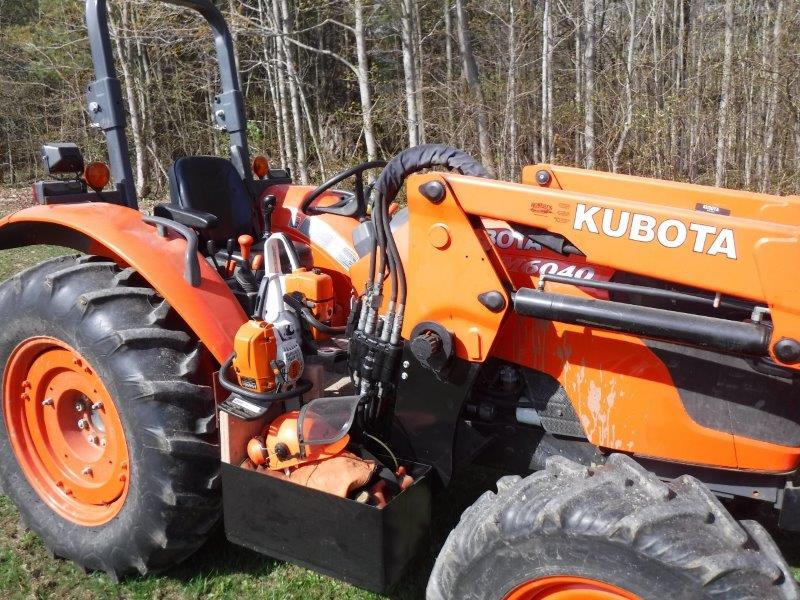

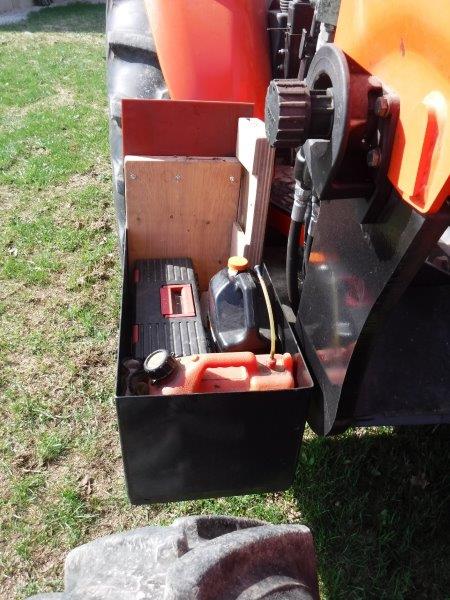

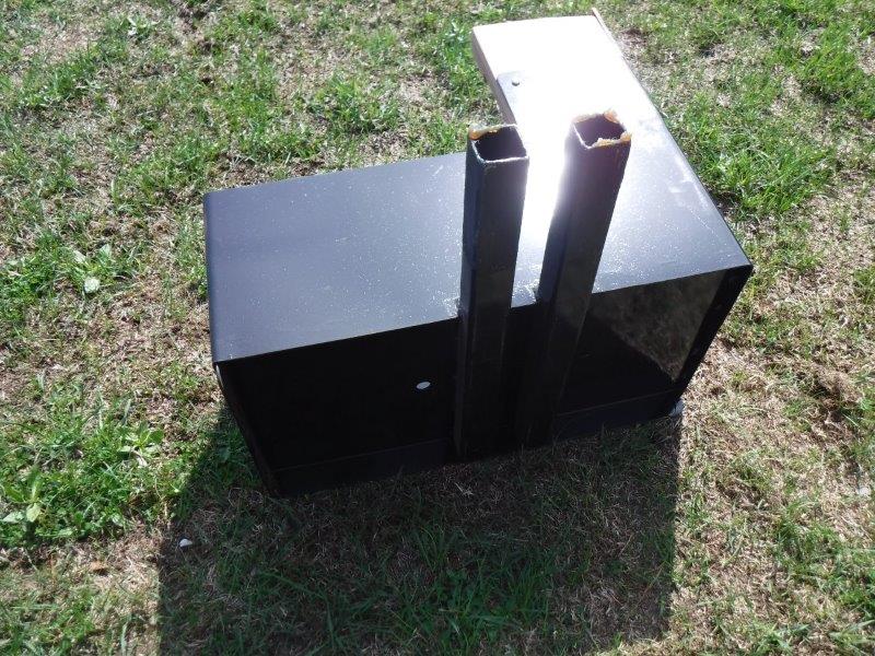

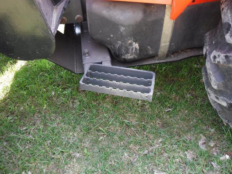

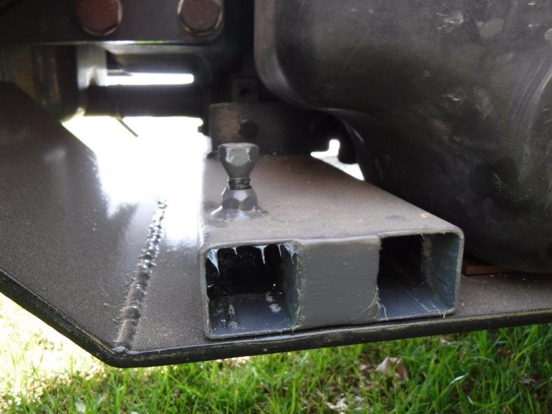

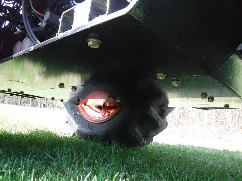

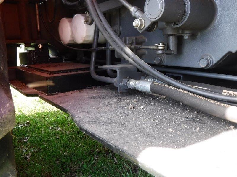

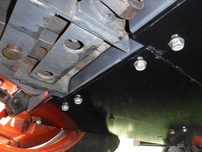

I was looking for a skid plate solution for my M6040 for a while and I would like to thank Rustyiron for his photos and ideas. In return, I am posting the results of my handiwork.
My goal was to provide bottom side protection for the tractor as well as add weight to the back as the loader can lift more than the tractor should allow. I also wanted to re-do the step and, above all, make a spot for the chainsaws and tools i.e. a removable toolbox.
Here are a few photos. I can post more if there is a need, or please let me know if anyone has any specific questions where I can be of assistance.
Skid plate is 3 pieces of 3/8 x 12" flat bar
2X2 tubing for front, center and rear frame
1 3/4 tubing inserted for the toolbox and step
Extra scrap steel weight added where space allowed
toolbox is 12" x 24" x 10" high, and keeps my saws where I can see them. 1 - M6040 Toolbox Mounted.jpg2 - M6040 Skid Plate.jpg3 - M6040 Skid Plate - Front.jpg4 - M6040 Skid Plate - Rear.jpg5 - M6040 Step.jpg6 - M6040 New Step.jpg7 - M6040 Skid Plate - Front Frame.jpg

Here are a few more photos.
I think the M7040 has the same frame as the M6040, but I'm sure someone here can confirm or deny that.

You should be pretty happy with that it came out good !! That is pretty rugged protection with 3/8. What did you do up front under the motor and around the front axle area ?? I want to put something there on my M5640 but am undecided how to hook it. Looking for ideas.
