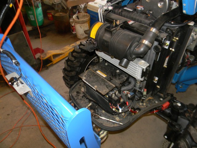

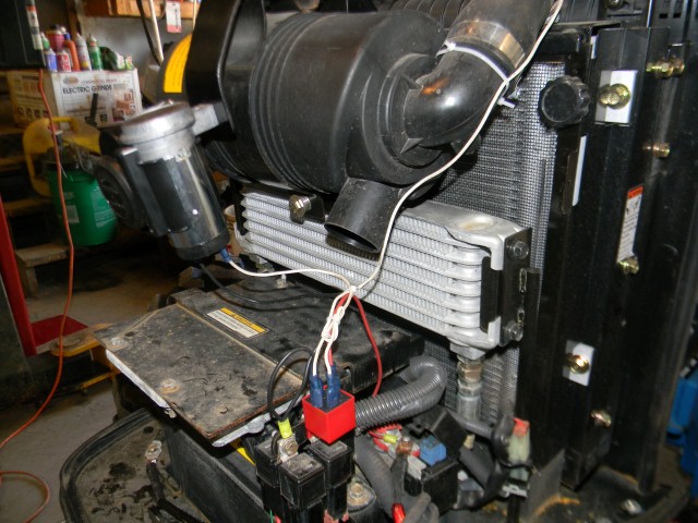

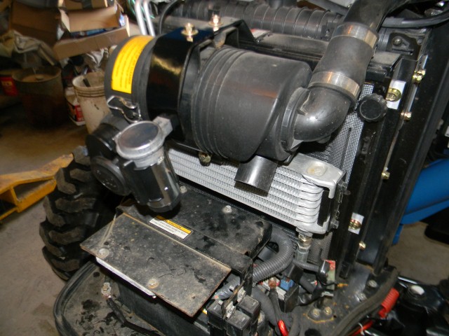

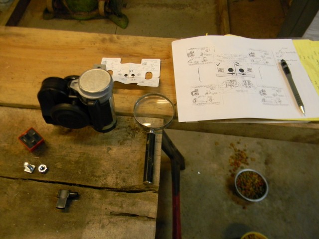

Thought I'd post a few pics of my horn install. I did not remove the original horn, just unplugged it. I made a bracket and mounted mine in front of the air cleaner. I tried enlarging the directions that came with the horn (no way I could read that small print) but the full page enlarged view was too blurry to read. A magnifying glass did work to figure out the wiring. I ran a wire from the original horn plug on the firewall up to the relay which I mounted with the others not far from the battery. I have a nice loud horn now. For anyone else buying one of these horns and can't read the miniature printed instructions there are 4 terminals on the new horn relay. Here's the wiring pin out for the relay.
Terminal 30 - Battery positive
Terminal 86 - Wire from original horn button
Terminal 85 - Ground
Terminal 87 - Goes to plus terminal of horn
Minus terminal of horn goes to ground.
