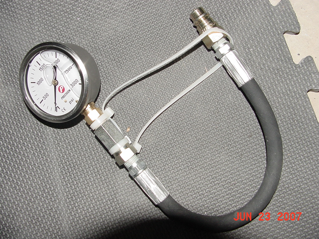

First thing I would do is install a hyd gage in the system ane it will help you trouble shoot your hyd system.
How many hyd pumps on your tractor?
If the pump is good, and the valve is good, then the pump is pumping and the fluid has to go somewhere, and if the valve routes the fluid to a cyl, the cyl should move. That being said, the flow from the cyl should not be blocked anywhere.
If the relief in the FEL vale is stuck open, your lift circuits can not develop the necessary power, and the fluid will get hot.
Does you 3pt system work correctly? If so, that means that your pump is good.
