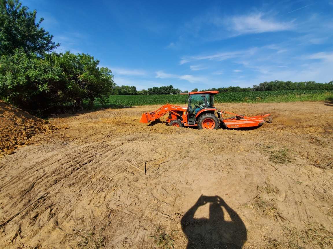

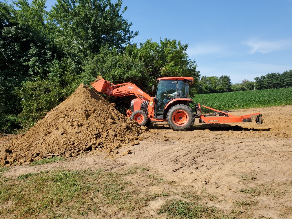

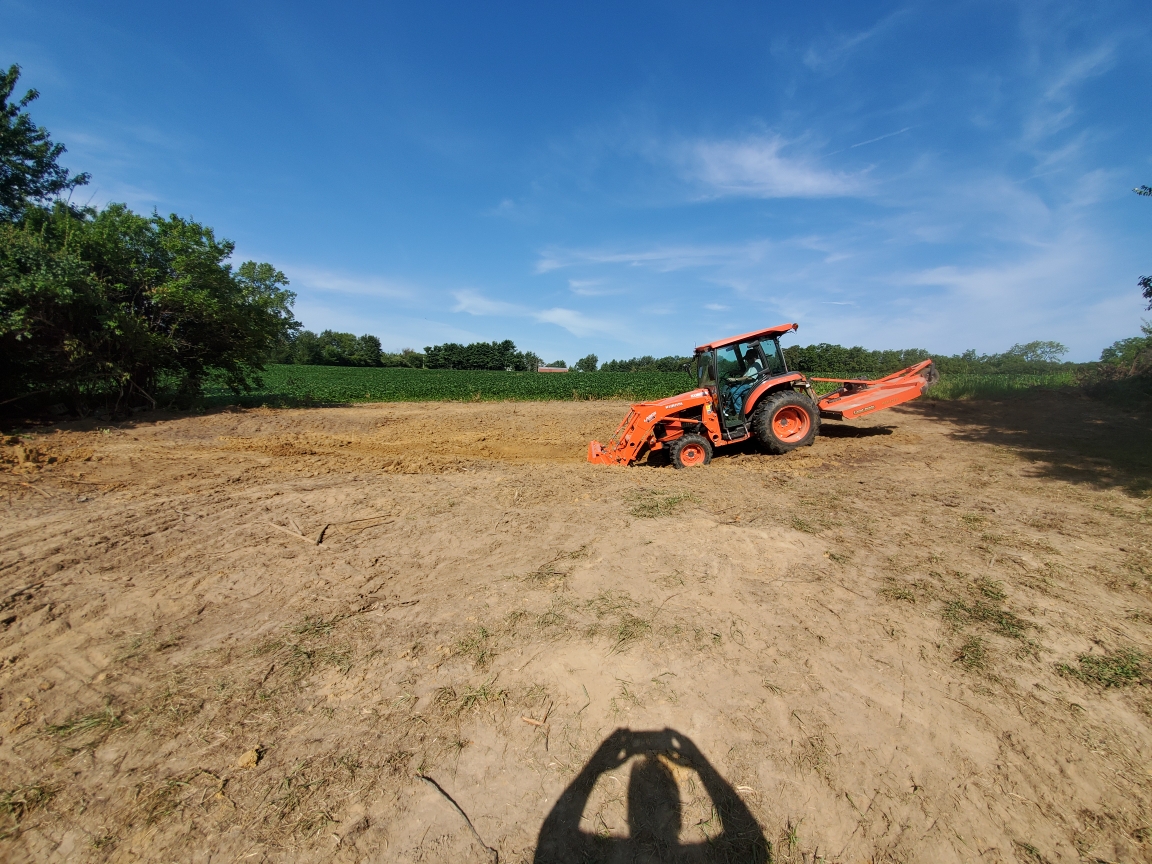

I will add to your confusion, My Grand L3560 has completed the dirt work, pushing and dragging trees, and mowing without any issues. The only thing I can't answer is how it would do snow blowing.
