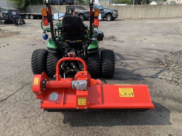

Can someone post a picture of how you mount an implement off center. I don't get it?
   / looking to buy a 3 pt tiller #27
First off the implement has to be capable of it.
On my flail mower the mounts for the lower draft arms and for the top link have two places on the mower where they can be bolted on. Depending on which you use the body of the mower will be somewhat centered in relation to the tractor or it will be shifted to one side. So one side of the mower sticks out beyond the rear tires more than the other side.
It would look something like this when offset. See how the 3-point mount is still directly behind the tractor but the implement is offset to the right side of the tractor rather than being directly behind.
   / looking to buy a 3 pt tiller #28
If you only need a small amount, tighten the stabilizer on one side while you loosen the other side.
