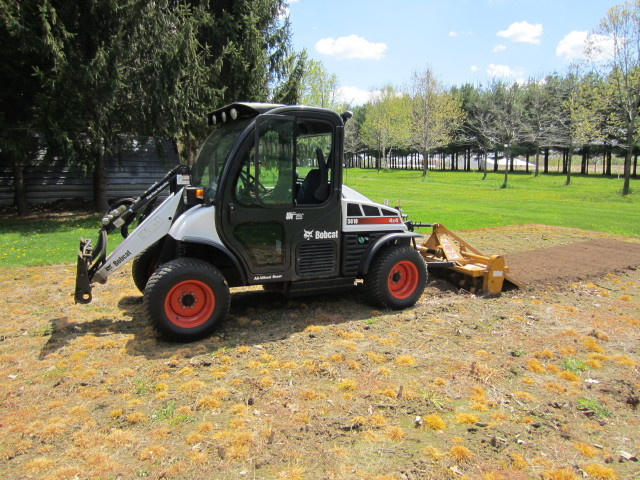

Once I sold the NH and bought the Toolcat, my 5' KK tiller is now 6"+ narrower than the track. I just offset the tiller using the 3pt stabilizers so it covers one tire track. Then, the final pass has no tracks because the tires are in the grass. (y)
Clever! Will keep that in mind.
