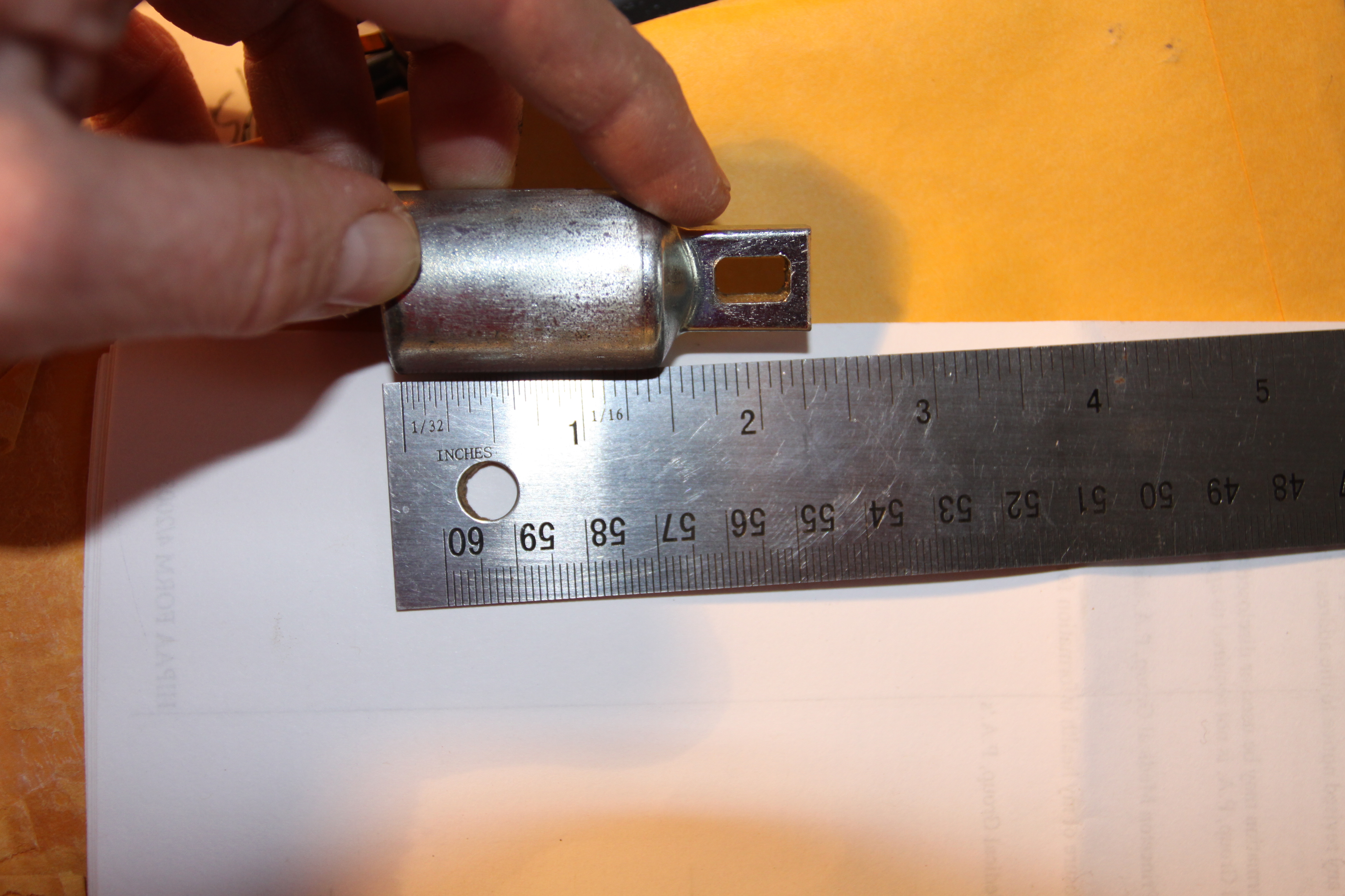

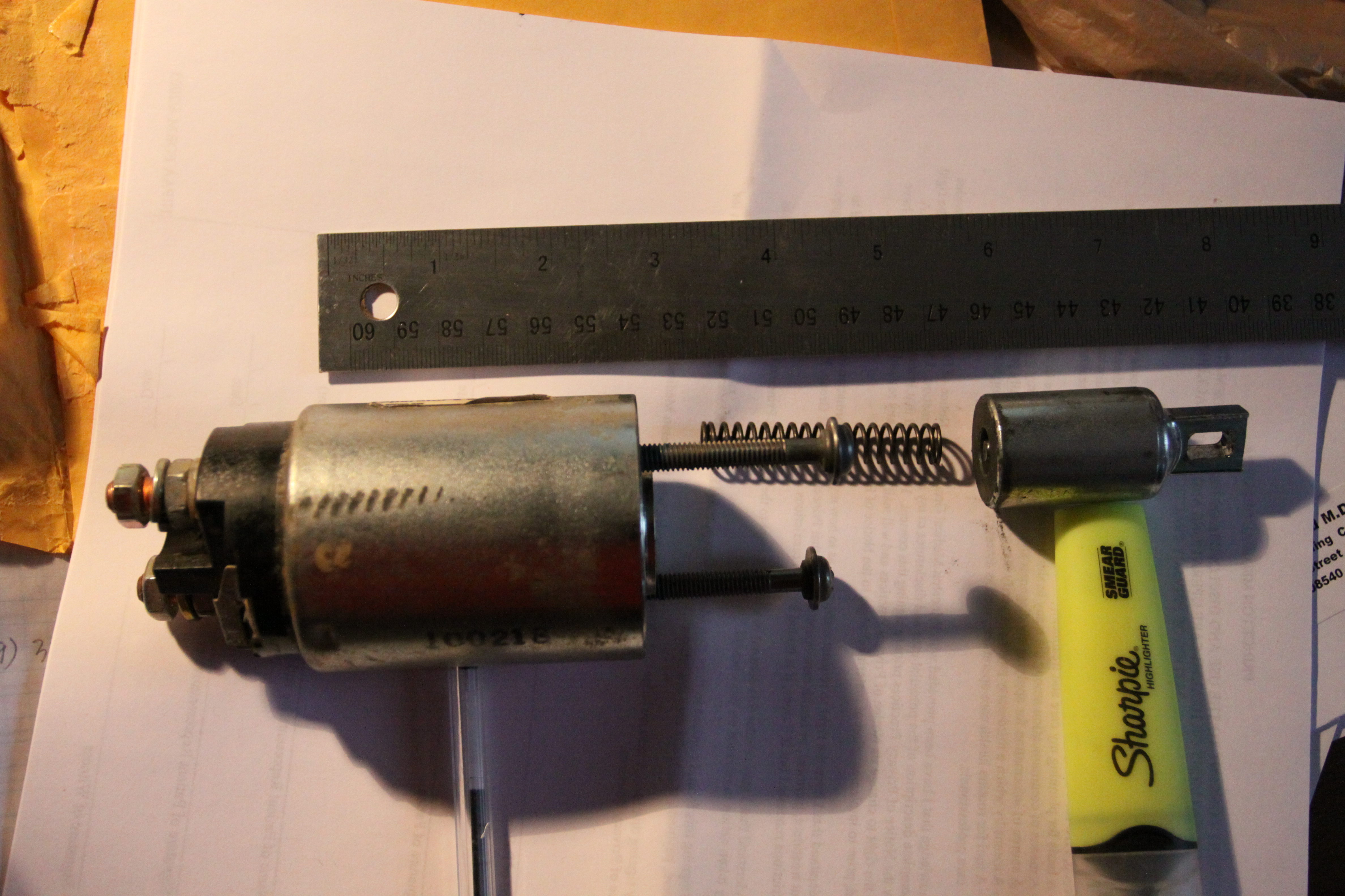

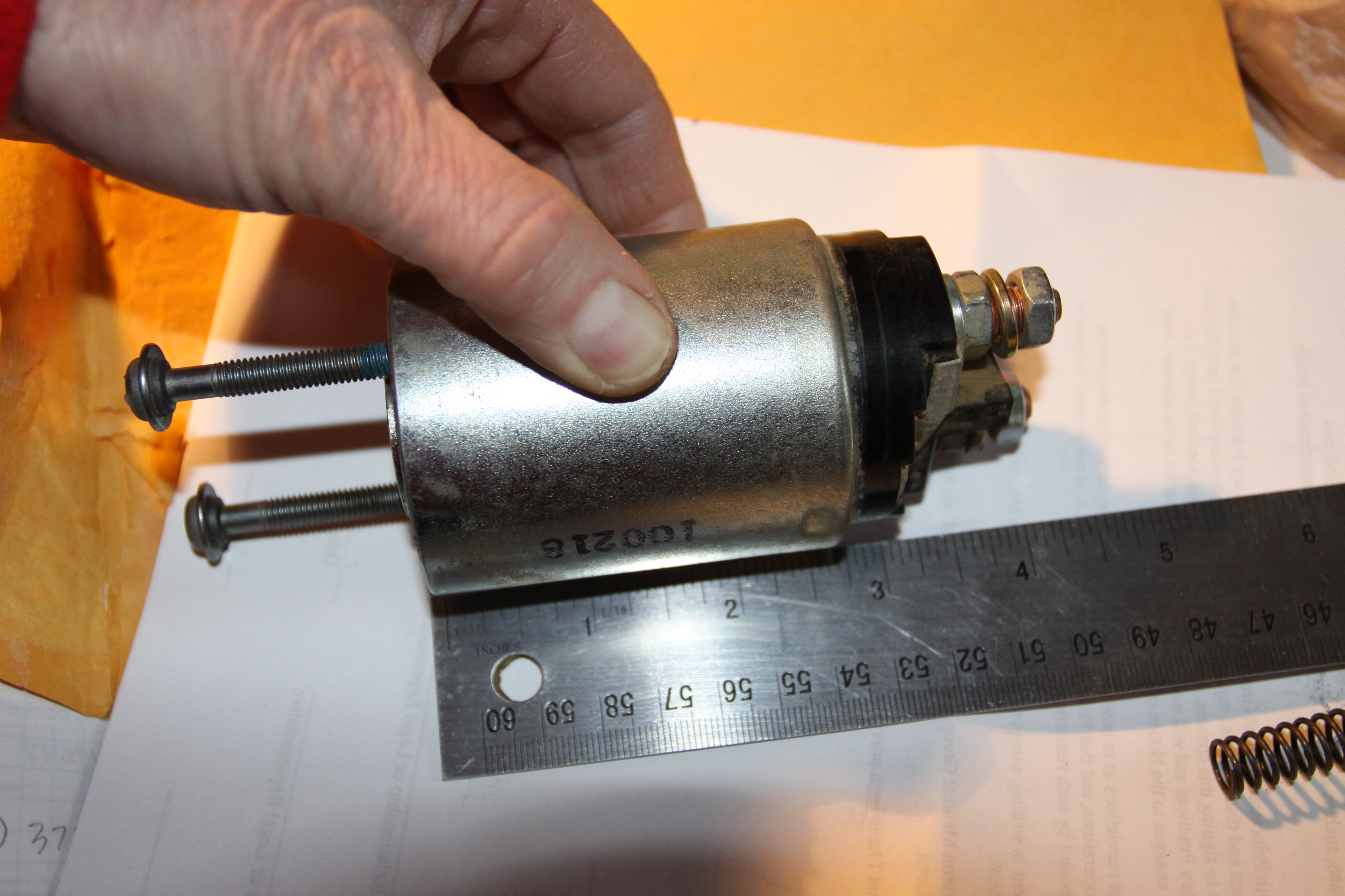

Hi,
Trying to find solenoid to repair starter (bobcat part # 7010574) on my CT440 tractor.
Dealer offered whole starter for $522 and waiting time 2 weeks. Internet search gave me price $385.
But I want to find solenoid.
Starter itself is Valeo 1196451.
I saw a lot of solenoids on eBay but I'm not sure if I can buy any.
Did somebody have experience with this type of replacement/repair?
Thank you,
Elena.

   / Looking for Solenoid Starter for BOBCAT compact tractor CT440
some pictures of this solenoid
