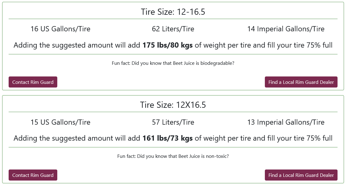

Is anyone here running the R3 Versa Turfs on their 2025R that used Rimguard? I'm trying to calculate the cost as my dealership was VERY high. I'm thinking 15 gallons per tire. Is that correct for the R3's? TIA

$380.00-$400.00+ !!! I was quoted $213.00 and $250.00 by two Rimguard dealers. The Rimguard calculator shows 14-15 gallons. The dealership claimed 22 per tire. Even full if possible would only max 20 gallons.
I'm curious if anyone here with the Carlisle R3's had theirs done. Did you? If so how much? Thanks!

The chart doesn't lie. If that's your tire size, that's the capacity at 75% fill, which you don't want to exceed. The dealership staff is wrong, either by error or on purpose.
