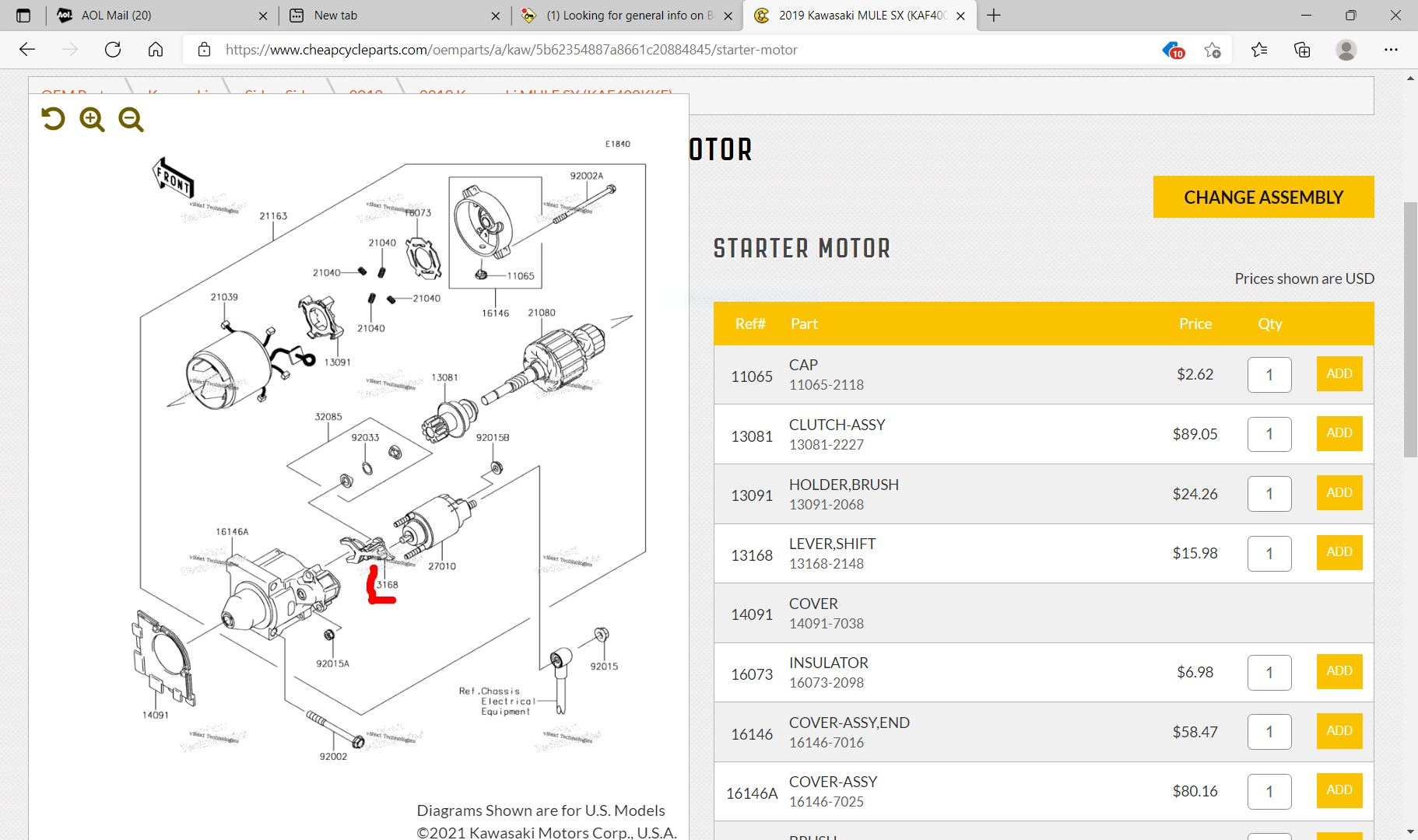

This is on a K-Mule that has given no problems. Have put a new battery in it. Turn ignition key and nothing happens, no click or light dimming, nothing! Jump across the solenoid and the starter motor runs but does not engage the engine. Looks as if we have a ignition switch problem and a Bendix problem. Why the sudden problem? What say you?

It may be the solenoid. That type starter uses a lever from the solenoid to the "bendix"/one way clutch. If not the solenoid, maybe, lever system is stuck/jambed?

It could be the "Bendix" The internal one-way clutch may be bad, so shaft spins, but does not spin the gear.
