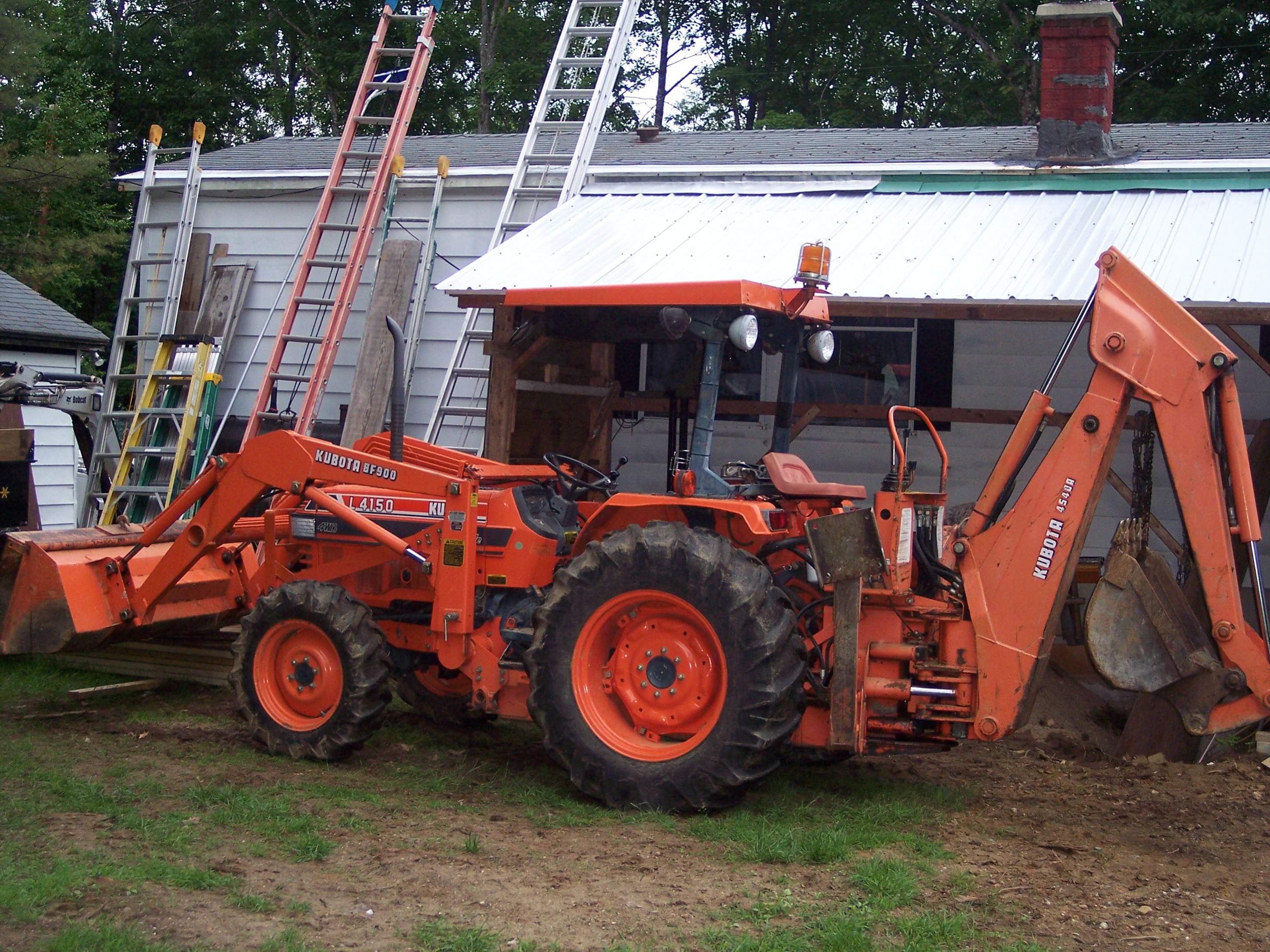

Hi, all i found this l4150 a little bit ago. i got the chance to operate it,not for a long period of time maybe 15-20 mins. Everything seems to work fine even the strobe light! was wondering what you all thought i should look for and what the going price might be? 102_4284.jpg
   / looking at this l4150 #2
It looks like nice Machine,if you are happy with it that's all that counts.
   / looking at this l4150 #3
Looks like it has been taken care of. I would ask for maintenance records, look for any signs of leaks, start it cold and listen for strange sounds, see if the hydraulics leak off after the engine is shut off. Maybe more but that's what I came up with off the top of my head.
   / looking at this l4150 #4
Its a great-looking tractor given it could be 25-30 years old. Hard to be sure from one picture - paint looks great like it has been kept inside. And the rubber looks like the original Bridgestones. You may have found something pretty special here. The L4150 was a very good product - common to see zero leaks unless they've been beat hard. If this one is as good mechanically as it looks cosmetically it could be worth $20k. Most L4150s are getting pretty worn - some are only worth 8k-12k even with a BH. Condition is everything. Good luck.
