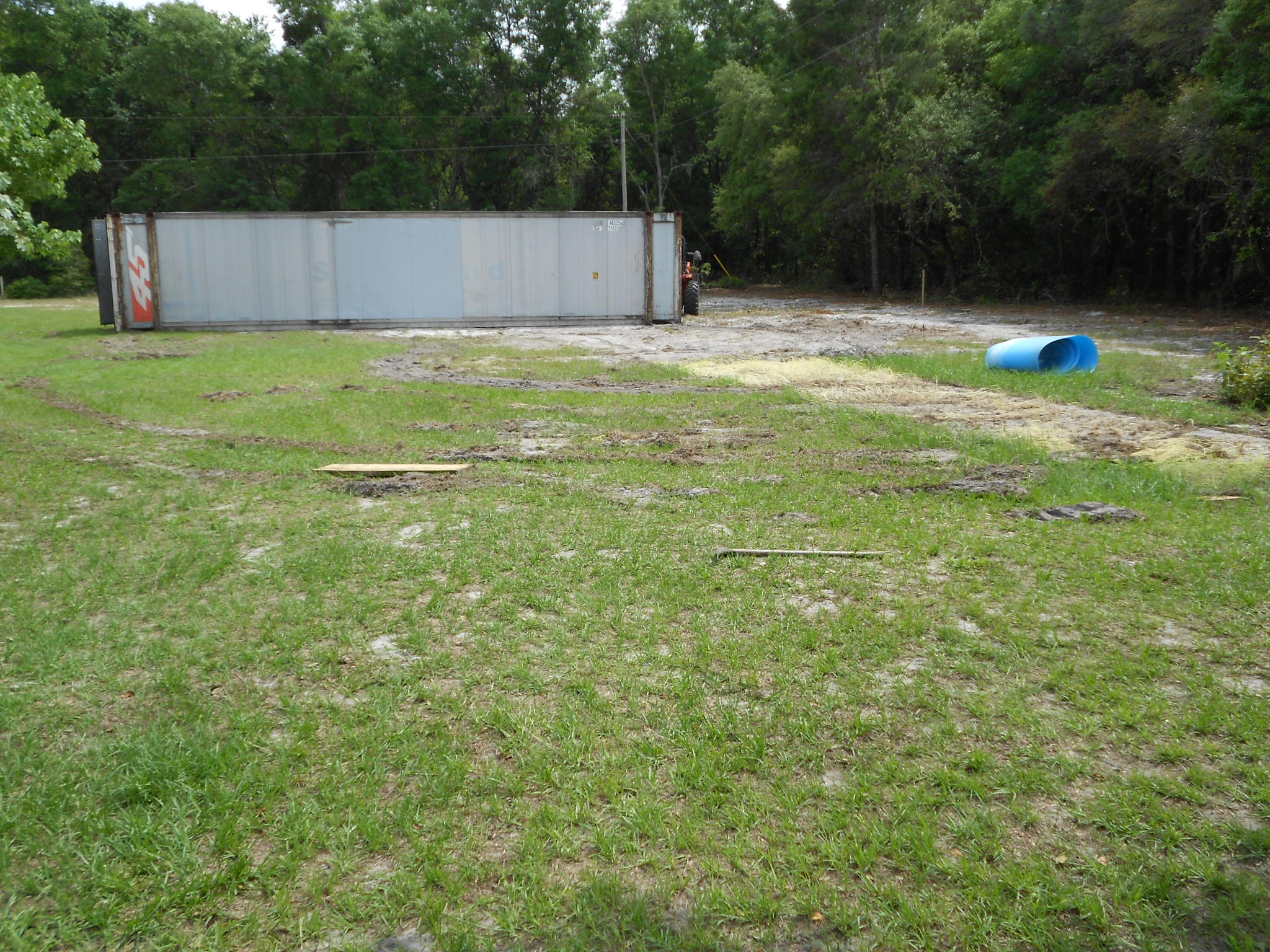

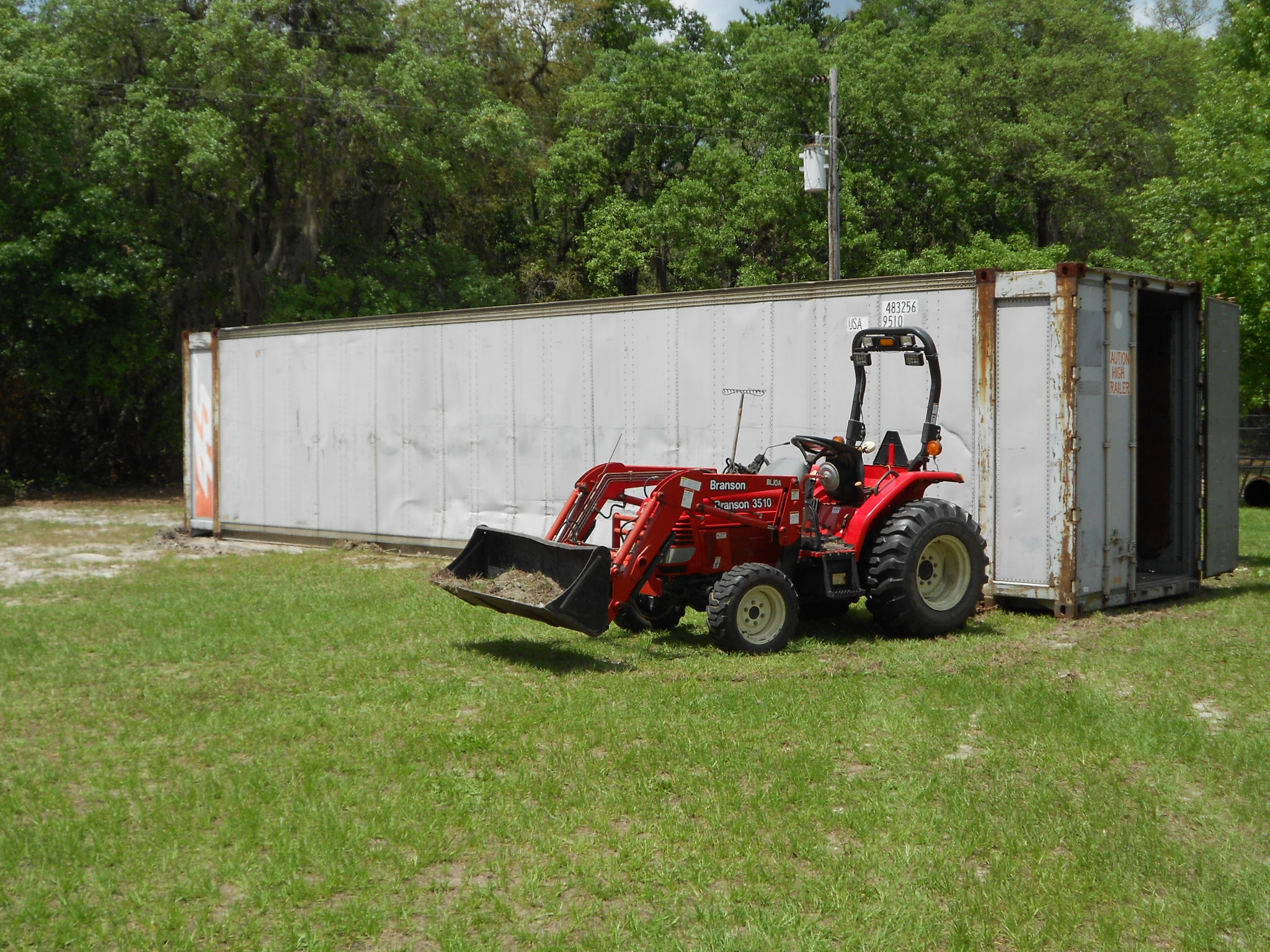

I bought my 3510 in 2005 and am still happy with it.
I recently looked at 2 tractors both 30's hp, RK on display and Mahindra that a friend bought.
I looked at the rear axles and axle housing. They looked less than heavy duty.
Probably 6" from housing to axle flange.
Then I looked at my Branson (had not really looked lately) and the Branson looks like industrial grade!
Very beefy and the housings come all the way out to the wheel mounting flange.
Some of the things I have done with my Branson I would be afraid to do with those tractors.
Like dragging this 10,000 lb container 75' and turning it 90*.
