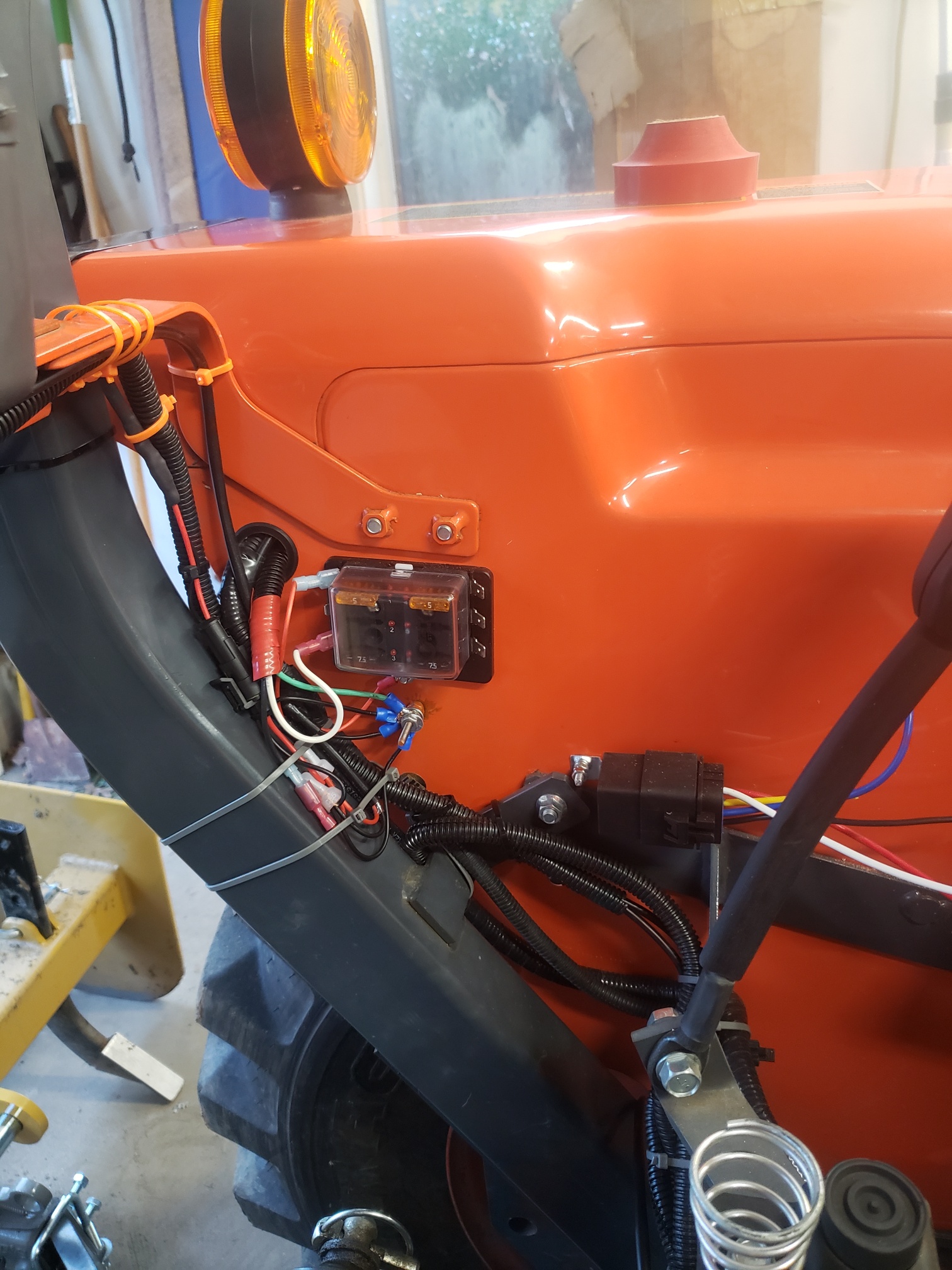

Ok - I gave up and bowed to the sage advice of those who know more than I!
I installed the switch I had already purchased and finished the install today :) So my two initial projects for the tractor are done (2 cameras in rear / monitor and rear work lights)
Finished fuse block:

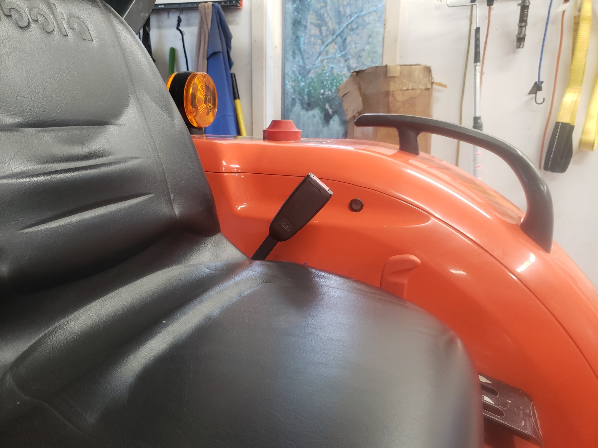

Installed switch on left fender:

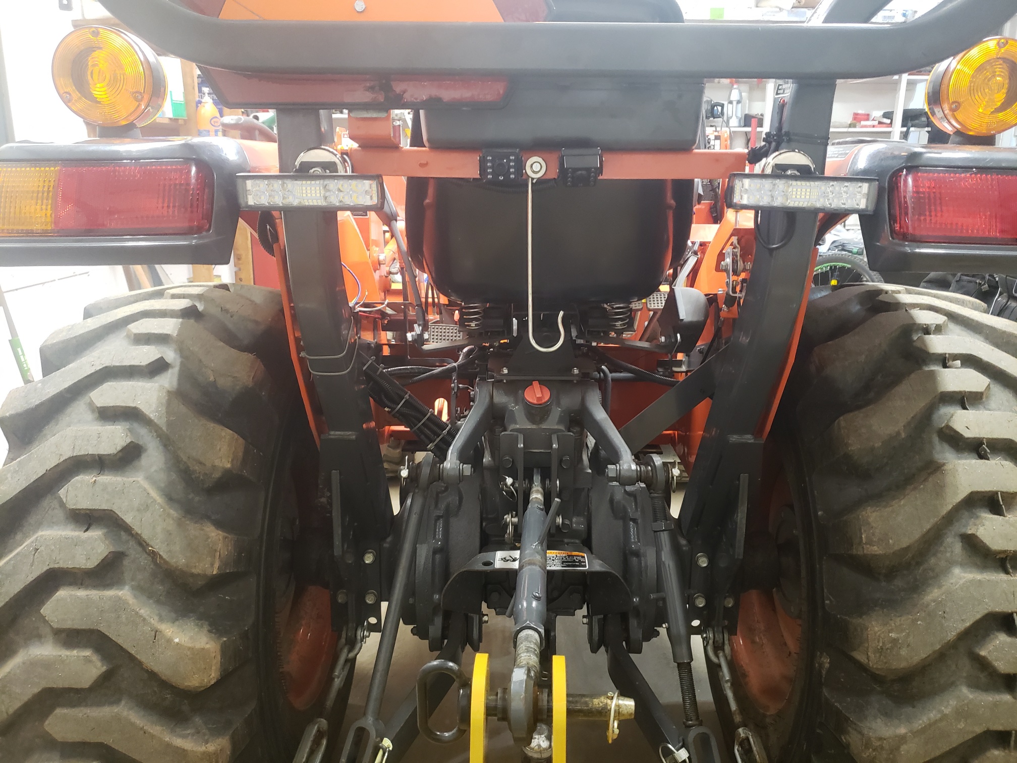

Lights and cameras:

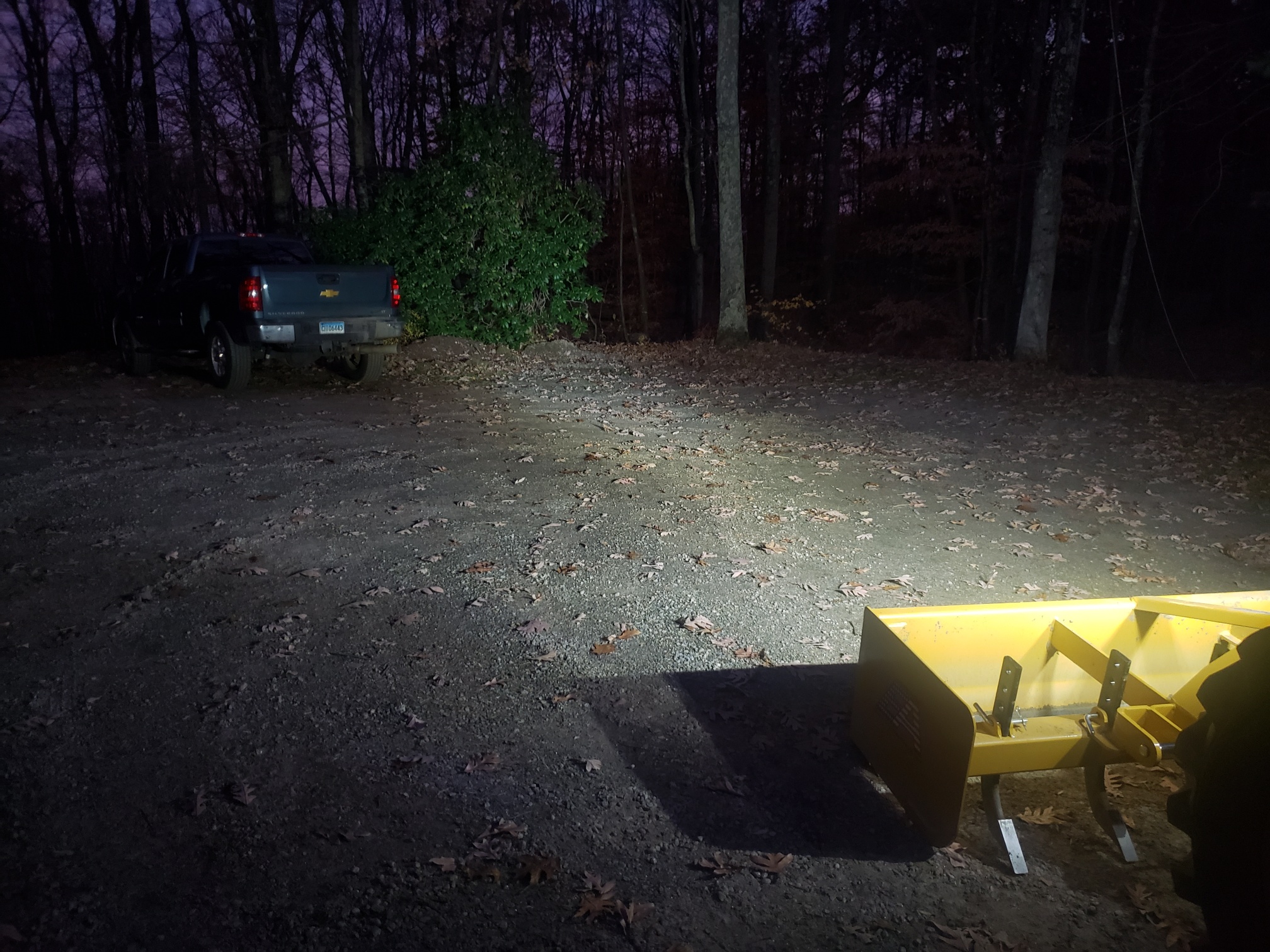

They work :) The trees are about 70 feet away from tractor:
