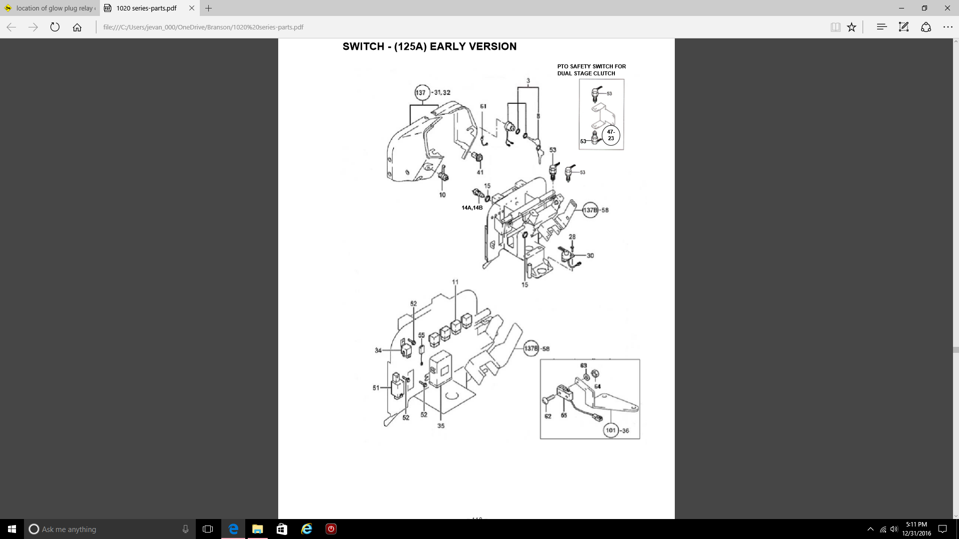

My tractor is 13 yrs old. Still loving it. It has been a dream to start in the cold winters, I am talking below 0 F starts.....well that is until this December. We had an unusually cold period in the middle of this month (single digits), and for the first time my tractor struggled to start. I am trying to figure out where the glow plug relay is located on this model. There is a relay located on the firewall next to the fuse box that reads omron KG8JR- 1 A2T DC 12v 70 A YDO. There also seems to be some relays located under the instrument panel/ steering wheel left side that look like a job to get to...eg take off some of the panels.
Can anybody out there point me to where this relay is on the 4020 and how to best access it?

I can check my manual and see if they list it in there.
   / location of glow plug relay on 2003 4020 #3
Hope this helps

Thanks Jason for taking the time and trouble to post the diagrams. I was starting to come to the conclusion that the relay out on the firewall might be the fuel solenoid relay, and that the glow plug relay was under the left side of instrument panel somewhere. Your diagrams and some parts lists that I looked at for the 4020R seem to indicate similar areas. I wish I had the proper 4020 service manual, but don't. We have had a few moderate temp days over the new years break, with today being last warm day before another artic blast...so hoping to dig into some testing on the tractor today. I plan on testing each glow plug, but I suspect with the suddeness of it going from working great, to being a dog to start might suggest relay not working correctly. This is what I hope to determine. I have enjoyed reading about your tractor purchase and subsequent upgrades. These are great tractors.
