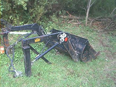

2000$ for a used loader is crazy. I think a new Koyker goes for around 2500. I picked up a used loader for $400, had to make up some brackets but it was worth it.
Works better than I thought it would.
p.s. if anyone wants to give me $2000+ they can have it.
