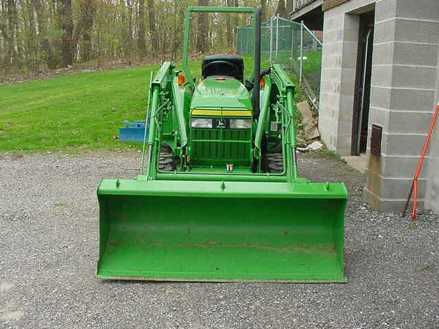

The attached picture shows what I had welded to my 790's bucket. This should be good for the loader's lift capacity.
If it makes you feel better, weld the hooks to a ¼" plate about 4" x4" or so, then weld the plate(s) to your loader.
That will be quite adequate unless you plan on some really heavy lifting.
BTW, the bucket material is .125" thick steel.

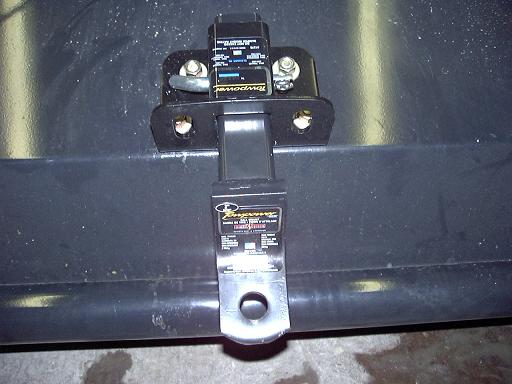

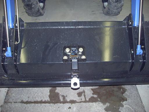

I just used a hitch mount with a drawbar. You can change attachments with this and still be able to use it for trailers etc. I just add a Clevis to the drawbar to lift and pull things. So far this has worked well. /forums/images/graemlins/smirk.gif
Hope this helps.

I can weld alright for a novice but I thought this made a cleaner bang up job. /forums/images/graemlins/smirk.gif
With four 1/2" bolts I don't think it will go anywhere. I have put some good stress on it so far and had no problems. I also have an oversized platform that fits right in and allows me to carry long objects such as conduit and steel I-beams etc. without having to lay it over my bucket cylinders and scratching all the paint off. /forums/images/graemlins/grin.gif
