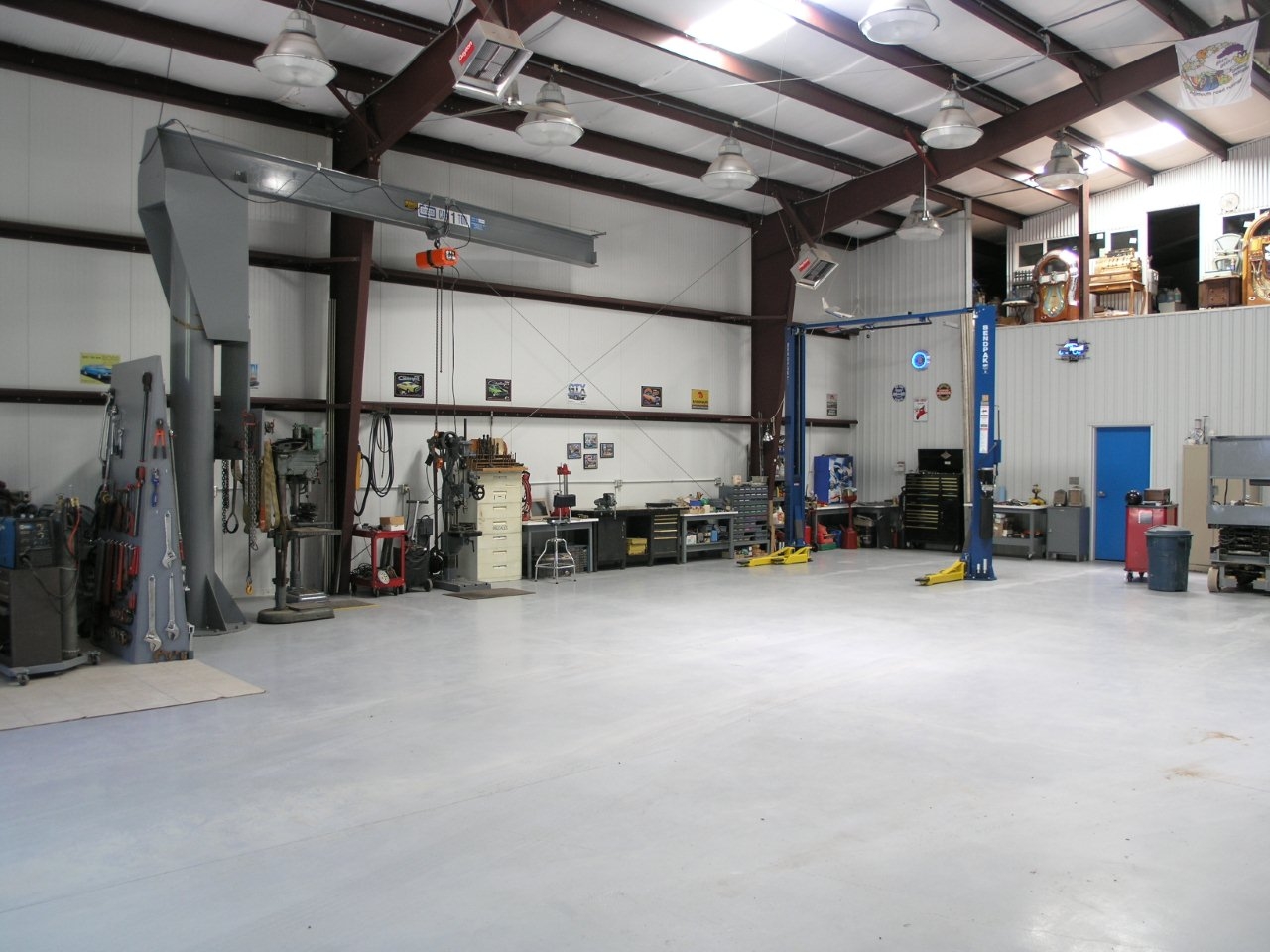

Check for local restrictions on pits. Many locations ban them since they are a fall risk if left uncovered.

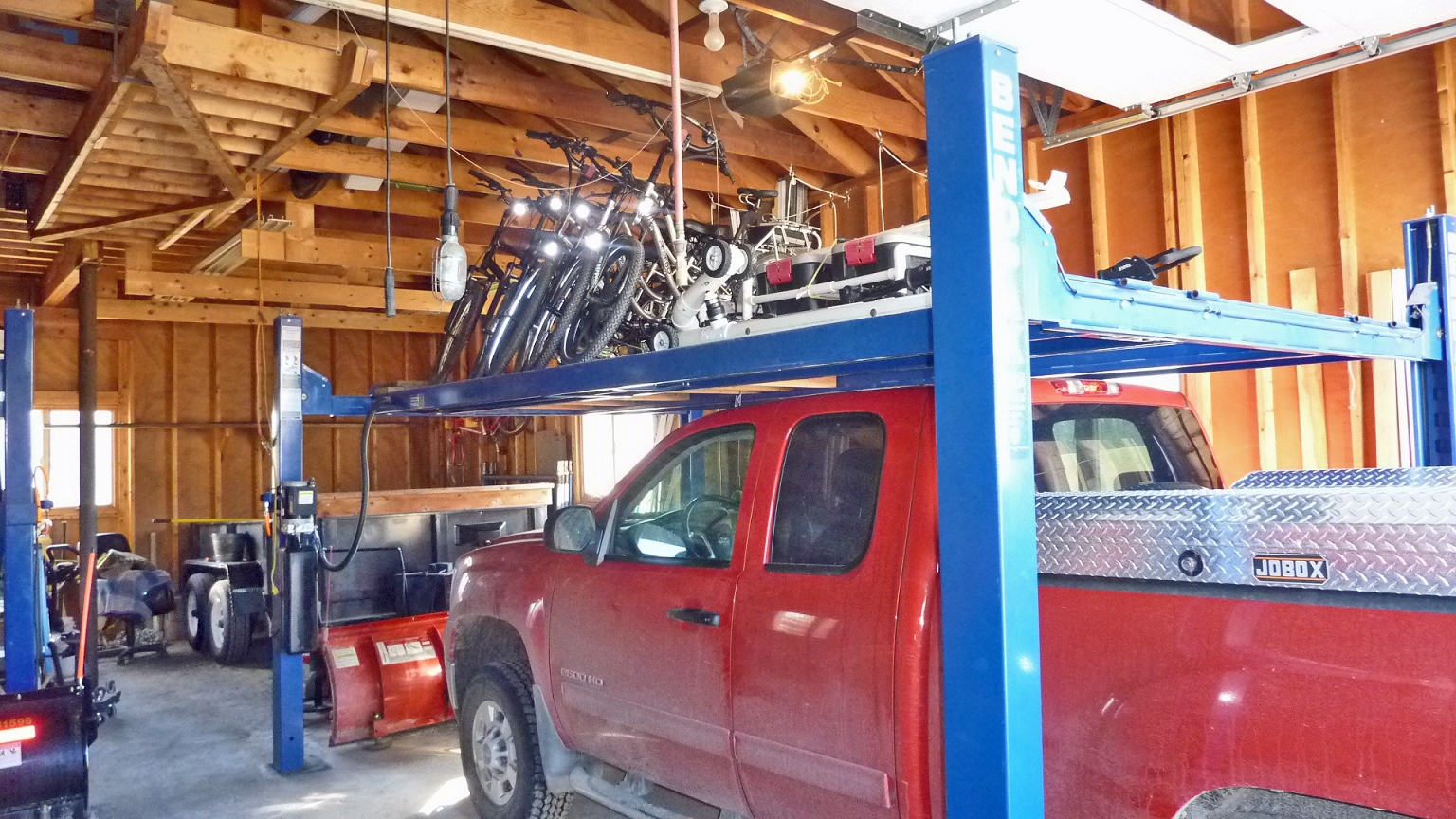

I was not permitted to install one when I built my garage. I chose a 4 post Bendpak lift instead and don't regret the choice.

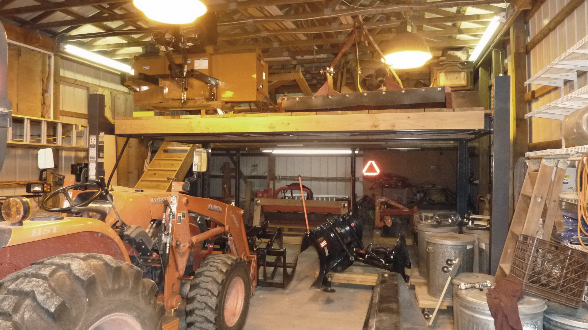

There are no issues with rear heavy tractors and they are great for storage when not being used.
So much so that I installed one in another building just for that purpose.

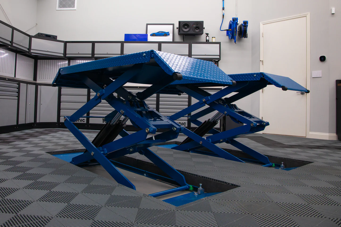

This is pretty cool. Prevent the 'falling in' and having to climb stairs in and out.
If that was at my employer, we'd have to fill out a permit required confined space entry form every time we used it, test it for gas/co, and have two people stand by, one a supervisor, and the other a rescuer. We'd need to wear a harness, and have a cable extraction system.
I'm pretty sure an insurance company would be pretty persnickety in a home setting.

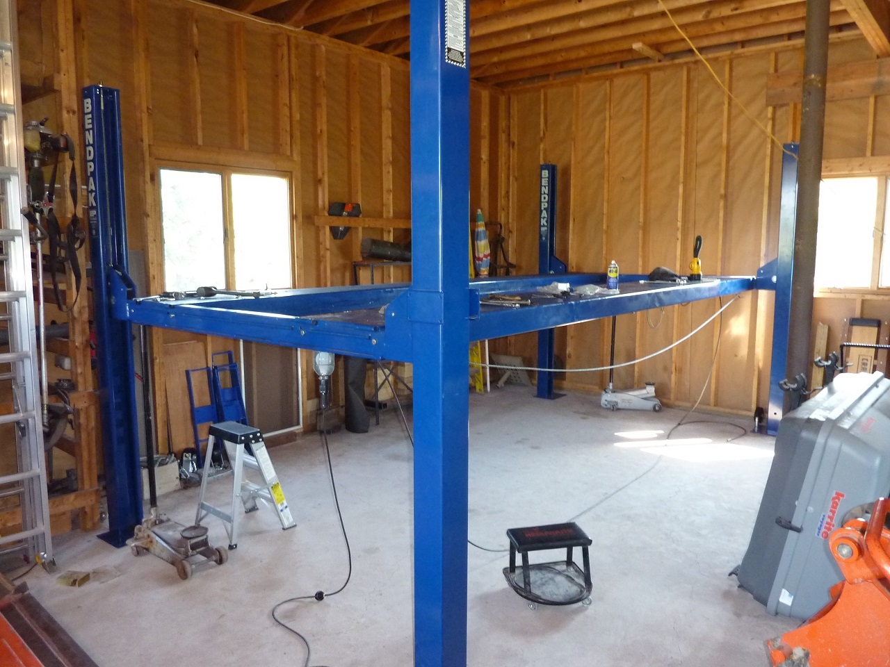

I'll second the recommendation for a 4 post lift. I have a Bendpak, 9K# 4 post, extra tall, extra long. Great for servicing cars, trucks, UTVs, mowers and the tractor. 10+ years with no regrets. I can park a full size suv or truck under it, with another vehicle on top. It frees up a garage spot and I don't have to pay taxes on the extra stall....... I built the garage with extra tall side walls and 6" of concrete anticipating a future lift.
I've been toying with the idea of adding a 2 post lift, it would be handy for tire rotations and brake work.
