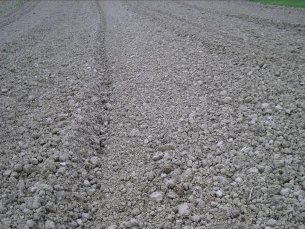

   / Leveling Implements side to side easy way?
The tiller is the main problem the grader blade i finaly got it to work good. The tiller is tilling a good 3-4" lower than the other side. I've tried turning the lift arm one extreme to the other with no results.

   / Leveling Implements side to side easy way? #7
</font><font color="blue" class="small">( The tiller is the main problem the grader blade i finaly got it to work good. The tiller is tilling a good 3-4" lower than the other side. I've tried turning the lift arm one extreme to the other with no results. )</font>
Measuring from a spot on the tractor, as opposed to the ground or tiller, are both lift arms at about the same height?

Is the gear box, or drive chain on the side that tilts lower? Could be the whole rig is out of balance.
The drive parts are on that side. It has the gearbox in the center then feeds power to the left side down into i think a 3 gear side box to the roller assembly.
I measured and the right side is about 1/2" or so lower than the other side. I'm going to add about 200# to the other side and see if that helps.
Does most tillers not till straight on a gently sloping area it'd say 2-3% slope?
