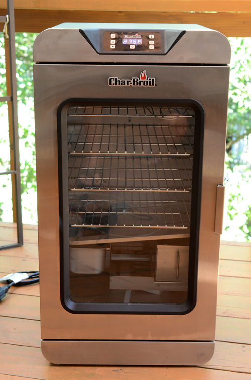

I'm a noob to smokers. Just bought a Charbroil Electrical Digital Smoker. Gonna try my first Pork Loin tomorrow. I bought some apple juice and pork rub to start out with. Any and all recommendations accepted and appreciated. This is what I bought.

It will probably become compulsive behavior; it has that effect on some of us. I have a Big Green Egg myself; make my own rubb and I cook some mean baby back ribs. I have done a few loins, but haven't mastered them yet; they come out too dry, but I tend to over cook loin. I have done some really good pulled pork, brisket, ABT's, chops, etc.
I think we should have a forum dedicated to cooking/BBQ/recipes; I think there is enough interest. Here's a link to an older thread that ought to keep you busy for awhile:

I'm thinking about wrapping the pork loin in bacon also. Worst case I can through the loin out and eat the bacon.

Nice setup. I have a super simple electric, When I got it, I planned on using it as a smoker for jerky. But the element was to hot. I was lucky enough to find a little 200 w element used in a Little Chief smoker. Now I can slow cook and make jerky.
Cooking is like in an oven but with slower cook times and added smoke. Great for ribs
Jerky, opens all new doors. We have smoked Deer, beef, Salmon and even catfish. supper lean beef = deer. Fat does weird things so no marbling is best. I use a fillet knife to cut the meat lengthwise, like lumber. Depending how you like your jerky, I cut mine to about 5/16 inch thick. One easy way to control the thickness is to place two rods on either side of the slab of meat. while pushing down on the meat, slice off the bottom 5/16 following the rods. I leave mine the shape of the chunk of meat so 3 in by 6 in is common slab. All the meats get a marinade of 1/4 cup of salt and 1/2 to 3/4 cup of sugar. mix with water and place meat in glass mixing bowl, add mix and top with water to cover. If it floats, use a small plate on top. You can sub the salt with soy if you want. The main purpose of the salt and sugar is to pull H2O and to preserve. Let rest over night or 8 hrs, stir once or twice. remove meat and pat dry with paper towels. Now the best part, spicing it to your liking. We use black pepper, garlic/onion powder, Not more salt!), red pper powder. Set smoker to 150 deg F, add the wood of choice to get some smoke. Keep in mind you can over do it on the smoke. I use hickory bark in 3 sessions about 4" by 6" total are each session. In about 8 hrs, best jerky you ever had. Careful not to dry it out too much. It always feels softer when warm, so I start "testing" at 6 hrs and put a pc in the frig to see what texture it is once cooled. I cut into strips with heavy kitchen shears. Fish is a bit different, less marinade soaking time and less smoking time. If not, it's fish jerky, yet still good. I leave the skin on the fish, smoke with skin down.

For fun, smoke some coarse sea salt to use in the rubs! I have some pecan-smoked salt, and absolutely love to use it in my rubs. After you have finished smoking something, just place a shallow pan with a 1/8" to 1/4" layer of salt in the smoker and let it smoke as long as you like.

I've abandoned mesquite for anything other than beef (it's pretty strong). I do a lot of woodworking with wild cherry lumber and find that the scraps/planer shavings make for a good smoke (kinda sweet though so I mix in hickory for balance). Apple works well also (but again I mix with hickory). You might not care for the pork loin though...it is a very dense meat that will not take a lot of smoke so don't get discouraged. I think I read somewhere that meat will stop taking smoke at about 135F internal temp. At that point I bring it in and finish in the oven (foil wrapped which might include your apple juice) if needed. I think you'll come to love the smoking experience...just remember "low and slow" in order to get that cherished smoke ring. Another thing to remember is that desired preference of doneness will never exceed your heat temperature even if you leave it on there for a year! And the other posts about salt...I think the smoking process itself leads to a rather salty flavor so I go easy on it but that's just me.

Fish is easy to over-do (less dense). I doubt you'll have a problem with pork loin. Your smoke ring might only extend 1/2" into the meat, probably less and a pork loin is pretty thick. Never tried pork tenderloins but I bet they would be the perfect meat for smoke.

Everything you'll ever need to know about smoking meat: BBQ Ribs Recipes, Barbecue Recipes, Grilling Techniques, Baby Back Ribs, Barbeque Spareribs, Outdoor Cooking, Rating Grills and Smokers This is truly the most scientific and well researched site I've found for smoking meat. Watch out though, it is almost as big a time sink as TBN. Amazing Ribs really does testing and has honest to goodness physicists as well as cooks and foodies giving advice. They also have great equipment reviews. You already have an electric smoker so you're set on that but you definitely need a digital thermometer too.
The good news is that it is pretty hard to screw up smoked pork. One of my favorite recipes is Kalua Pork (Hawaiian style) and the recipe for that is simple: Salt, Meat, Heat, Eat!
