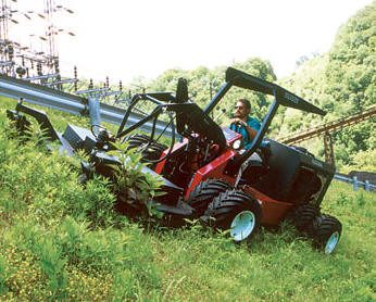

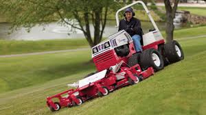

You may want to look into a Ventrac. They are made for hills and have some other cool tools on them. Ventrac.com
   / lawn tractor or atv mower for mixed, rough terrain #16
And the Ventrac Forum here on TBN: http://www.tractorbynet.com/forums/ventrac/
And the more popular Power Trac Forum: http://www.tractorbynet.com/forums/power-trac/
Also check the "Similar Threads" at the bottom of this page.
