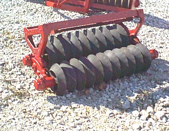

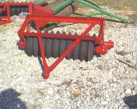

   / Lawn roller... #8
Something like this works well also. Ken Sweet
   / Lawn roller... #9
That is quite a roller.
As long as you can control it when on a slight hill, and not get caught with it pushing/jack-knifing you.
I've a 1k lb roller that is about 14" diameter 36" long, and I can roll mole runs and in early spring, smooth the lawn. I'm not needing anything heavier or bigger in diameter. Need to consider what will happen when going over rocks that may dent or puncture the steel drum. Mine is concrete filled, and has been no problem.
