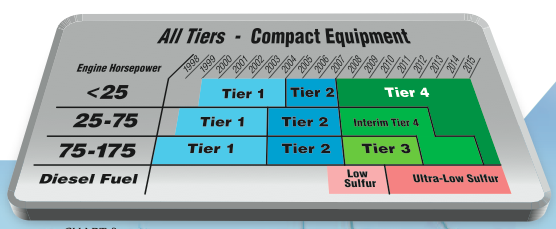

The Tiers were more about deadlines -- 2008 was Tier III, 2011 was Tier IV Interim, and 2015 was Tier IV Final. The manufacturers got to the different tier deadlines on various schedules, and could exempt certain models all together via credits. There were also horsepower ranges, and the deadlines tended to be set by the higher HP ranges. Some of that is summarized in the chart I attached, and another one is available here:EPA Diesel Emissions Tier Schedule | ForConstructionPros.com
The pace/process/etc wasn't cut and dry -- the only hard dates were the deadlines themselves. For instance, most of the manufactures started rolling out Tier IV Final stuff in 2014, ahead of that deadline. Many got to Tier IV interim before the 2011 deadline for that one. The only real thing you can say (which I alluded to) is that you'd have to roll back to at least 2011 to see Tier III (in higher HP range). There wasn't a Tier III for the lower HP ranges -- they transitioned right into Tier IV Interim.
