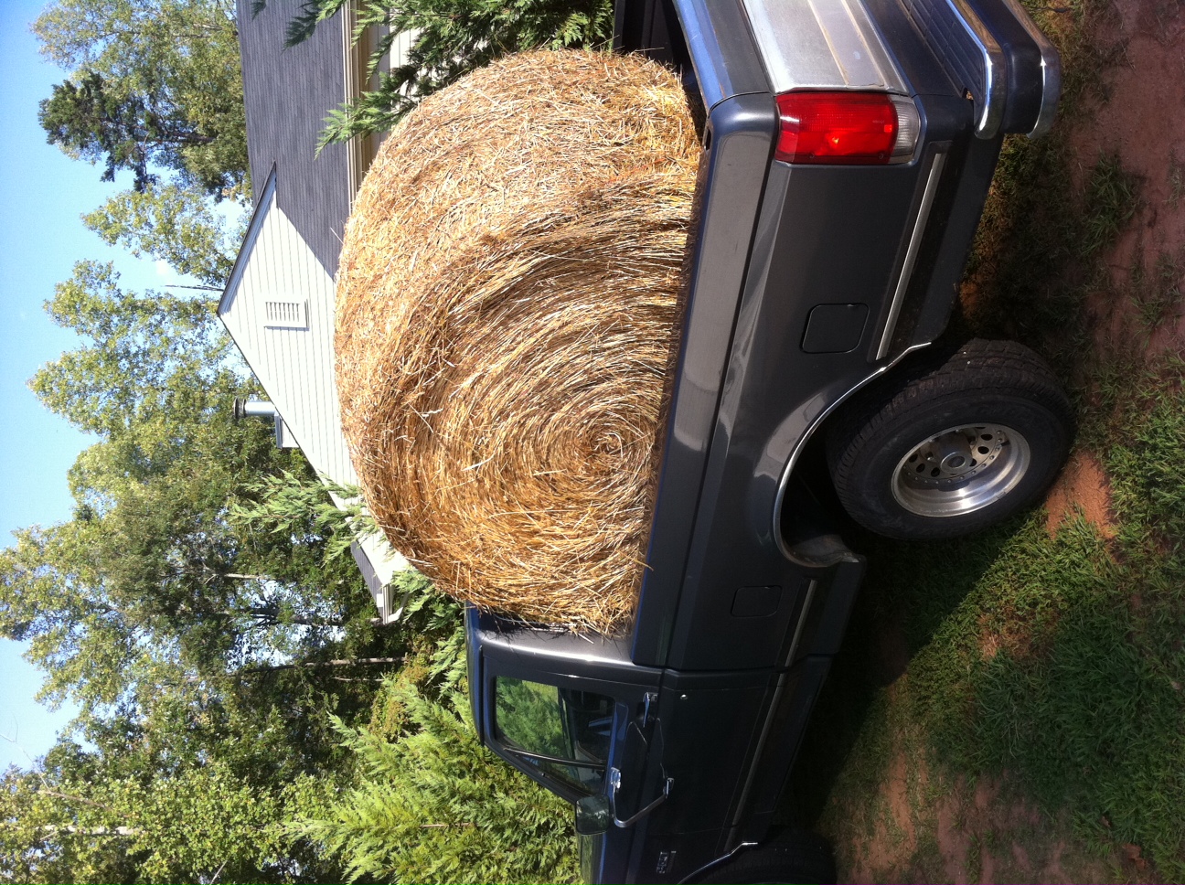

Ok... Two words. "Prove it!"
I emailed the dealer and will be visiting early tomorrow morning when the open. I'm going to push the bale off into his yard. Let's see how this works out!
   / LA524 Specs ... Is this bale too heavy? #19
Like I said, your tractor should be able to lift the bales just fine as my L3400 does. That does not mean that you shouldn't be thinking of a larger tractor anyway to do it as safely as possible and with as little wear to your front seals as possible.
