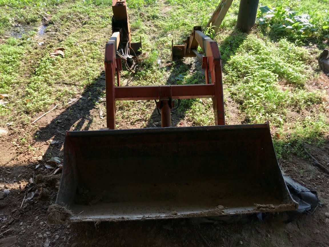

I have the option to buy a LA211 loader for very cheap because the BX2200 tractor burned to the ground and he replaced it with a larger tractor.
I know that fires can get hot enough to damage the metal - is this easy to test?
Here are some pictures. I know it will need new lines at a minimum. Any info is greatly appreciated!

Pics.

Doesn't think that is a problem, it must be really hot before steel is destroyed.
   / LA211 Loader from tractor that burned down. Safe to use? (Pics inside) #4
I would expect that some rubber parts in the cylinders might be damaged. Cylinders can be rebuilt for few bucks in parts.
   / LA211 Loader from tractor that burned down. Safe to use? (Pics inside) #5

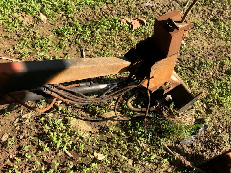

Really? That isn't just blackened paint on the boom and brackets, that's some serious heat damage.
I wouldn't bet my life on them. Not worth more than scrap value. There is a reason why OSHA makes you scrap forklift forks if somebody flame cuts a hole at the end for lifting chains. You've got an unknown heat treatment at a high stress area.
It's one thing to use something like that yourself trying for a Darwin award. What do you say if some kid in the future hops on and gets injured or killed by it through some unkown event?
That loader boom and brackets should be flame cut into pieces. Right now it's as safe as the shyster who welds two totalled cars together and sells it as new.
   / LA211 Loader from tractor that burned down. Safe to use? (Pics inside) #6
Some folks drive rebuilt wrecked cars, some tractors................ For me, I wouldn't want to mess with this loader.
If you assume the metal has NOT been weakened (and remember, it only lifts 400-500 pounds, so it's not a huge amount). It's higher loads probably would come from slamming the bucket into a pile of rocks or such. I doubt that the steel in the loader is heat treated.
In addition to replacing all the lines and hoses, and maybe the valve, and all the cyclinder seals, you'd need to flush the loader lines very well to keep any **** out of your tractor. I don't know if the cylinder walls might have deformed some in the heat............
All of the pins in the loader would need to be removed, cleaned, and regreased.
If your time is worth anything, it might be better to buy a new loader and be able to use it an hour after it's arrival. Just my two cents.

All that steel has been red and hot in some point of it's production, to burn of paint doesn't require much hear, is it warped or melted? Some loaders use tension in the steel to stiffen them up but this is a small one so it's probably just welded to gether with no such design.
I haven't tried to mount it up to the tractor yet. I know it damaged the hydraulic hoses, but even the thin steel inside of those didnt melt.
I don't want to have something dangerous on the tractor, but at the same time I hate to waste/scrap something that would be useful to me or someone else.
How hot does the steel have to get to permanently alter the strength of it?
   / LA211 Loader from tractor that burned down. Safe to use? (Pics inside) #9
Depends on the type of steel. And that I don't know.
Most likely, the loader frame is just a mild steel with no heat treatment. But I'm not testifying to that. the fluid is likely caramelized and the hoses, steel lines and seals will all need to be replaced. In fact, I would replace all fluid parts (hoses, cylinders, fittings, steel lines).
