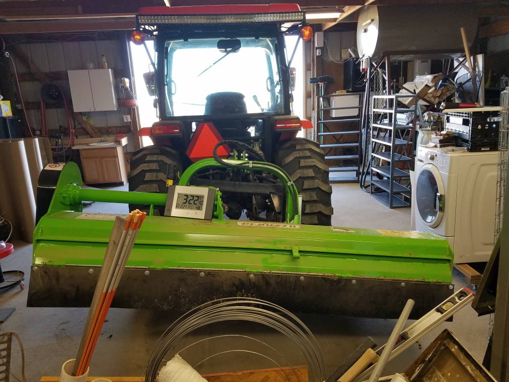

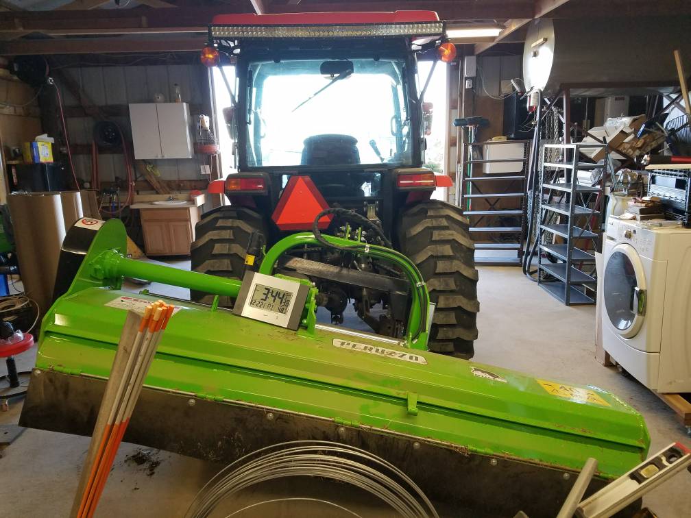

The precision & leakdown on the rear valves is worse than the 3rd function protection. They have put 5ish valves on mine and only 1 of the 3 doesnt leakdown horribly. They are picking it up for the next try at decent valves.

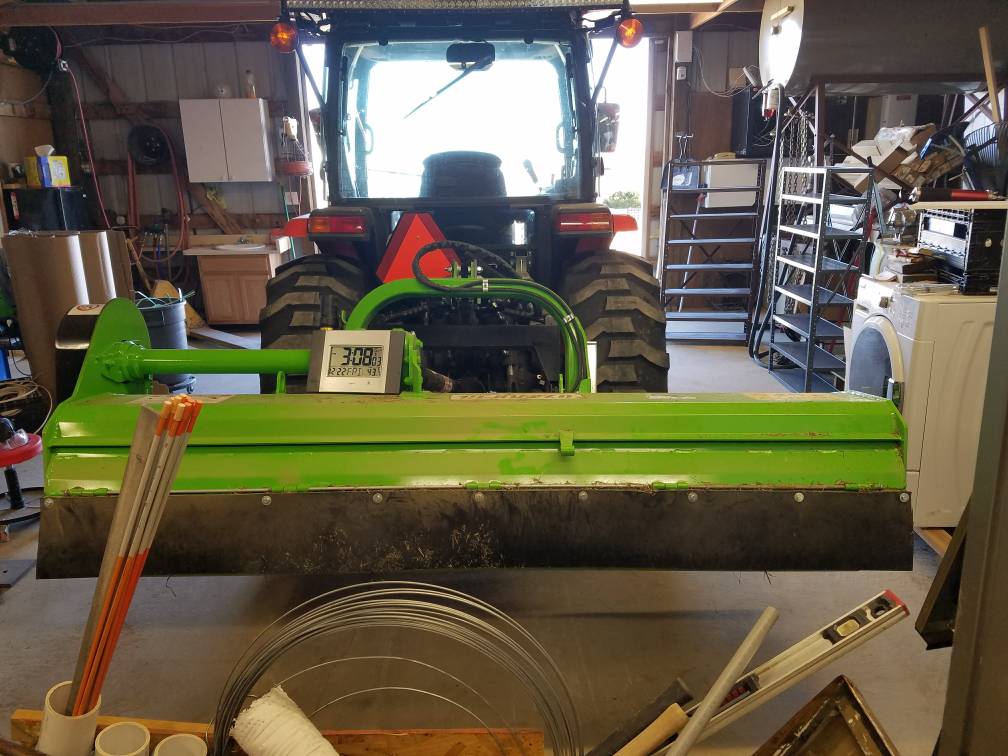

I haul the machine for my side gigs so it's not that big a deal as I have the trailer & truck. The dealer said they'd pick it up on their dime after I got pretty grumpy about not fixing the crap rear spools the last time I hauled it in. I've been busy enough & can deal with the tilt cylinder leaking down I havent called them up to come pick it up.
   / L6060 3rd Function Hose Guard #38
I haven't tried the rear remotes yet. Guess I better find something to use them with, to see if I have the same issues. What are you guys using that shows the valve is leaking down? I don't have a hydraulic top link yet and not sure I can find one that will work. The manual top link on my tractor is extended almost all the way out for the implements I use and the local hydraulic store only carries 3 hyd top links and the longest would also be almost/or completely extended.
About 45 minutes to go from level to touching the ground. Half stroke on a 9"? tilt cylinder. It's done this with multiple cylinders & stays with the spool when I swap top & tilt hoses. The top cylinder (valve) use to do it, but we finally got a non-crap one there. I stuck a clock on there to show how fast it leaks down. Its not just the big flail either, my box blade does the same. **** just the 40lbs? Quick Hitch will pull it crooked over night.
The issue doesnt affect side shift on the flail & only kind of affects the 3pt trencher. I doubt it would affect hydraulic angle on a back blade. But any cylinder that is under constant pressure due to gravity or whatever gets pretty affected by those crap valves. It blows my mind Kubota puts those on their premium machines. The loader & 3pt on my Grand & old economy L3200 stayed put for weeks if you left them up, so they can make proper precision valves. 20171222_150735.jpg20171222_152211.jpg20171222_154409.jpg

Running or not it leaks down all the same. Unsuprisingly it leaks down faster when hot. I think it may leak down faster when bouncing down the road than sitting still, but not massively.
The several TnT sets my dealer got were total crap. 2 or 3 cat 1, 1 cat 2. None fit close to well, most oozed or sprayed hydraulic fluid everywhere. FitRite wasnt cheap or fast, but worth the cost & the wait. Fit perfectly. My 2nd set from FitRite, first set went off with the old tractor. I'll just go with FitRite & wait if I ever need another set in the future.
