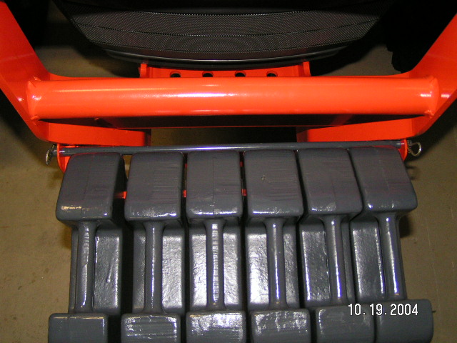

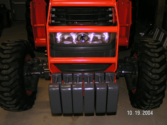

Looks like a pretty cool tire; sort of like splitting the difference between R1's and R4's. I really wavered back and forth about which tire to get, the R1's or R4's. Since I do quite a bit of rough cut mowing with a rotary mower I ended up going with the R4's because it seems that everyone agrees that the R4's have a tougher carcass against punctures. So far I've been pleasantly surprised at the traction I actually get with the R4's. I've always had R1's before and was expecting to lose quite a bit with the R4's, but I didn't.
I don't know what weight bracket and weights they sell now for the L5030's, but when I bought mine I didn't like their weight bracket setup. Especially since I constantly take my FEL on and off I didn't like the fact that the weight bracket I was shown would have had to have been removed each time to put my FEL back on. I ended up making my own front weight bracket and using some JD weights I already had. Here is the front weight bracket and weights I adapted to use on the 5030. I think it cost me about $12 and took me a couple of hours to complete. Good luck!

Dargo... lordy, what shiney stuff you have!!! :eek:Nice job:D
I agree totally about watching how weights attach.... I had to come up with a special bracket also so I could have weights attached and use FEL as well... requires extreme planning and measuring....:eek:
