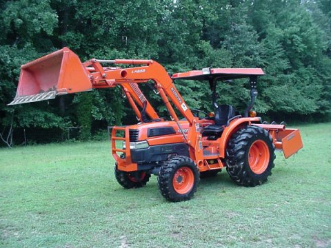

I was trying to make the same decision GST or HST last spring. What I did was think about some of the jobs I was going to use the tractor for. One job cleaning up a bank behind the house using the fel. With the GST it would be operate loader, throttle, clutch, brake, steer, shuttle shift most likely back all the way down the bank and start over. With the HST just steer and operate the fel I could move 1inch or 1 foot in either direction on the bank using my foot on the treadle pedal the control you have of the tractor in AMAZING.
L 4330 HST
