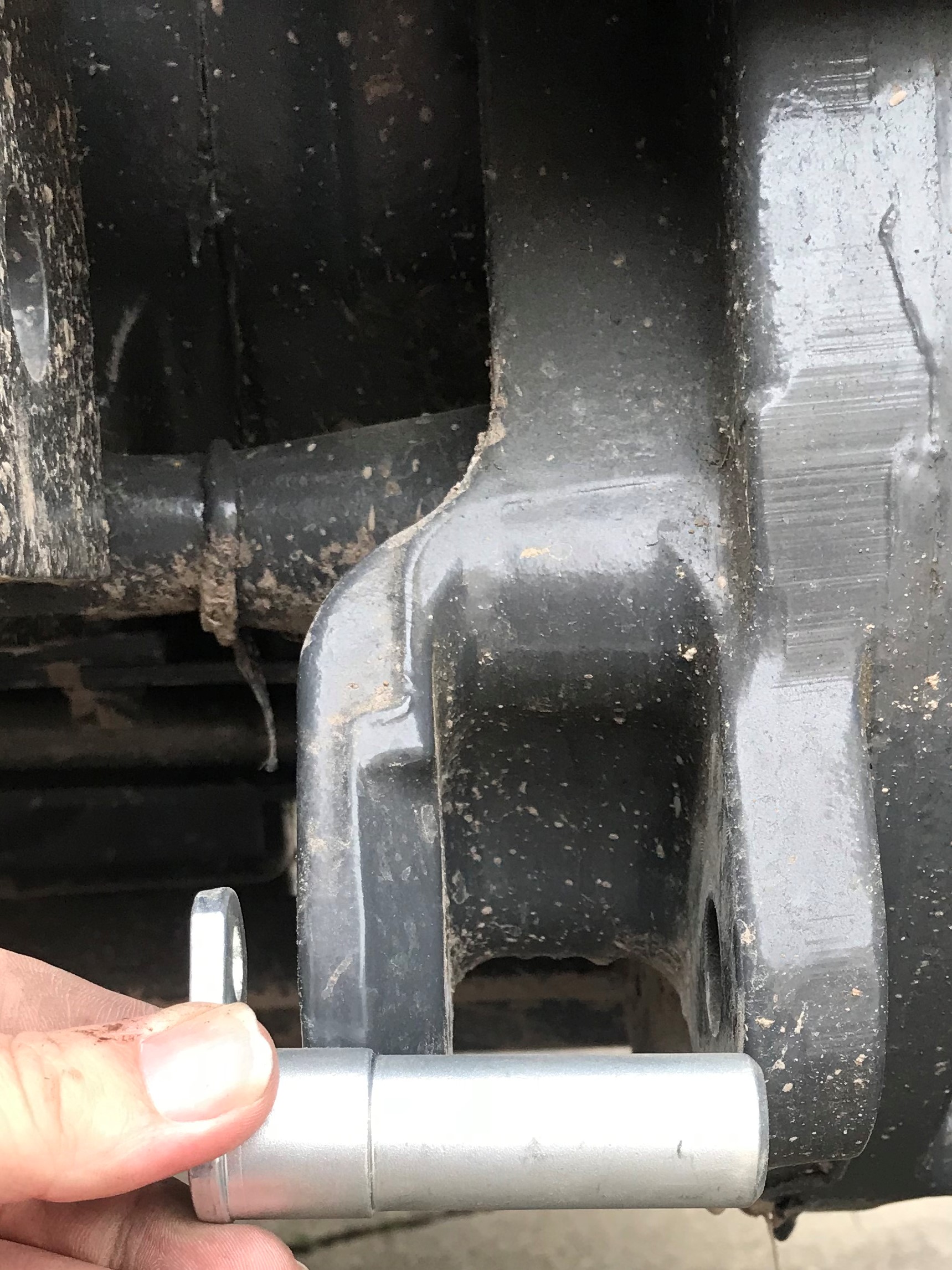

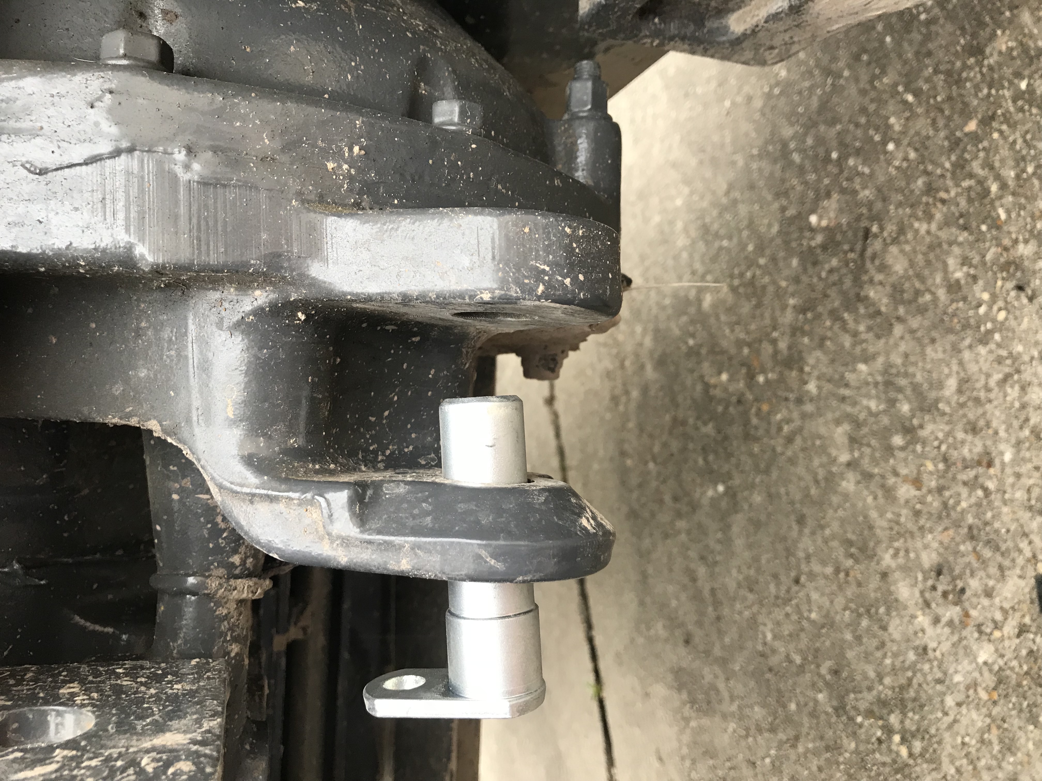

I recently purchased the Kubota Three Point Hitch kit (L3961) for my L47 TLB. When I went to install the three-point hitch, I discovered that the lower link pins had a collar on the neck that increases the diameter on the pin. This is preventing the pin from being fully inserted into the tractor mounts. When I asked my Kubota dealer about this, they stated that these are the correct pins and that we should machine the collar off. This doesn稚 make sense to me given that this is the Kubota kit.
A few questions:
1) Has anyone experience this same issue? If so, what did you do?
2) Did they sell me the wrong kit?
3) Will machining the collar down impact the integrity of the pin and the whole three point hitch?
4) Will machining the collar down void the warranty on the tractor or the attachments?
5) Am I missing or doing something wrong on the install?
To help explain this, here are some photos:

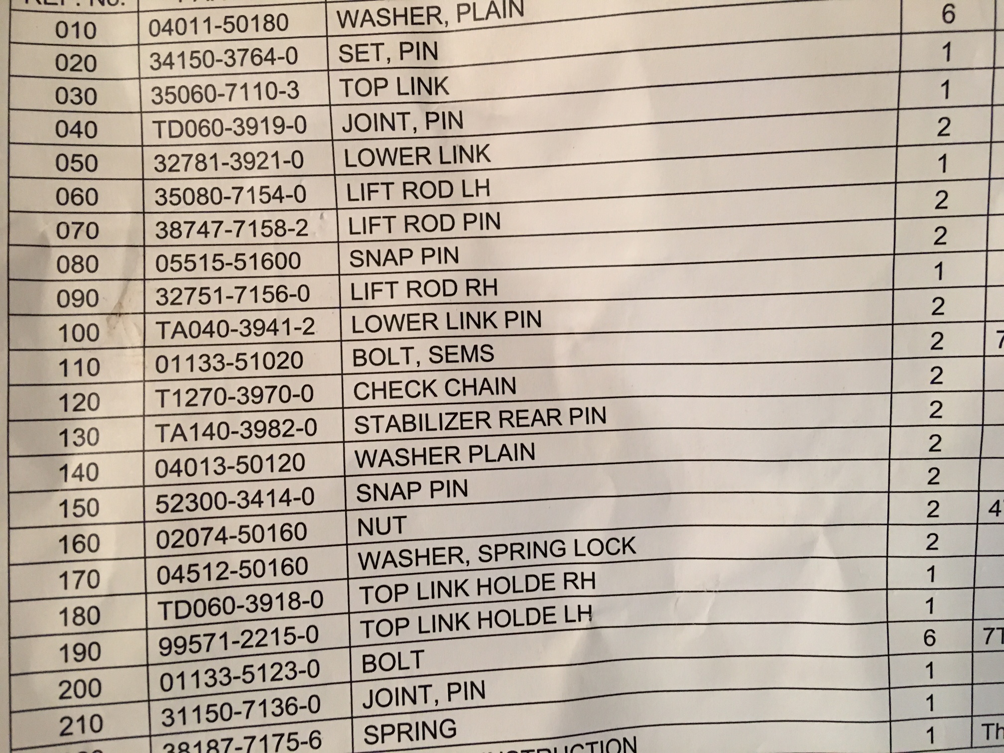

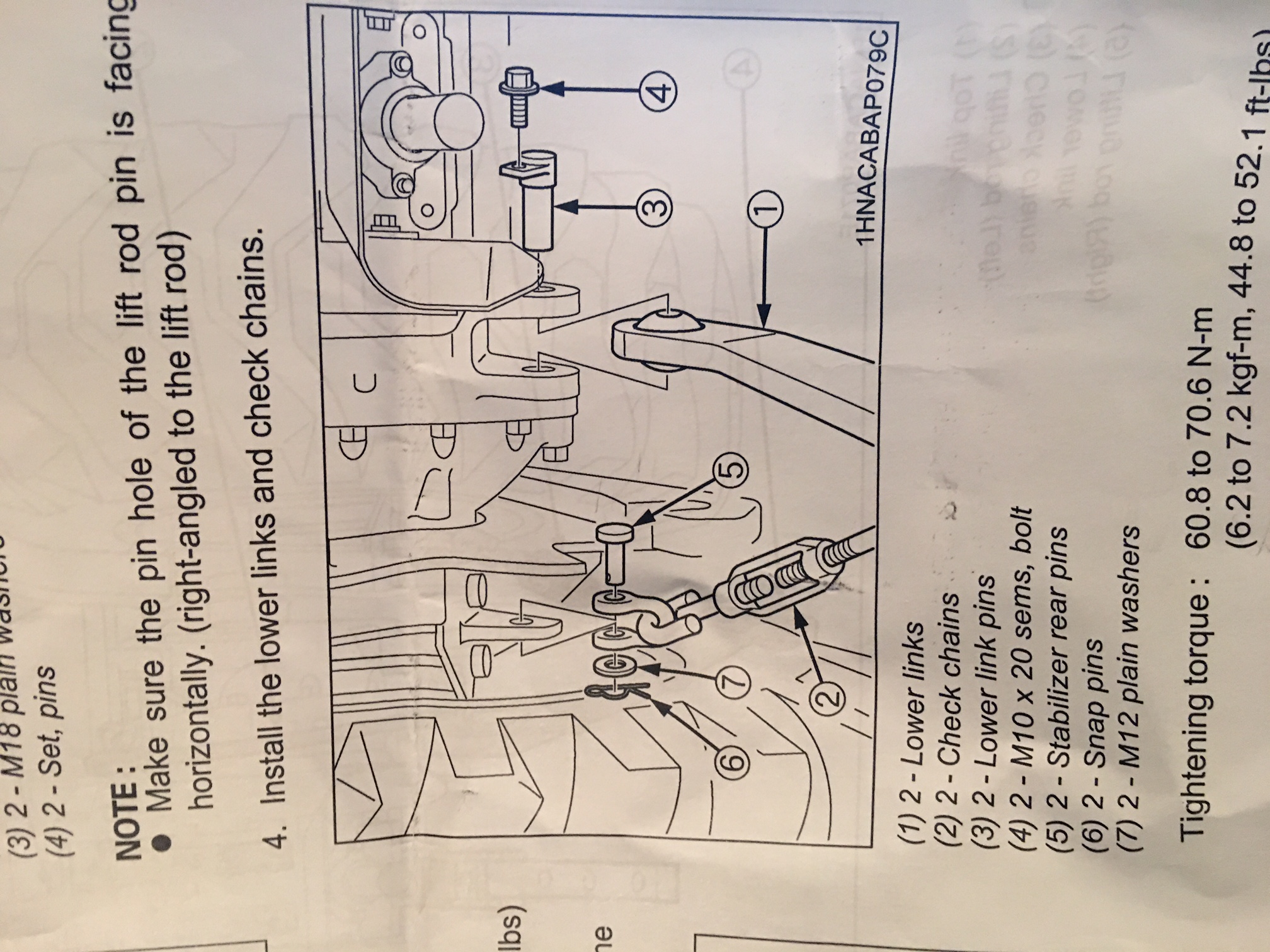

Instructions:
Part #3 is the Pin that does not fit
The Lower Link Pin is part TA040-3941-2
This is a picture of the Pin.

Looking at the picture it appears the outer hole is also stepped for the pin, I would make sure there isn't any paint/rust/burs holding the pin up. Maybe take some emry cloth and clean the inside of the hole up.
/ L47 TLB Three Point Installation Questions #6
My M59 pins don't have a step in them maybe your machine uses a different pin than the one provided. Did they order the kit based on your tractor serial number or model year only? There might be a newer/older kit number for your machine.
Did you try measuring the hole diameters on each side with a caliper? If all four holes are the same size that will confirm things for you.

I appreciate everyone's help. After several attempts at different approaches, two sets of pins and an additional $200, the verdict came down to the holes where to small.
Thanks again for all the help. Now on to mowing.

Typically stepped pins like that are used to aid in install/removal when a tighter fit is desired. Prevents the pin from corroding in place as easily (imagine removing a pin that's full length is the same with corrosion on it as opposed to to 2 small sections).
The other reason, which I doubt in this case, is to allow 2 different size pins to be used in one application like a cat1/cat2 implement.

Scotty - Yep, I can state the obvious. Sorry for not being specific. The holes on the tractor needed to be machined out to specs.
TMGT and Scotty, I have to admit that I am extremely frustrated with my local dealer. They sold me the 3pt hitch, the tractor is still under warranty; yet, they refused to do anything unless I paid them to do the installation of the 3 pt. hitch. Very disappointing in the customer service department.
