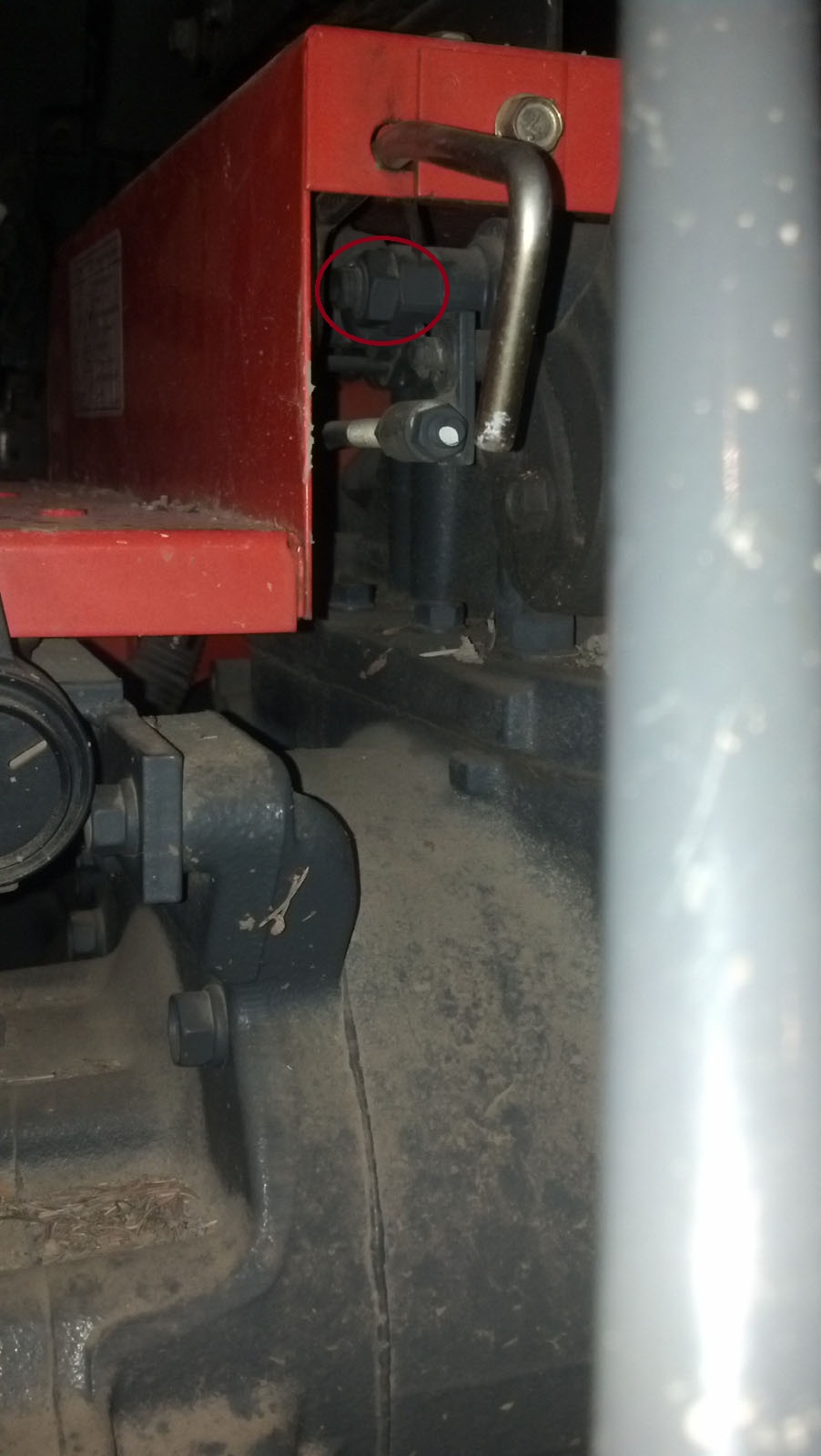

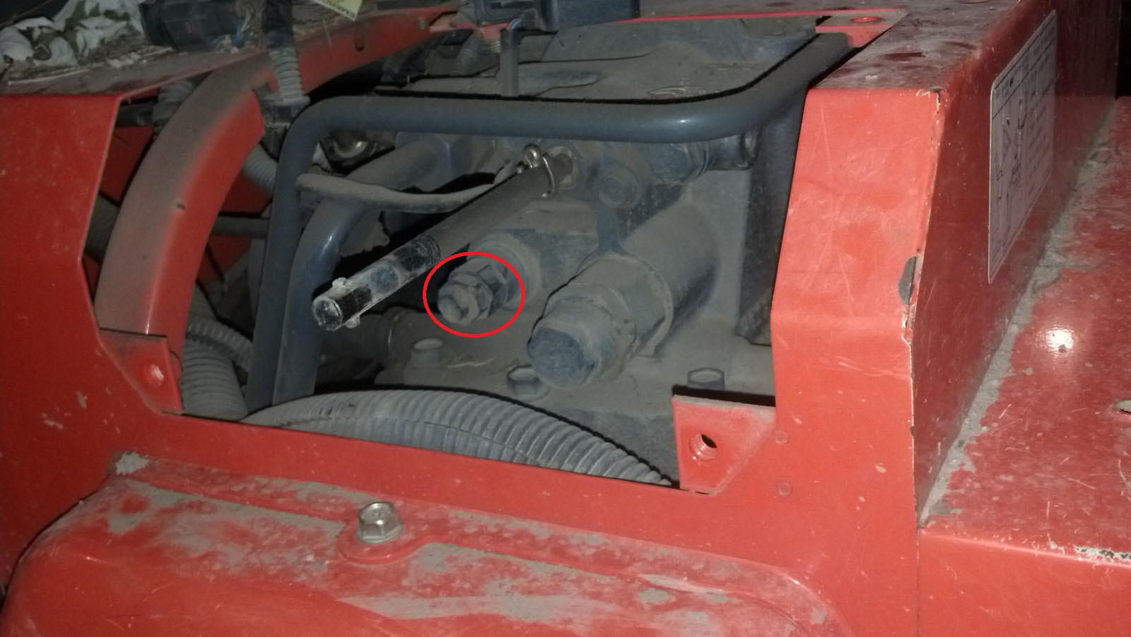

On the L39, the main regulator is under the seat. There is a little access panel held on by three bolts. The knob pulls off the 3 point drop rate adjustment to allow the panel to be removed. In the picture below I circled the main relief in red. There is a jam nut holding the adjustment screw.
There is a separate relief valve for the swing pump. You can see from the back.

Stonehauler:
Thank you for the photo of the relief adjustment for the swing pump. I never checked my swing pressure.
FYI, My L39 main relief was set way low, I could not pick up the back of a shortbead 4X 2 Reg cab 1998 V6 F-150 Pick-up. Properly adjusted the L39 can pick up the rear of a Crew cab HD 8' bed Silcerado, no problem.
Also you need to set the Loader relief valves once the main pump relief pressure is set.

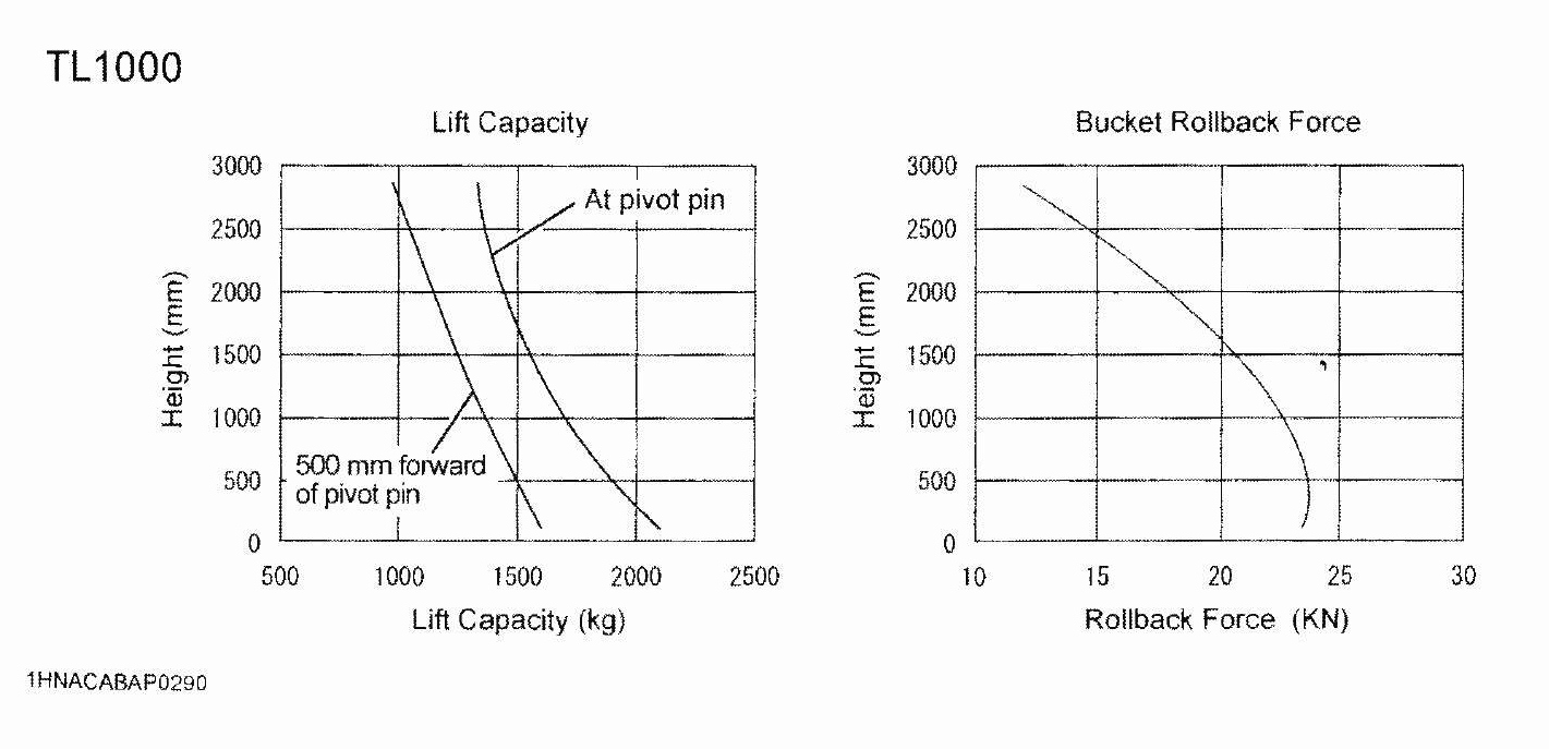

At ground level you can pick up a lot more than 2200 lbs with the L39/L45. See The TL1000 Loader Manual Specs attached.
As I read the graph for the rollback force, it comes out to 5,200 lbs at the pins at ground level. The L45 has more with slightly larger curl cylinders. The curl in the L39 is reatively weak compared to it's lift capacity.
