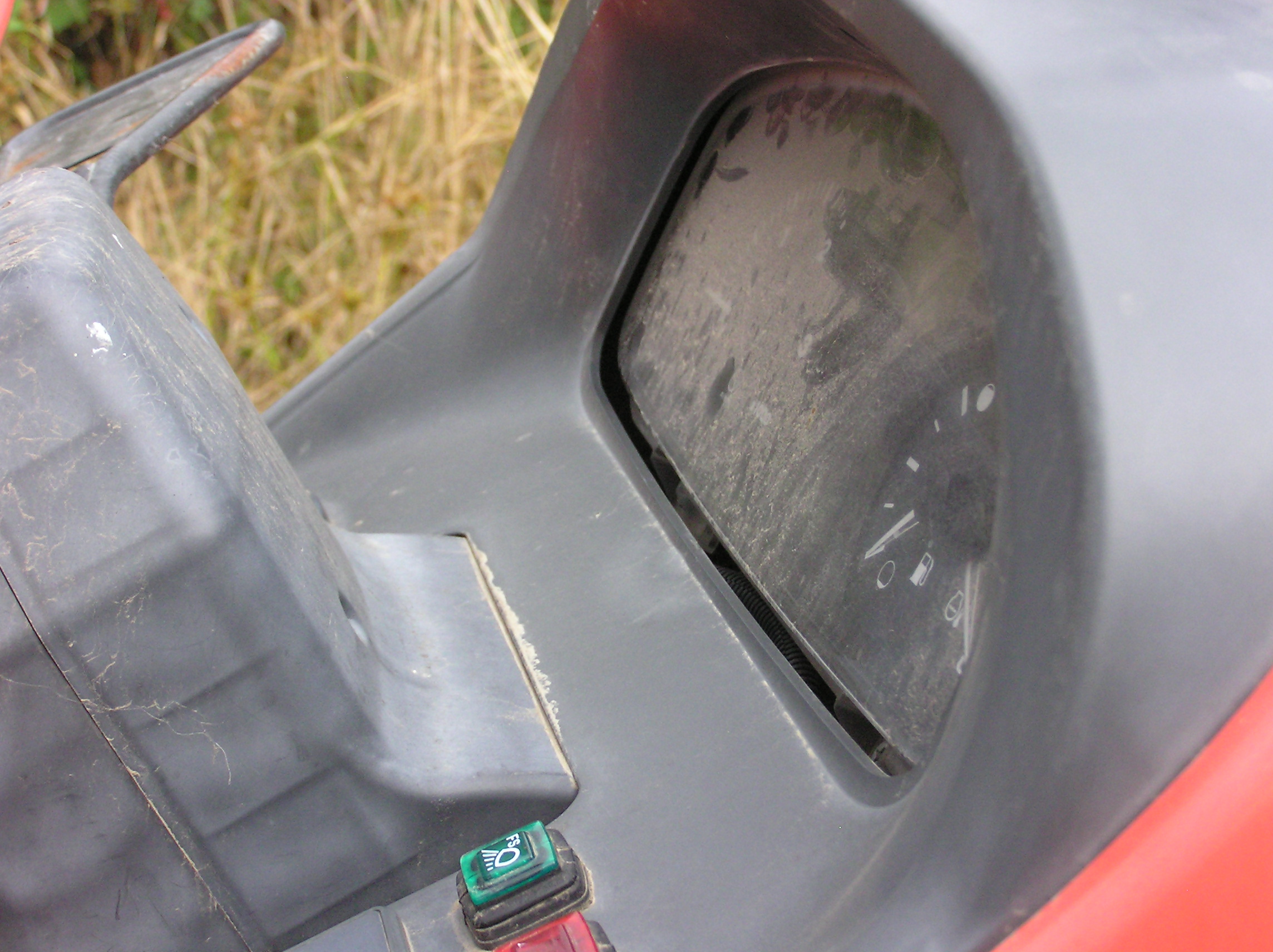

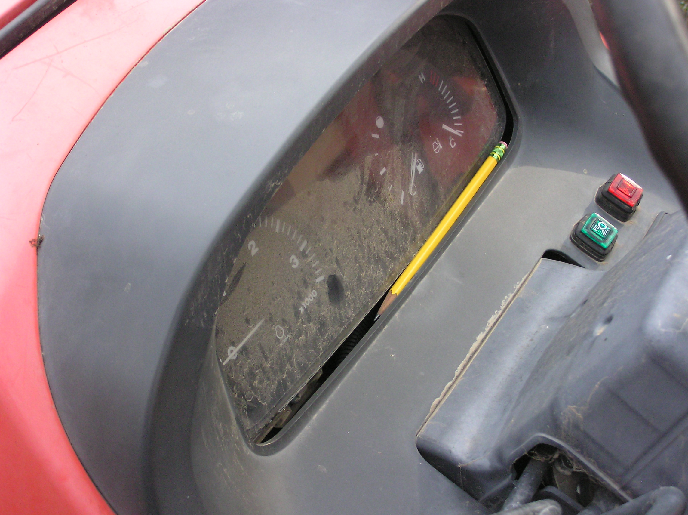

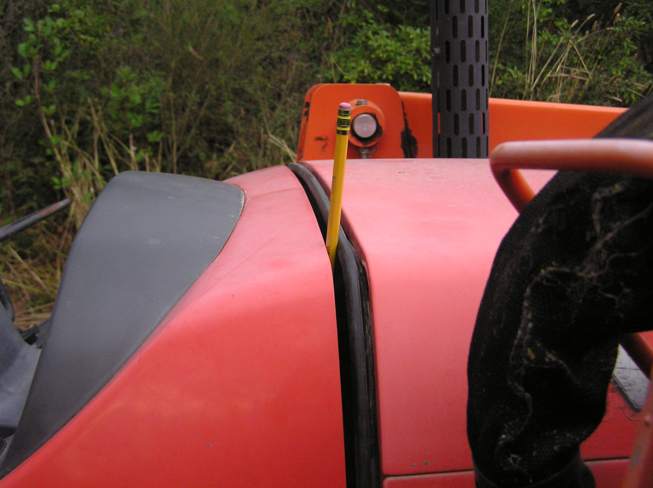

I think i have to remove the entire exterior cover as my instrument panel is not really protected from rain or dust. iAppears the exterior cover is not in the correct position (broken hold downs)? or the instrument panel is not in the proper position. Something just ain't right.
I hate to do it without guidance. I looked through my workshop manual and never found anything. Seems their should be a section on removal of this cover, I will have to go through the manual again on a rainy day page by page (3 inches of pages).
Anyone have any suggestions? I would guess I should start a new Thread regarding this issue any suggestions as to where ? Thanks

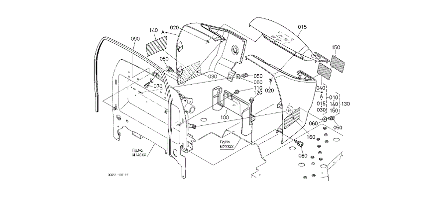

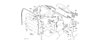

M15502 HOOD(BONNET) REAR ## NOTE ORDER BY REFNo015 and FigNoB10500 REFNo030 NEW PARTS.pngP9110061.JPGP9110061.JPGP9110068.JPGP9110071.JPG
   / L4150 Hydraulic shuttle? #10
On the L4150 the shuttle valve is inside under the instrument panel. On a M5140 the valve is on the trans. The M5140's rear bonnet is quite different than on a L4150. A new thread with "M5140 Bonnet" in the title might get more response. Take care, Dick B
