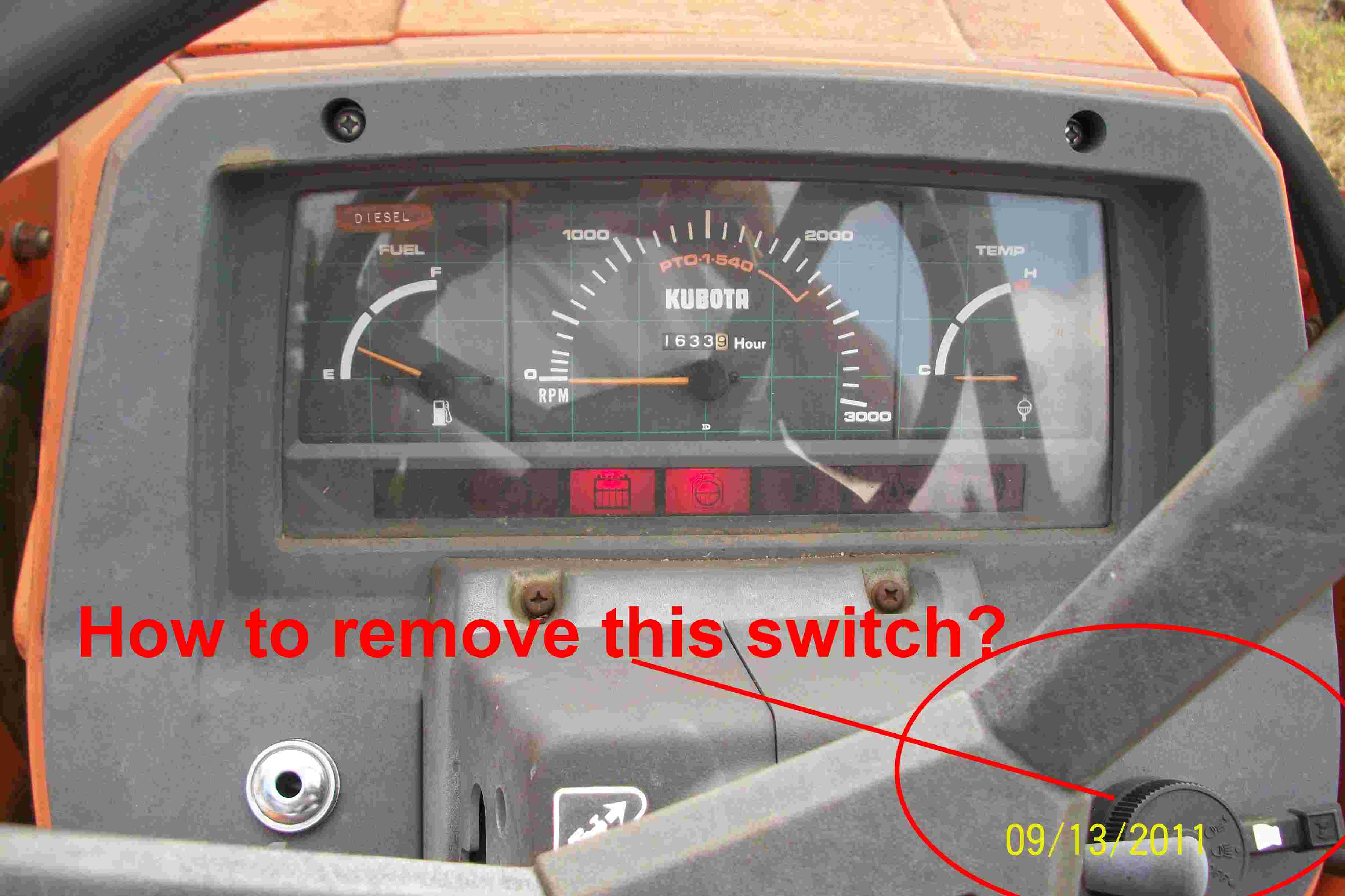

I have a L4150 kubota with a very loose headlamp/hazard switch. How is this combination switch removed? The knobs seem too tight to just pull off. Does anyone know if there is a release mechanism to get this switch out of the panel?

On my L4150 and L5450 the knob (with short lever) just pulls straight up and off. Under the knob there's a retaining nut holding the switch in the dash panel. If you need to lift the dash panel, take the two halves of the tilt steering cover off first.
   / L4150 Headlamp/Hazard Switch Loose
Thanks for that feedback. As you can probably guess, I was just not using enough force when pulling knobs off. Tightened the nut under the knobs and loose switch fixed.

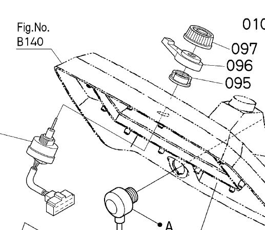

The L4950 parts drawings and workshop manual didn't include a breakdown of this switch. I stumbled across a parts drawing for a M4900 which uses the same combination switch and includes a more complete breakdown of this switch.
I have included the M4900 drawing for future reference.
