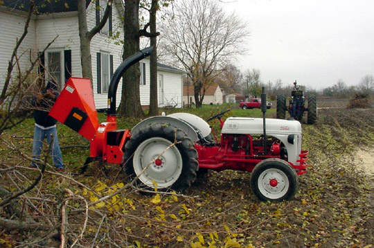

   / L3540 questions #4
Can I run a 3pt wood chipper 6" without worry for lack of PTO HP..Or does it have sufficient amount to do the job?
As moored4 suggested, check the chipper manufacturers input requirements againt the tractor output capability. You should be fine, here is my 1950 28hp Ford 8N running a 5" chipper. Philip.

Go to chipper website (example, Bearcat), look up model you want, and get input hp requirements. Go to Kubota website, look up tractor model you want, and get pto hp output. Is the tractor hp greater than the chipper hp? You need to do this yourself, what if someone gives you bad information??? Philip.

The 3540hst has 28pto hp i believe. Phillips got it right but ill take a stab and say it may be a bit underpowered.
   / L3540 questions #9
My 8N has 28hp flywheel, but only 22hp pto, and I run a 5" chipper with no problem. Personally, I think he will be okay, but he needs to dig into the numbers for himself to be sure and comforable with his discision. Philip.
