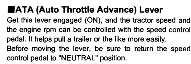

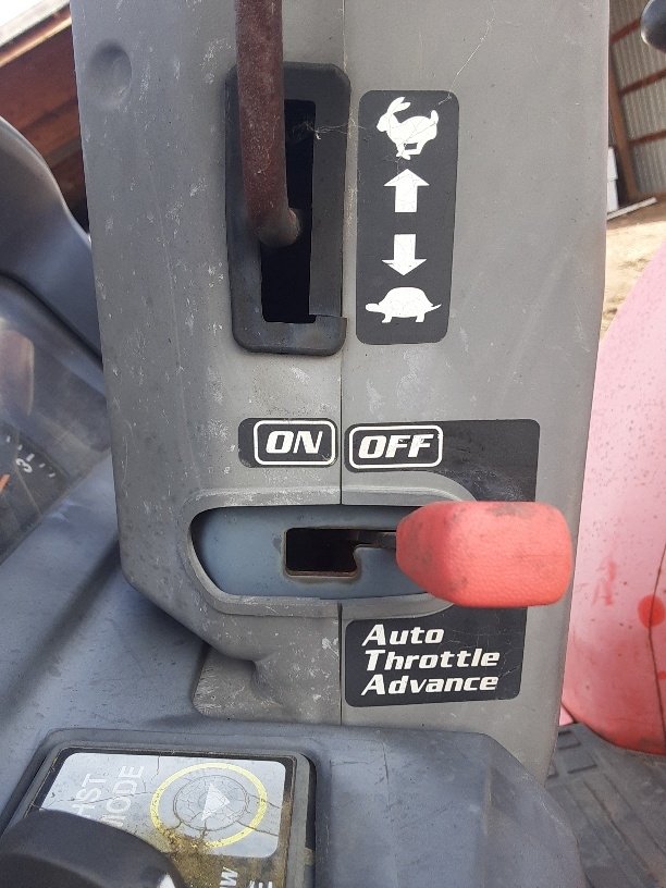

Now to the reason for the post... After running for a minute at various engine speed, it seems to throttle itself down, down, down, and then die and refuse to restart. Set the hand-throttle back to idle and it starts up.

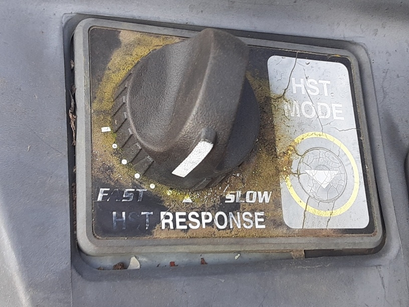

This tractor looks to have "Auto Throttle Advance". I have no idea what that does. There looks to be some sort of electrical thing, rotating position sensor or actuator on the injection pump shaft that the throttle cable rotates to speed-up or slow-down the throttle. Is this "Auto Throttle Advance" feature sensing the transmission in neutral, heel-toe-hst control at neutral, and then some gadget decides I don't want the engine running-fast and slows it down and stops it? What does this "Response" turn-button do?

The HST Response dial adjusts how smoothly the transmission reacts to pressing or releasing the HST pedal.
The Throttle Advance links the HST pedal to the throttle, so that rpm's increase as you press the HST pedal.

After reading the manuals, have the controls figured out, specifically how to disable the "Auto Throttle Advance". Tractor spent the day baling, very capably driving a New Holland 315 square-baler.
