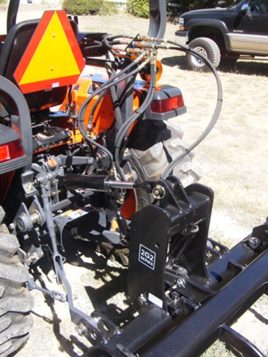

Thanks for the education. If that was an automatic feature and you could controlled TnT from the seat, I would definitely see an advantage to that! Unfortunately, TnT has to be done manually on the L35. Kind of a pain to adjust for using my back blade but not so much for my box scraper (once it is set it usually doesn't need it again).

I'll try to attach a pic.
