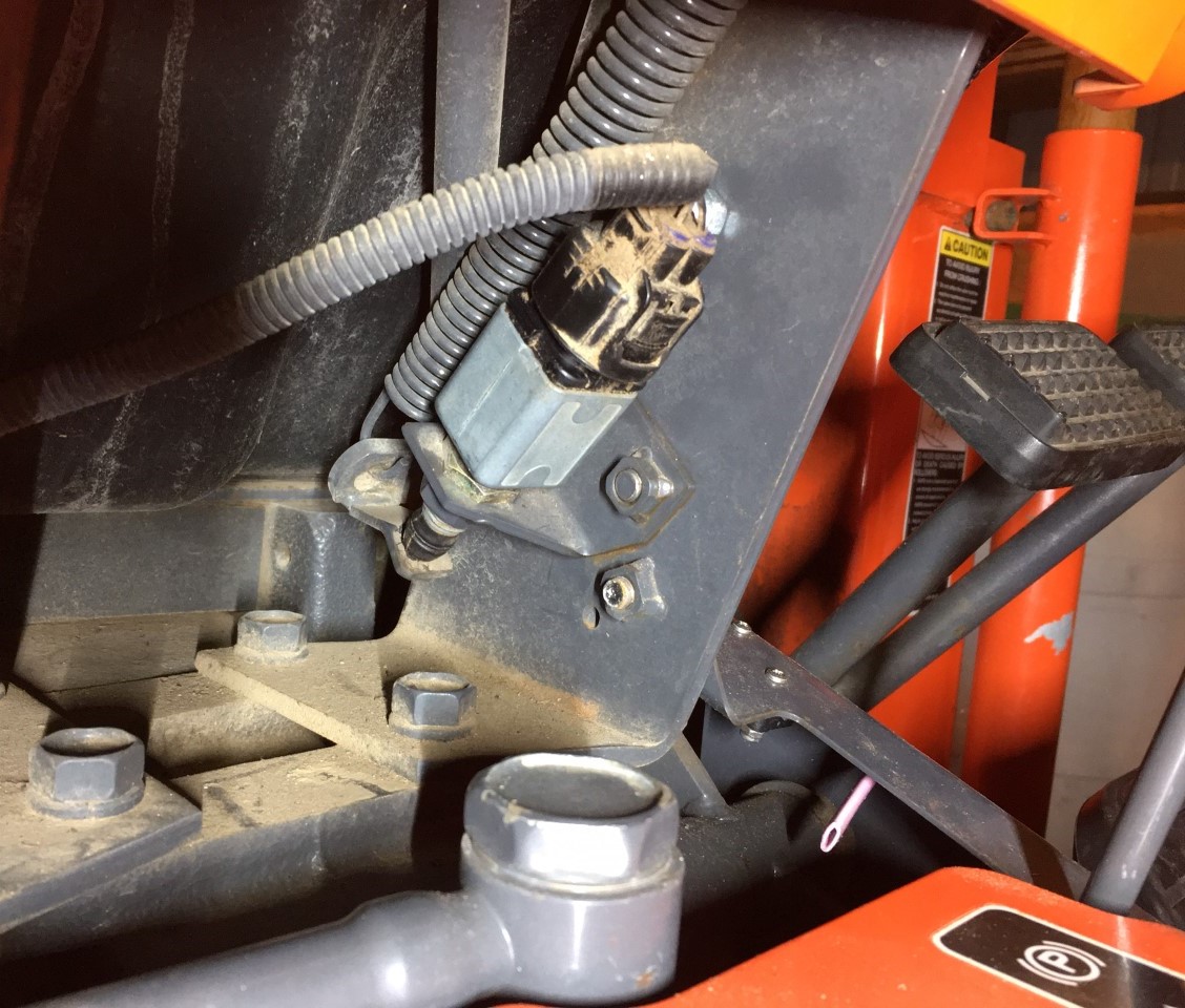

My L3400's is an HST, and when I leave the seat, especially when the tractor isn't fully up to operating temperature, it often will die. I realize there's a switch of some sort related to the forward/backwards treadle, and it seems to be the issue. Usually, with enough wiggling I can find the sweet spot which will allow the engine to continue running while I am off the seat. Before I start tearing into things, I am asking if anyone has experience with this, and where the switch is located? I could render the seat occupancy switch always on, but that seems like a bad idea for several reasons. Setting the parking brake has no effect. At first, it was a random occurrence, but lately, in the cold weather, it is almost all the time.

Oh, I keep the tractor greased! The pedal moves back and forth freely- and I've tried getting off the seat with pedal teased towards forward or the rear, to no avail. Since it's become intermittent, I guess it's an adjustment that needs to be found and made. I am thinking I will remove the pedal and deck plate when it warms up a bit.
   / L3400 Neutral safety switch isn't working right
Turns out that fixing the problem was embarrassingly easy. The switch is conveniently located below the steering wheel, in the open pedestal. I turned the switch down 3/4's of a turn, tighened the locknut, and all good. That's the brake pedals to the right of the switch.

Yes 5 minute fix and you don't even have to unplug the wire...
