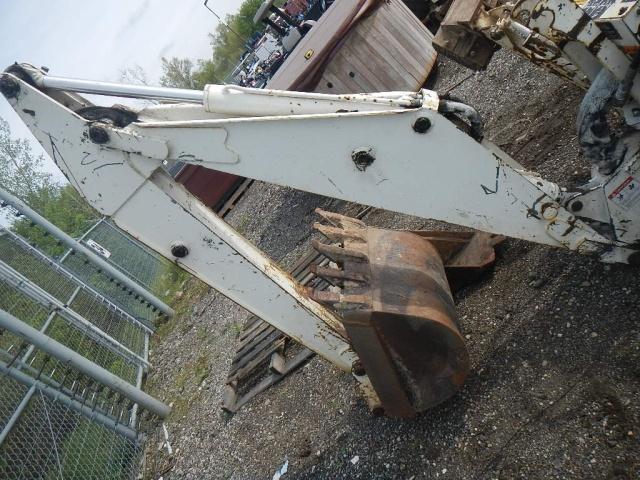

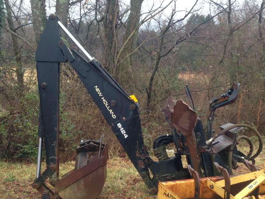

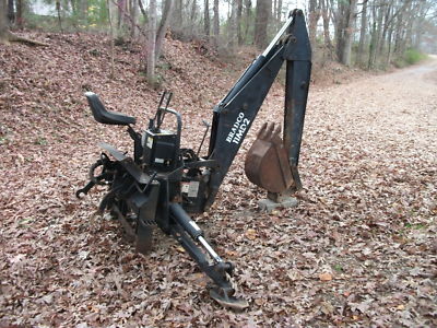

Joe, the backhoe looks like it was made by Bradco. (See pics below of a B-124 and a Bradco 11MD) They were higher-end machines with spherical rod connections, replaceable bushings, jacketed hoses, etc. - reinforced in all the right places -nice work. Bradco made OEM versions of their backhoes in several brands. The 11MD digs 11 ft deep - 14' max reach.
The L2850 tractor series has a good reputation for durability. For a price guesstimate, the asking prices for super low-hour machines this size can be high - $15k - $18k, the backhoe being maybe 25% of that.
Of the 2 machines, the L35 may have faster hydraulics and the backhoe is tucked in tighter for better balance and maneuverability. Good luck - the hunt is half the fun of tractor buying :thumbsup:
