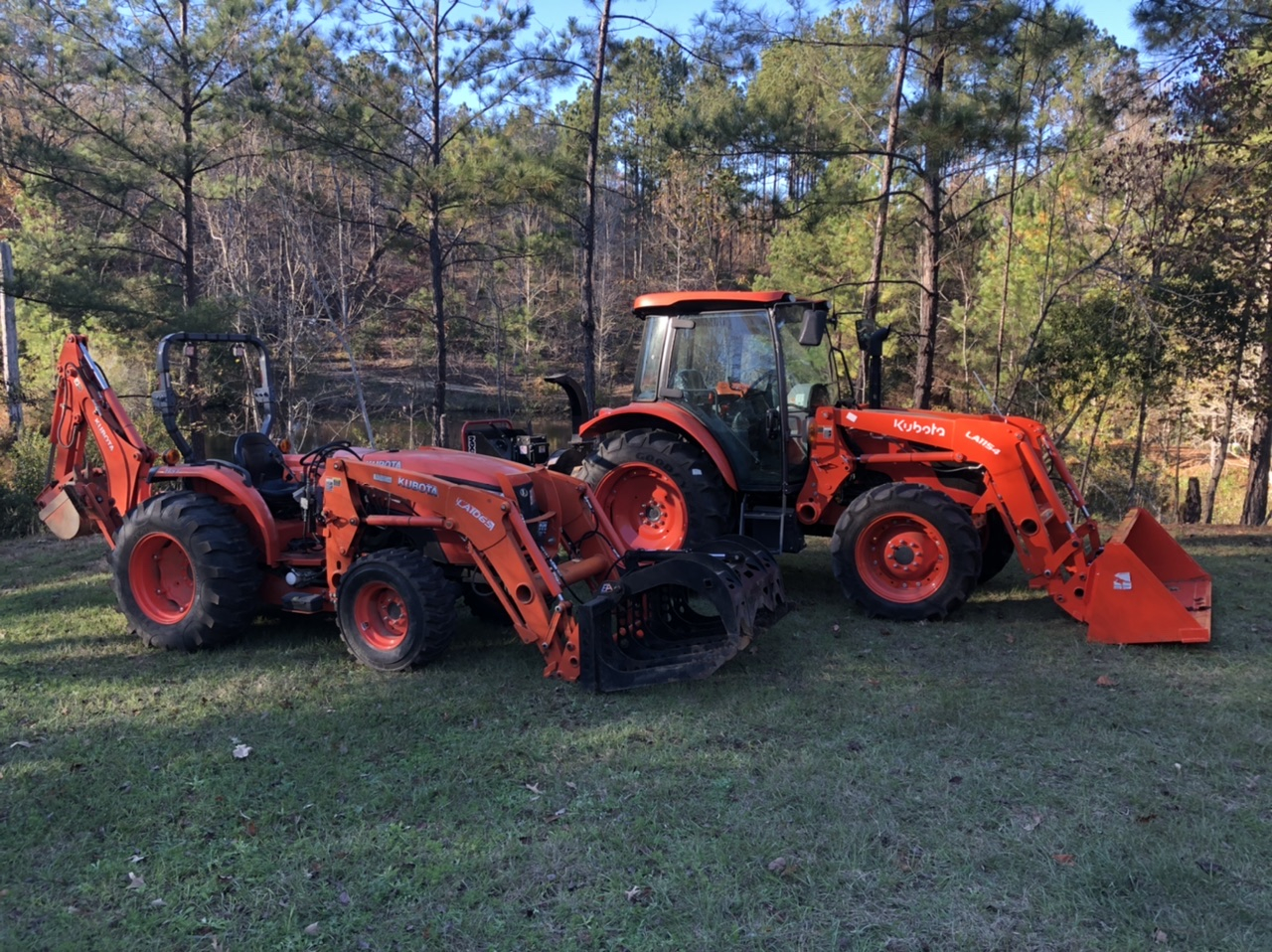

I started off with an L4630 GSTC and loved it but it was aging and I wanted to get into something bigger.
Found a used pre-tier 4 M6040 DTC for a great price and snapped it up.
The M is a beast compared to the L in all categories. Larger wheels, much higher loader capacity and of course 15 more hp.
