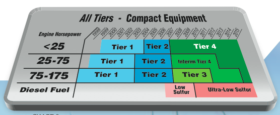

It's not helping that you all are mangling the diesel tiers -- most compacts under 75HP have been Tier 4 Interim for many years.
Tier 3 only ever applied to 75HP and up.
Tier 4 Final is what has added complexity to tractors over 26HP, starting in 2014/2015.
I don't like to harp on this all the time, but when it gets mixed into conversation like this it really confuses things.
I was referencing the Kubota Series or Families of engines, not the emission tier series.

I think all the emission tier stuff comes down to is:
If you're not sold on the latest emission controls, like DEF fluids, particulate filters, regen, turbos*, etc. You can still buy Yanmar CUT like the LXs off the dealership lot that have excellent reliability and engineering reputations, and a 5 year-2000 hour warranty.
But act soon, these Interim TierIV/IIIA CUTs aren't going to be available forever. The Yanmar full Tier IV models are starting to arrive.
*the 49hp LX has a turbo. The 41hp and 45hp LX models are naturally aspirated.

Coming down to the wire. Everyone has had some good thoughts. The Yanmar is a tier 3 and he will not go down on the price.
Don't want to belabor the point, but it is a Tier 4 Interim engine. Make sure you know what you're buying. If the dealer is saying Tier 3, he doesn't know what he's talking about.
