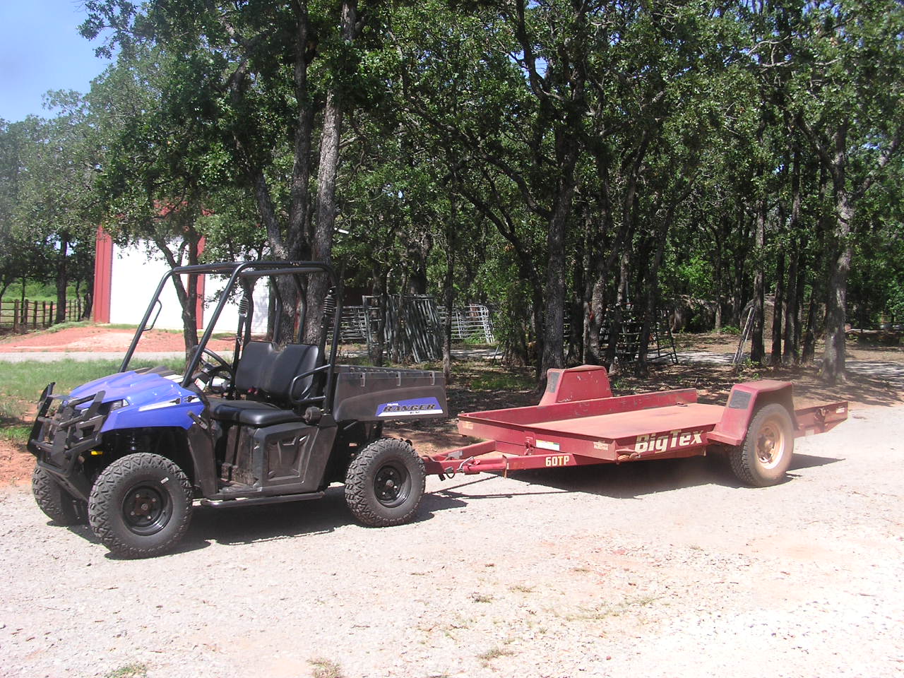

Here is my :2cents:, Gas, Diesel, or Electric?
I have had all three over the years, and for my needs now, I prefer Electric! :thumbsup:
First one was gas
Traded that in on Diesel
Traded that in on Electric

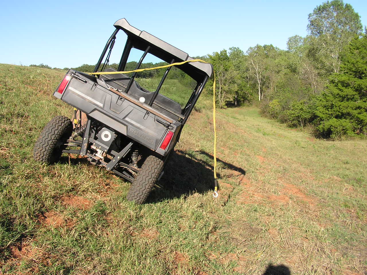

Upgraded the tires, to Interco Interforce 27-7.5-14, 6 ply, 2" narrower, 2" bigger diameter.
Pulls a trailer and handles side slopes.
A 3 point hitch is available that would do what you mentioned,
This Polaris EV mid size wheelbase is narrower and and shorter than the others that I had. It has more power and speed also.
And is much quieter :D :thumbsup:
More pictures: http://www.tractorbynet.com/forums/a...is-ranger.html
