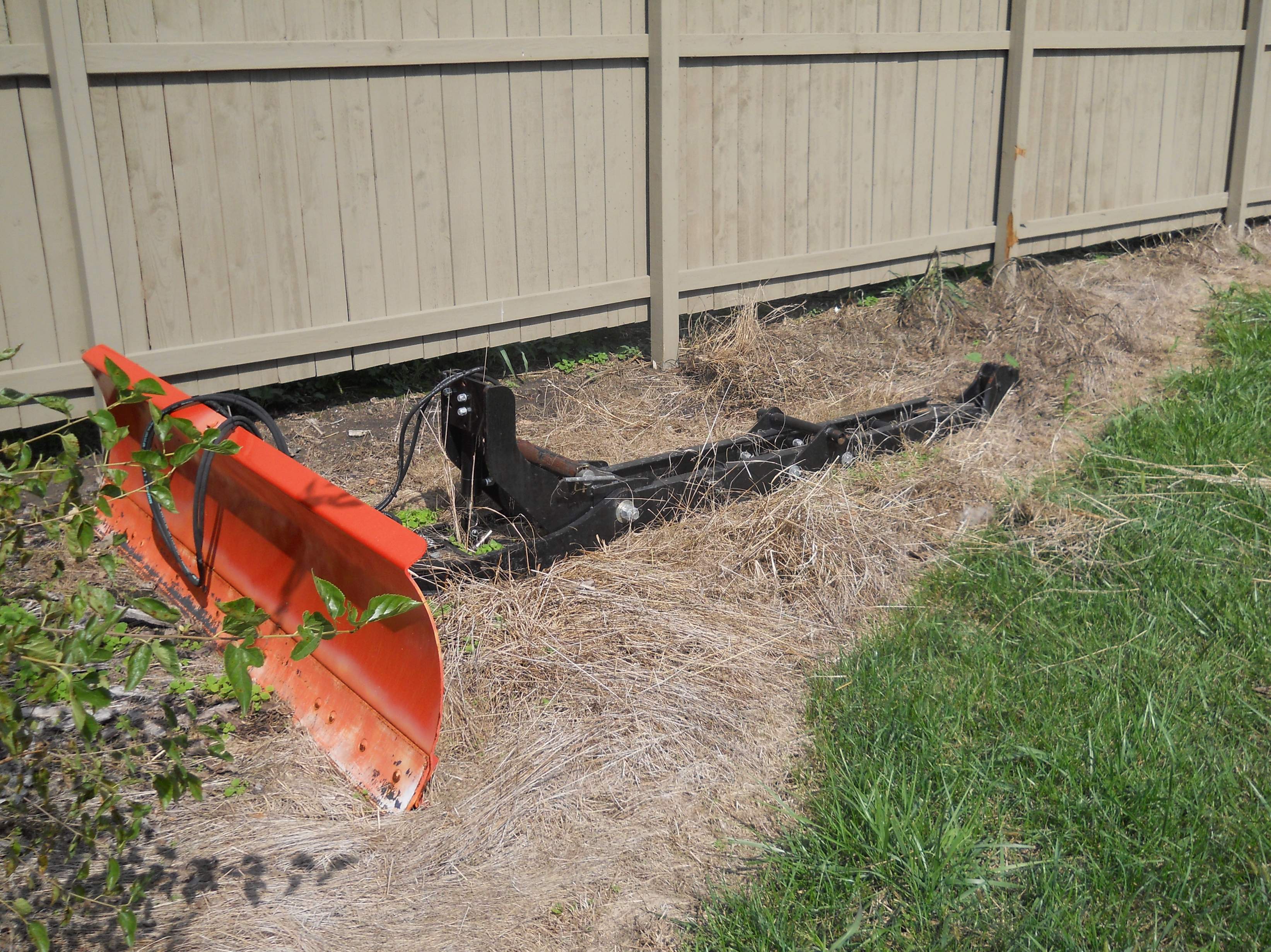

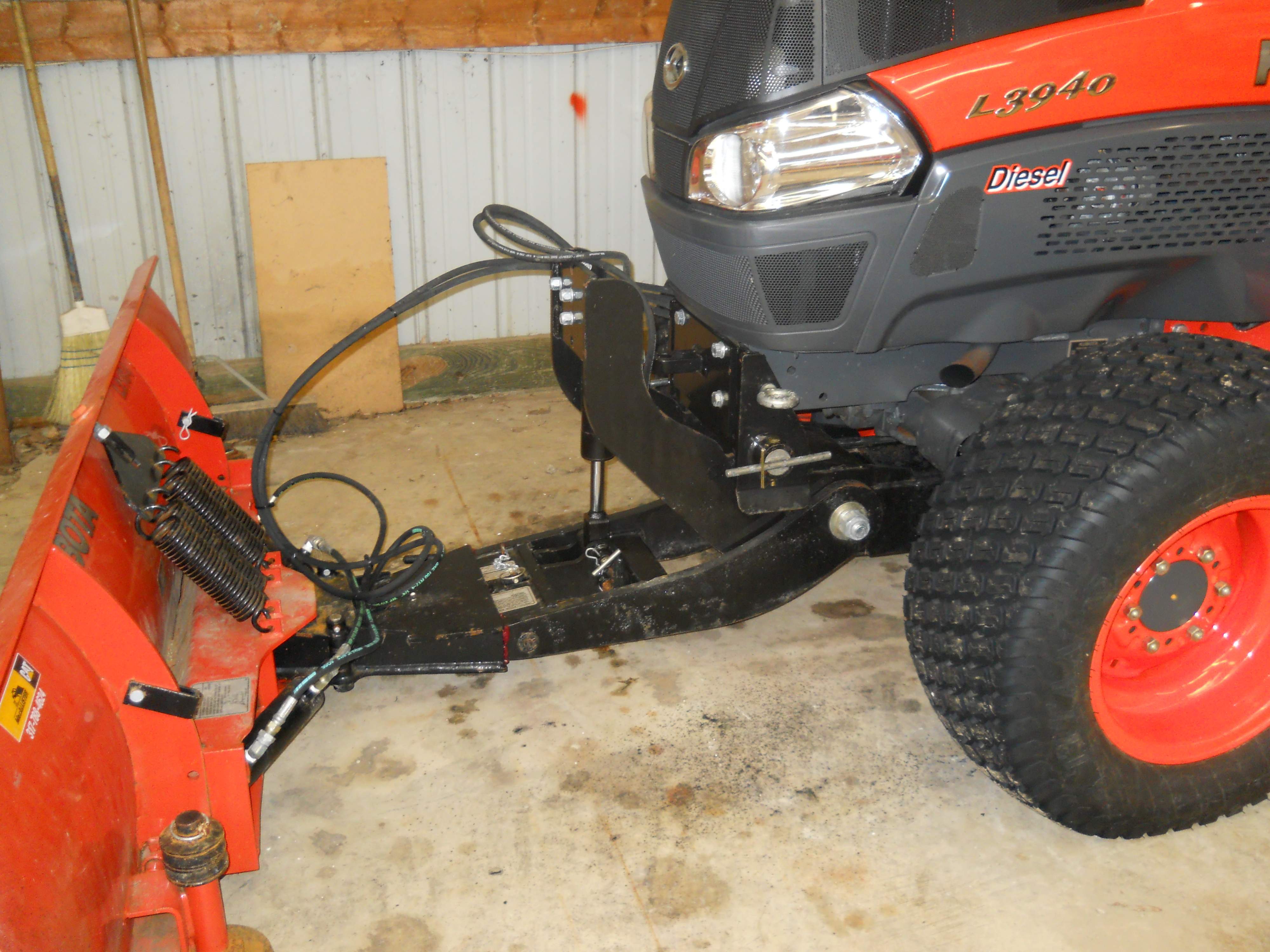

Here is part of the sub-frame for the GrandL. I attached at the front, sides, and drawbar (full frame). If I get a chance this week I will take pic of complete frame, as it is off the tractor now. Philip.

The guys who plow lots here with M's either use loader mounted plows or sub frame mounted plows. The subframe mounted units run to the rear drawbar and pin onto it or they connect to the rear axle with big u-bolts.
A smaller bracket up front keeps the plow aligned side to side and mounts the lift cylinder.

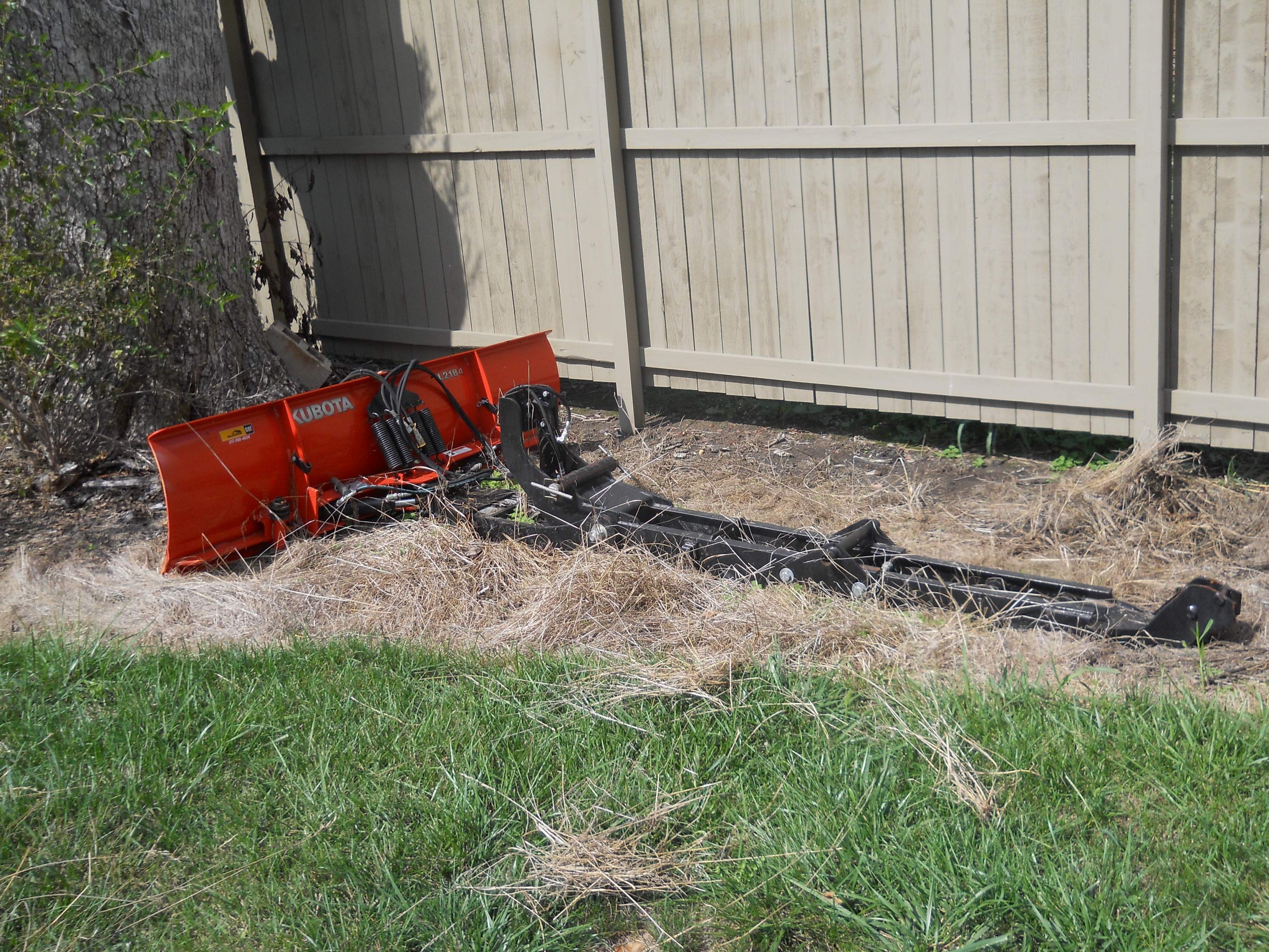

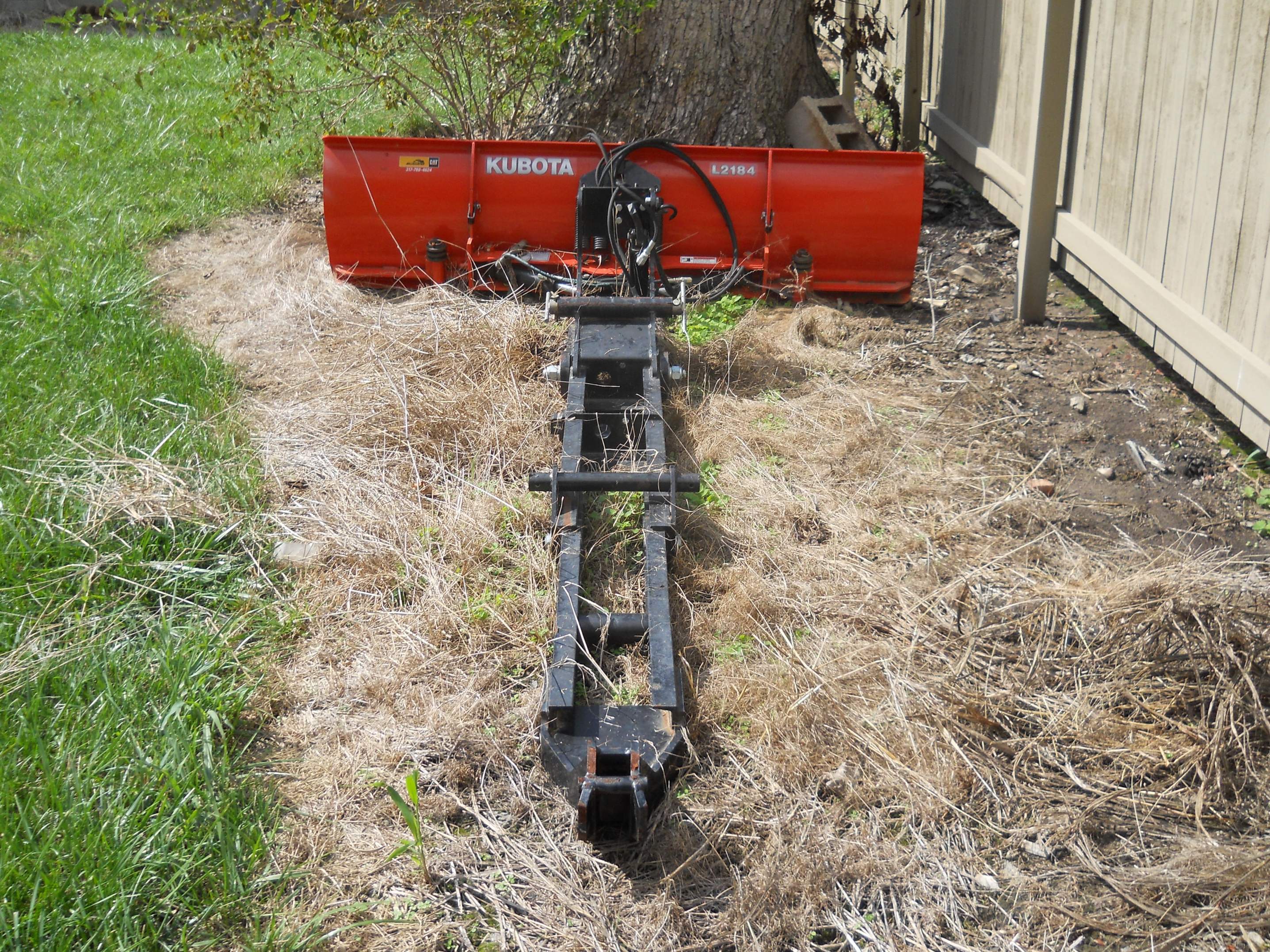

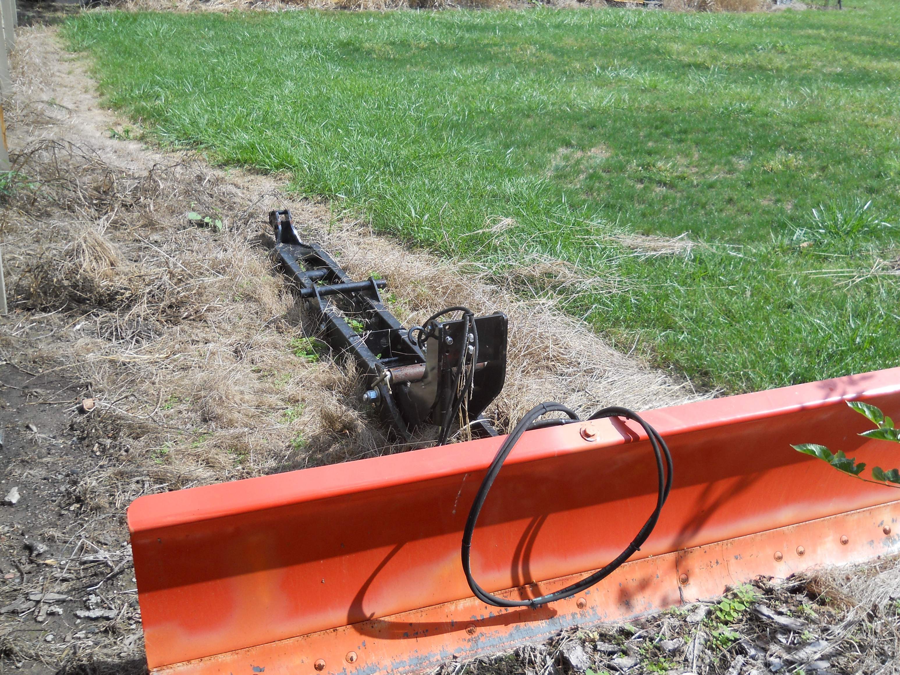

Here are pics of the GrandL sub-frame. It attaches with two 2" pins in front, two 1-1/4" pins mid-section, drawbar in rear. Philip.
