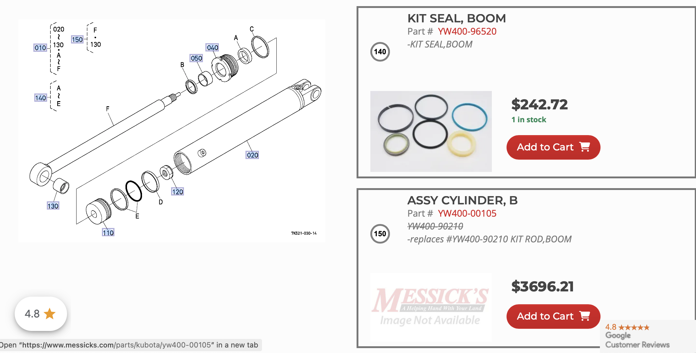

You could always order a new cylinder intact....about $4K. A seal kit is $250.
As far as I know there never were any specific boom cylinder repair parts from Kubota to deal with that boom cylinder failure mode. The original recommendation was to replace the entire boom cylinder with the new style - see message #10 attachment for the program and new part number. YW400-00105.
That said, the free replacement program was a long time ago. Some of us thought the problem was the 30 mm piston retaining nut backing off and fouling the end of the cylinder rod ......but I don't think we really know what the problem was. It must have been concerning for Kubota to be so aggressive about replacing the cylinders as a "Top Issue". It would be worth a chat.
Otherwise, for $4K it would make sense to take yours to a good hydraulic repair shop and let them decide what to do. A lot of hydraulic shops don't advertise. Your local JD yellow construction machine dealer is who I would ask to find a repair shop. Most construction dealers send out their cylinder repairs.

Yes Messick's shows the part YW400-00105 as being able to order but it is "backordered" on the Kubota parts site. Interestingly that is the part number for the entire cylinder as well the "Rod Kit". That part replaces the now obsolete part number WY400-00104. I did contact Kubota Customer Care and they said there was no known issue with the cylinder and since I am out of warranty there was nothing they could do.
I think you are right about my best option being to send the cylinder to a good hydraulic shop. Since the dealer already has the cylinder pulled and broken down I will let them send it out.
