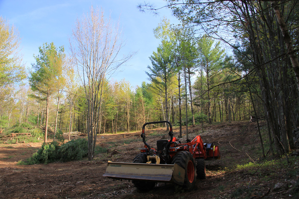

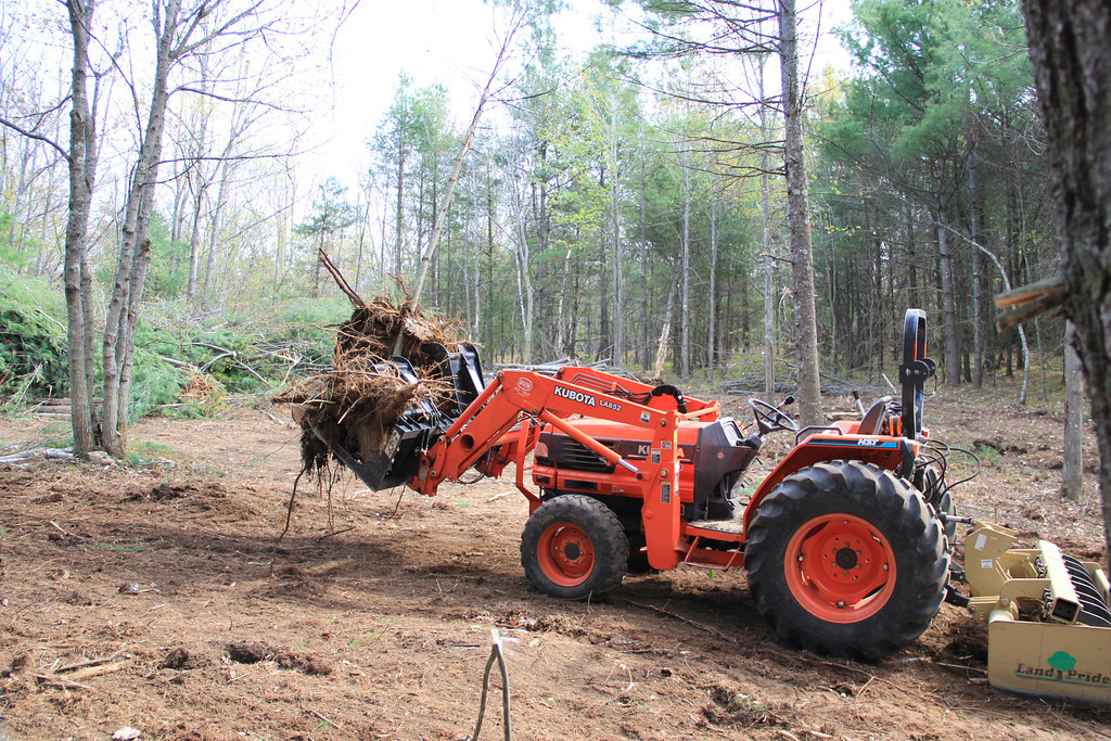

Brian,

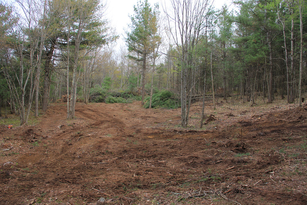

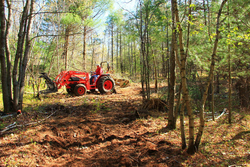

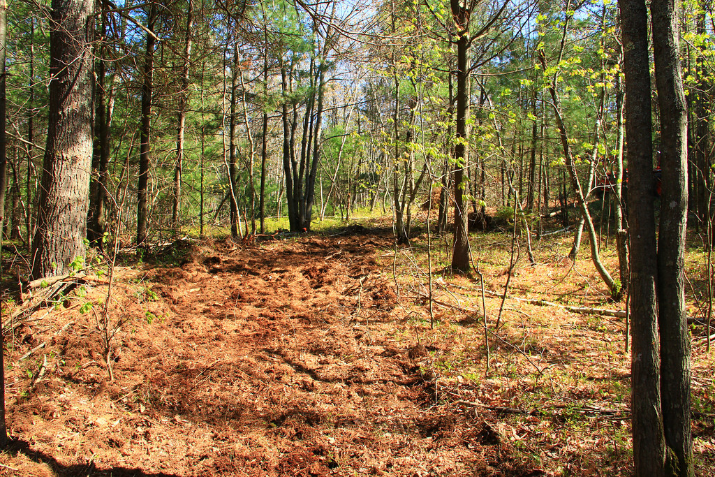

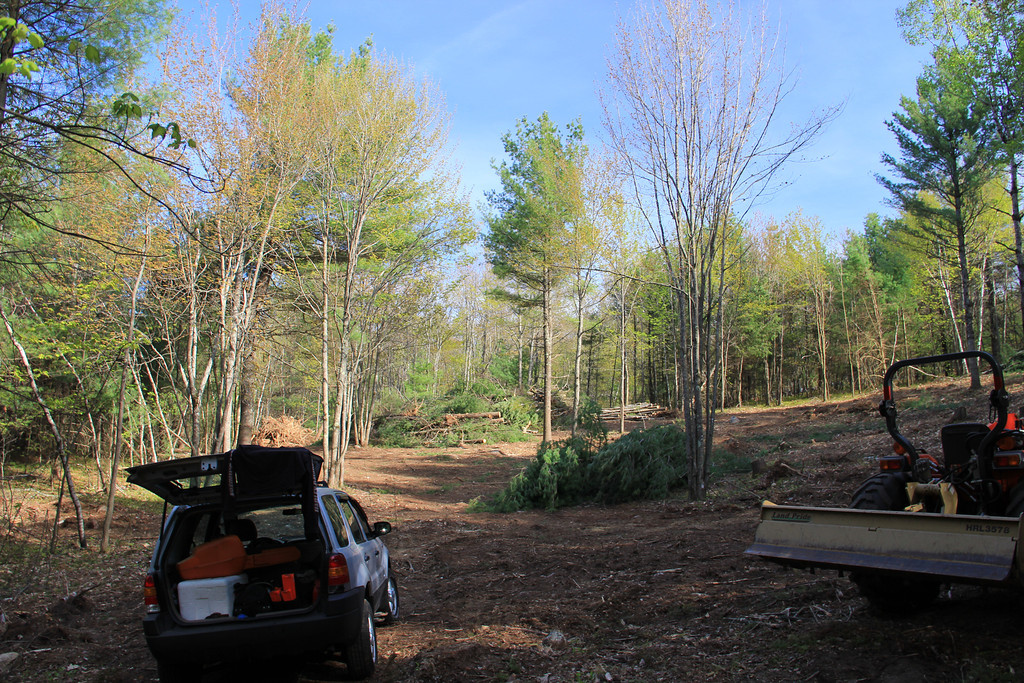

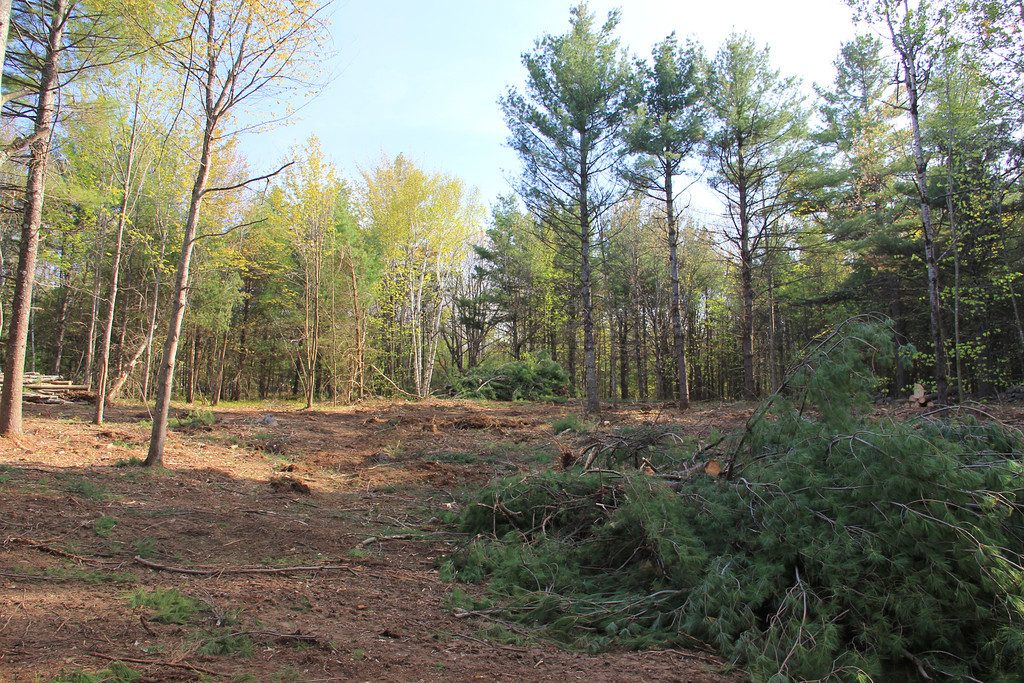

If you are planning on doing any amount of woods work, your first and most useful attachment should be a FEL grapple. Hands down, you will get more use, and be more productive, than you ever thought imaginable.
I did this project with nothing more than a box blade and grapple, and the box blade wasn't all that necessary, but helpful nonetheless. No backhoe used for any of it (and I have a full sized John Deere 410 construction loader/backhoe as well)
Before:
After: (taken from close to the same spot)
Some more pics here:
http://www.forestryforum.com/board/index.php?topic=61752.0
...and here...
http://www.tractorbynet.com/forums/attachments/211635-grappling-fun-picture-thread.html
...and here...
What's your technique for removing trees/brush with your grapple? Here's mine....
Point being, either of those choices would be 100 times more useful with a grapple instead of a bucket on your front end loader. If money is a serious concern, I would rather the smaller tractor with a grapple, than bigger tractor without. However, the bigger tractor with grapple would be more useful, mostly because of higher FEL lift capacity since the grapple itself weighs a lot, and takes a lot of lift capacity away.
My tractor is equivalent to todays MX5100 for reference. After you get the grapple, then start thinking about other attachments :D

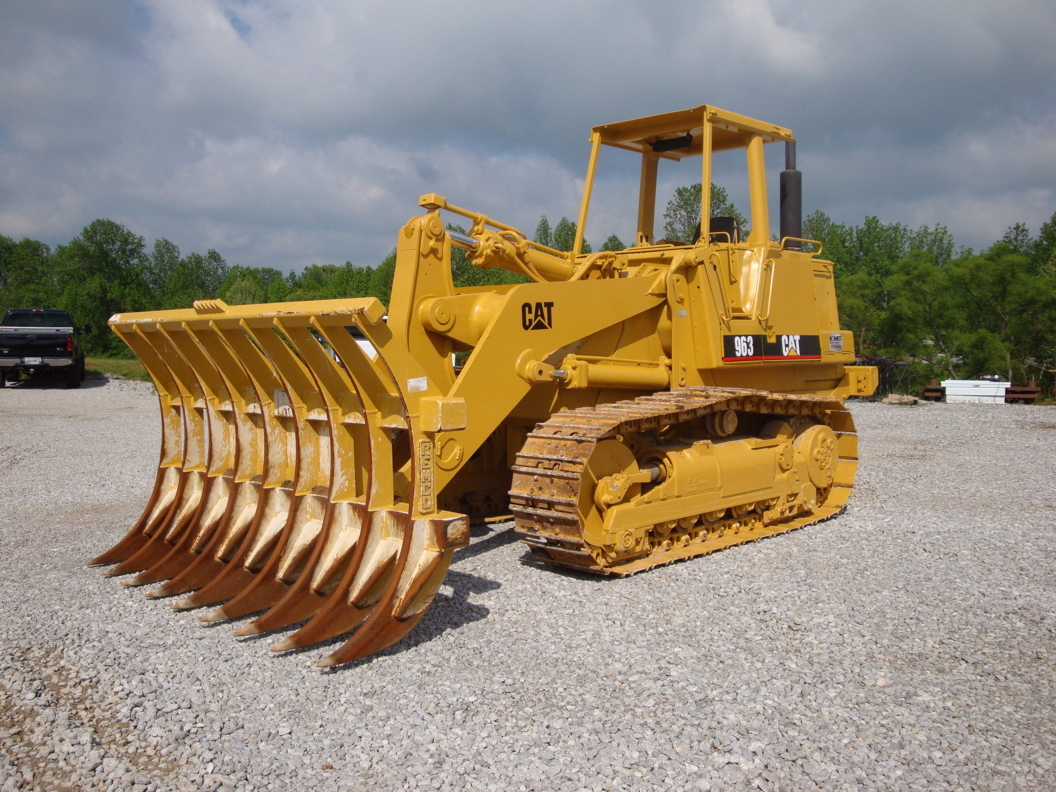

I get more out of my root rake for heavy work...I would like a grapple, but the thumb on the mini works well for brush work
   / Kubota L3800 -vs- L4600 For Stumping Etc. #16
I'm positive a mini ex with thumb, in addition to a tractor, is WAY more productive. That's not really in the cards for most people though, and would be way out of the price range the op is looking at.
What do you mean by root rake? One on a dozer?
