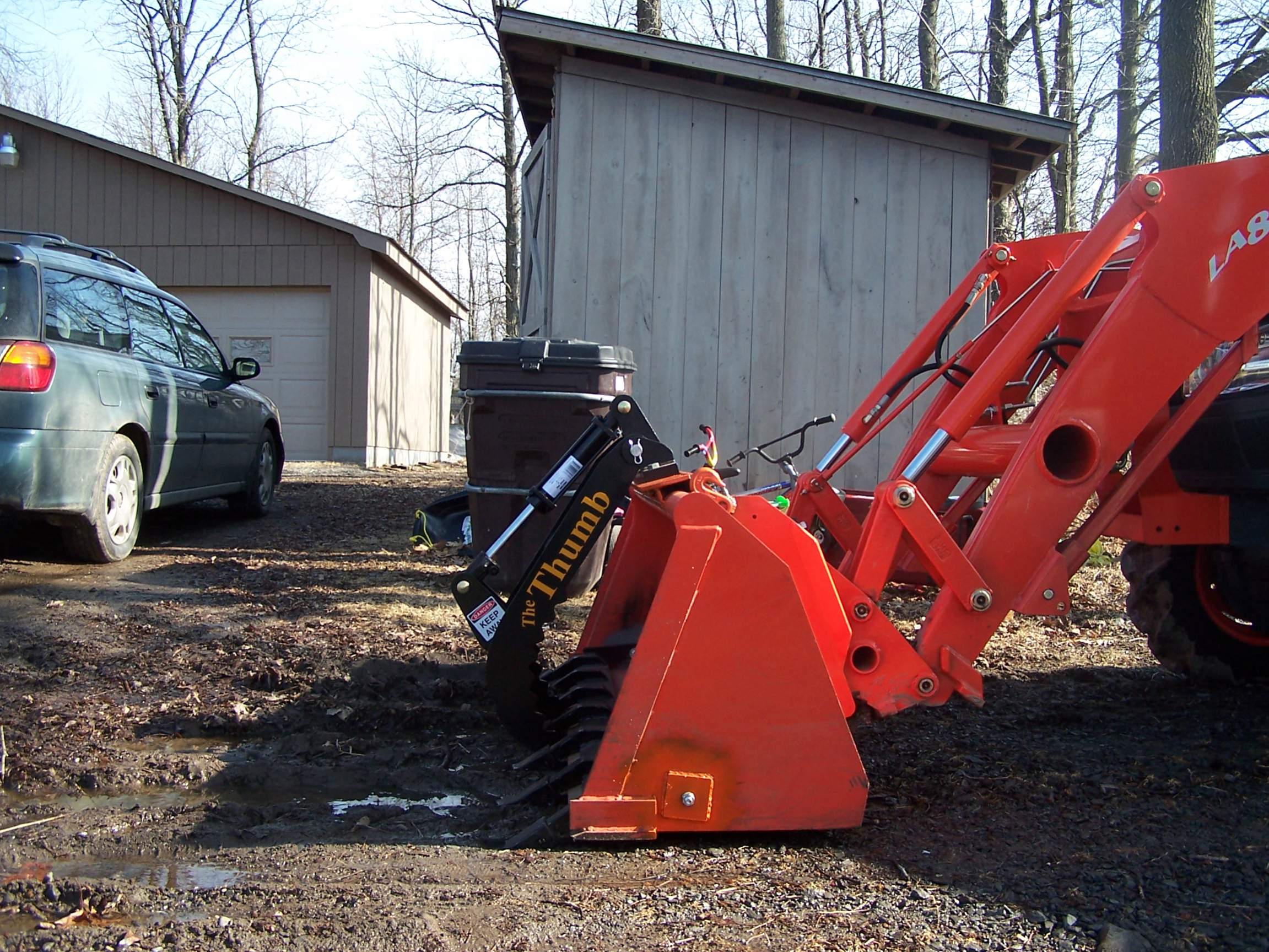

I like the tooth-bars(they do unbolt if needed),I chose a Green's Machine Thumb for my HD bucket.Both work very well for me.
