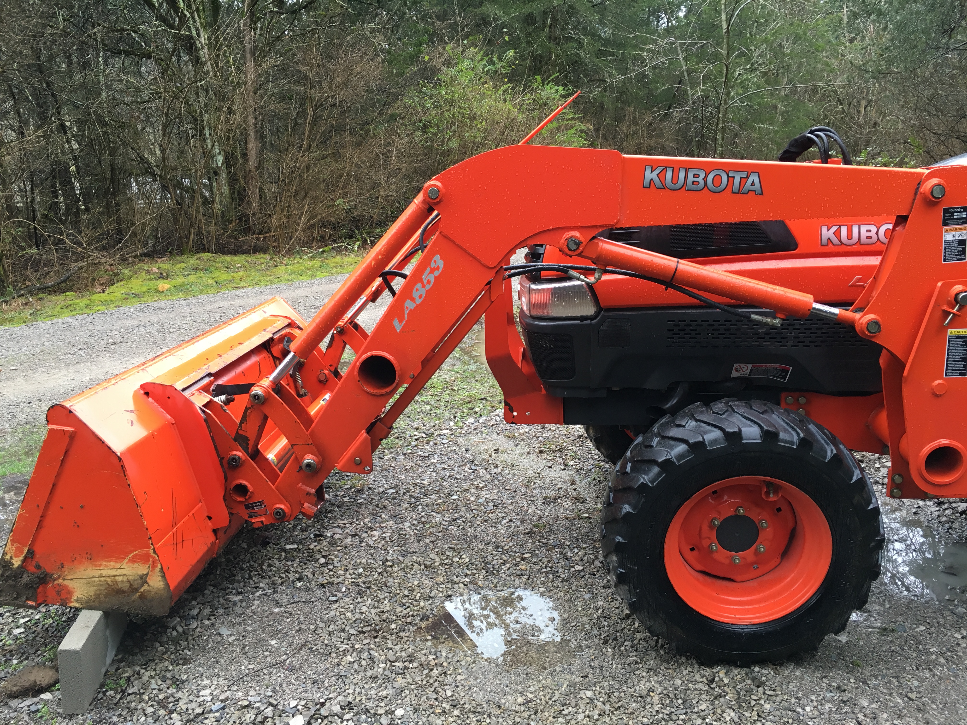

I bought a used Kubota L3830 with the front loader, which had a little over 100 hours in it. Everything worked fine for about 10 hours. Then one day, the front loader started acting weird. It could go up, and the bucket tilted fine, but wouldn't want to come down. So I left it at up position for a few days. The next time I started, it came down, and also it went up about half way, then it started to move up at a snail pace. It also came down very slowly. Eventually, I could get it down all the way, although it took forever. I left it there for a few weeks. Yesterday, I fired it up again, and this time, it went both up and down at a snail pace... About an inch per minute. Today, it could go up a little faster, but took forever to come down. A little later again today, it could go up at a decent speed about half way, then turned into snail, but could come down at a decent speed. All this time, there were no issues with tilting the bucket.
Any ideas what the problem could be?

OK, my bad. My tractor is L5030 and the loader is LA853. Sorry.

I just had the same problem with a friend's L4200. It turned out to be the 3-point hitch adjustment. If you lowered the 3-point a little the FEL would work fine. Adjusted that and no more problem. Worth looking at.
/ Kubota Front Loader LA953 acting strange #14
Check to make sure the 3-pt hitch isn't pegged and putting the system into relief.
That would definitely be something that could have started when you hooked up and lifted the backhoe.
The 3-pt is last in line to the tank -- taking PB flow from the loader. But if it's being pegged in a lift setting, it will mess up the loader functions.

3-pt hitch it was! It was set at the highest position, and lowering it completely solved the problem with the FEL.
