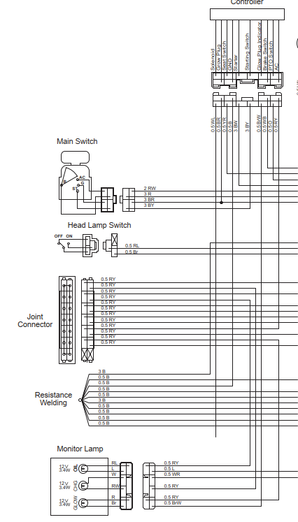

The controller and joint connector are tied into safety switches and the monitor lamp. I get 12v everywhere mentioned earlier and I'll add headlight and horn. The dwg attached is all I have to check for voltages/connectivity (page 254) there's 12 volts going in to controller, when I turn the key to acc pos, fuel pump runs, no monitor lamps, turn for glow plugs they work, next to start fuel pump still running, no starter.
I measure in acc mode at the joint connector no voltage should there be voltage on any of those 0.5RY wires? I have bypassed all lockout switches which run through the controller.
The main switch, all safety switches and starter work as intended. I go back to the controller is it not allowing a complete circuit connection because its bad? I don't know about these controllers oddly one function that does work are the glow plugs do work.
Does anyone have a better wiring diagram with voltages? Thanks Again

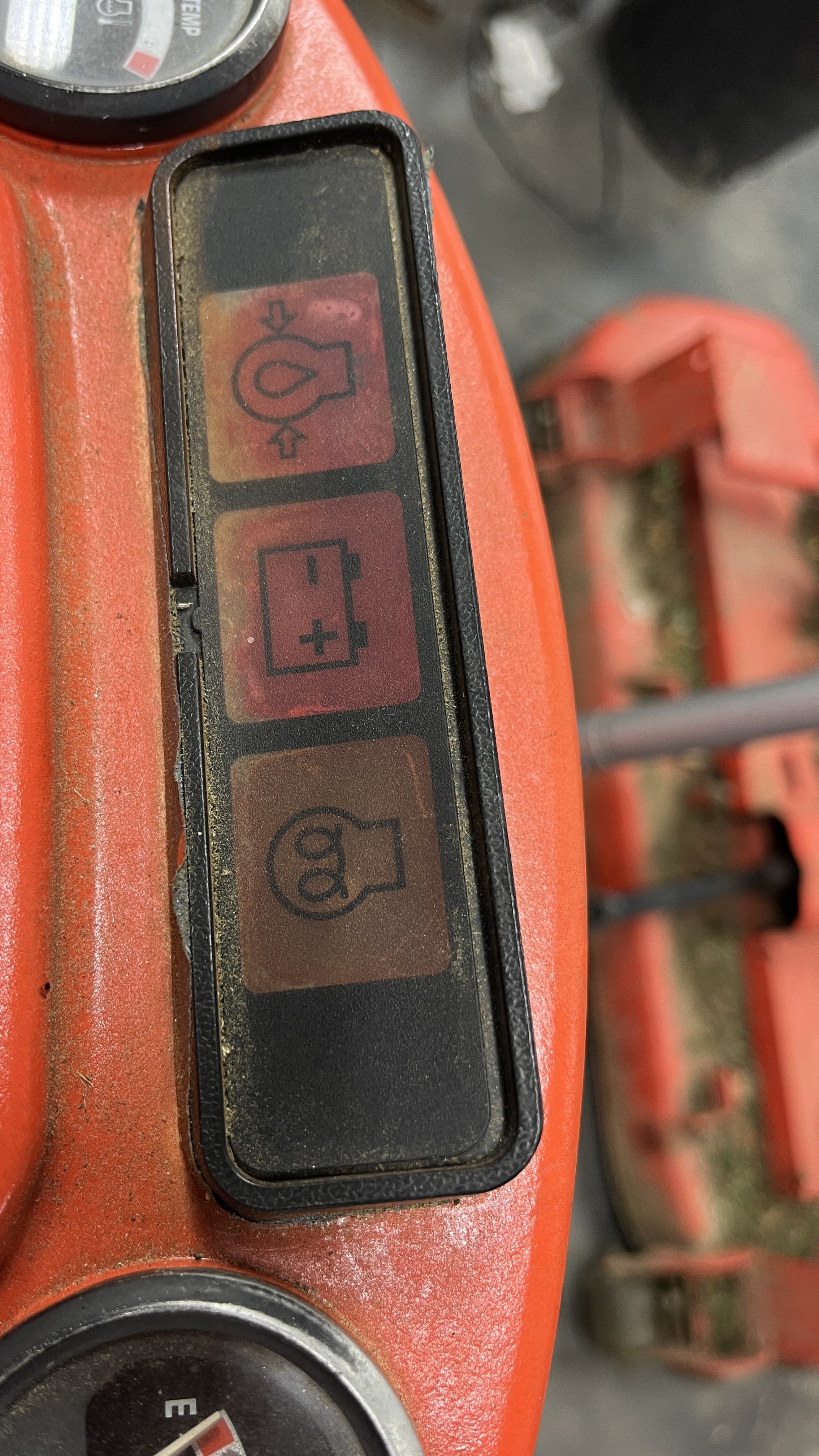

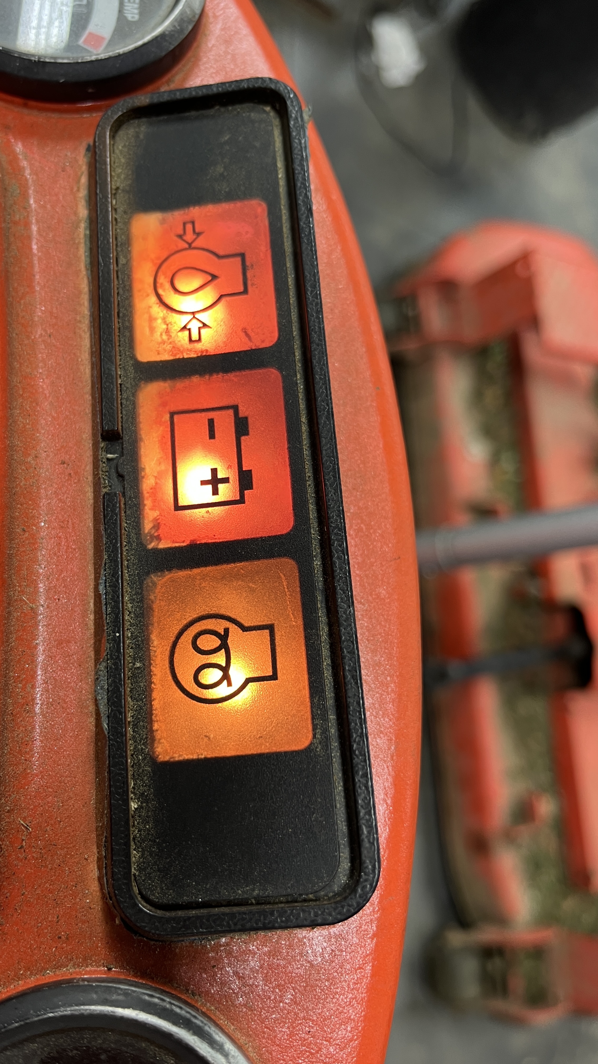

What a rookie move I made. Did a visual of the fuses turns out 5A fuse feeds the controller when that's not working neither are the monitor lamps. I wouldn't say time wasted I ended up cleaning future points of electrical failure and learned how to test this and that.
What I don't know is what specifically led to the failure of the 5A fuse. Something shorted out that moment I tried to start last I saw the lights go dark. No crank.
