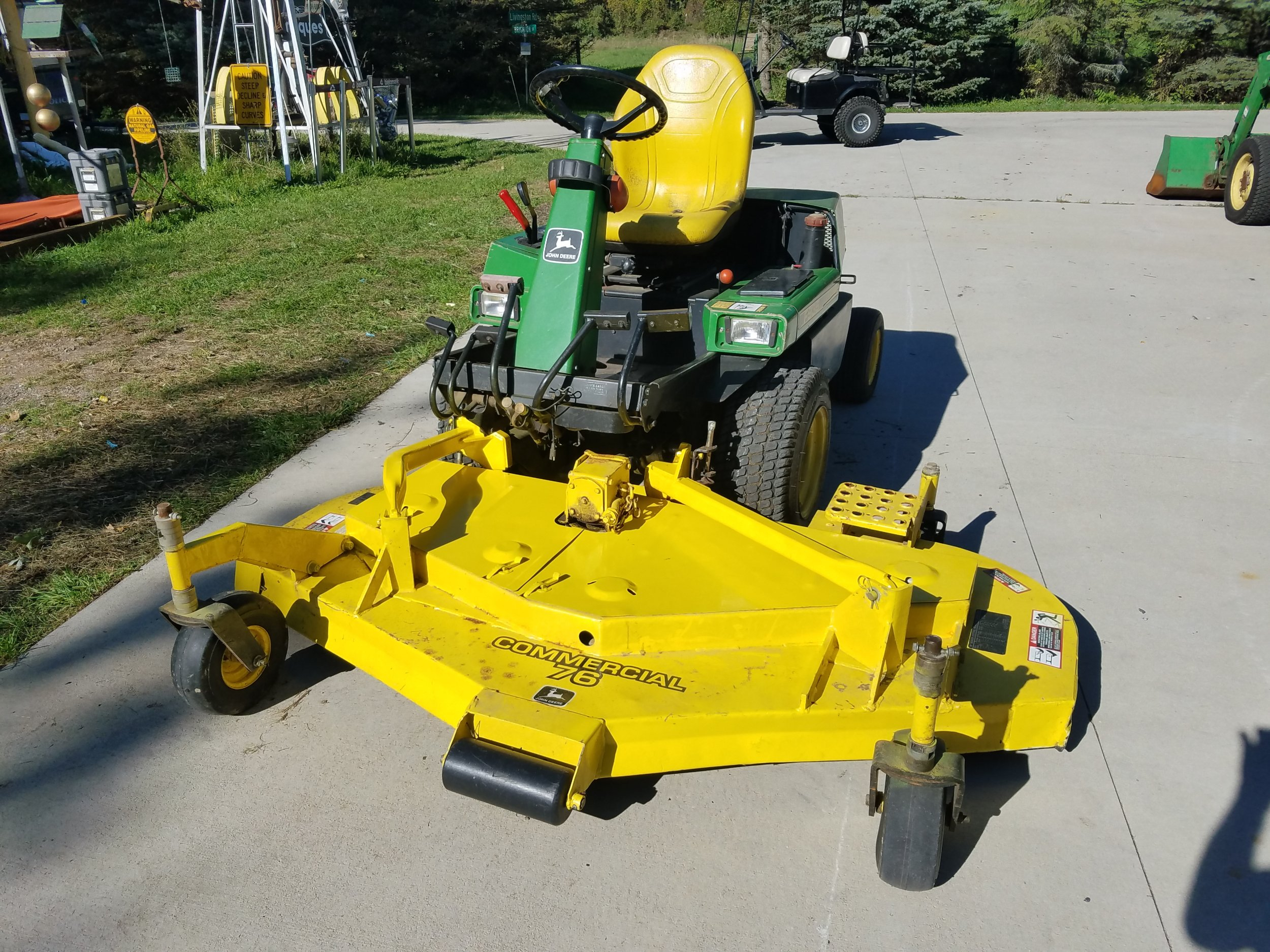

I have a JD F-935 2wd diesel (same architecture as your candidates). Came with a 72" side discharge deck. Recently acquired a 76" rear discharge deck for it. For steep slopes, you really need 4wd IMHO. With the rear discharge deck, the Commercial 76 uses a LOT less fuel, can cut faster, and chomps down high grass & weeds with no complaints. 72" deck chokes on the same field conditions because of the outlet side. Plus no more windrows. I recommend the widest deck you can get to save time and fuel.
Not too crazy about mowing steep banks because it will slide when used sideways if that's the intended purpose.

That offset deck is definitely not ideal for hill sides. The offset weight makes it difficult on side slopes. I did see that Deere now offers a dual rear wheel setup on the 1550 mower. I may go check one out to see how it compares to the Kubota F series.
