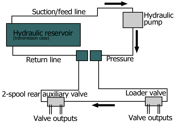

I wonder if the way I have the two valves plumbed in is causing the problem. I have attached a diagram to show how everything is plumbed. As a note, I had the rear auxiliary hydraulic ports installed before I installed and plumbed in the loader. Before all these changes, the rear ports worked fine, but that was about a year ago now. What do you think?
As a note, I also loosened the two loader arm lift cylinder connections to see if I would get air bubbles that came out, but I only got a slight drip from either connection when I tried to direct fluid to them with the loader valve. I installed the bucket and the loader arms will not lift at all, even with the revs up on the tractor. I'm leaning toward my pump not working.

You have paralleled your valves. Not good. Your flow is going to tank
All valves in a open center hyd system should be in series.
In your case, the pump flow should go first to the loader valve IN port, and the PB port from the loader valve should go to the remote valve IN port and then the 3pt.

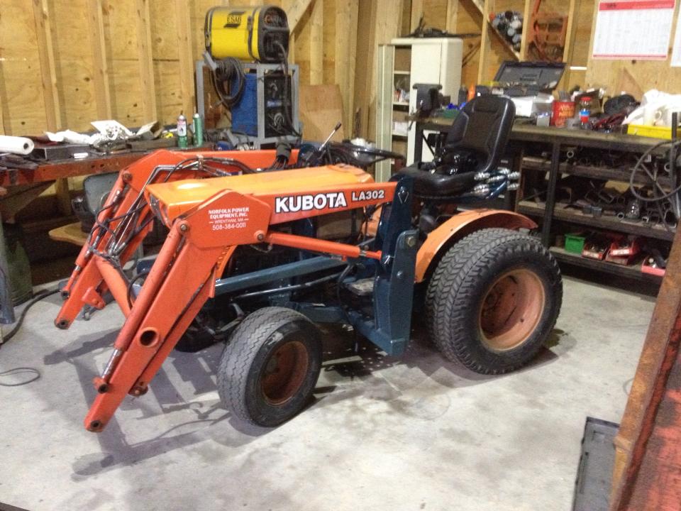

Your posting makes perfect sense! Of course the valves would not work in parallel. I just ran out to the shop, dug through my bucket of fittings, and welded up the fitting I needed to connect the loader valve outlet to the valve inlet line for the rear auxiliary hydraulics. I also plugged off the two ports that were empty on the distribution block, and it worked great! I've been scratching my head for two weeks on this one. You my friend, I owe a beer! Thank you so much for taking the time to give me advice.
Also, the loader works much quicker than I expected. I can't wait to put this machine to work again! Below are some picture of it working. Also, I have attached a new diagram showing how the hydraulic system now works for anyone who happens to have the same problem and finds this thread.
