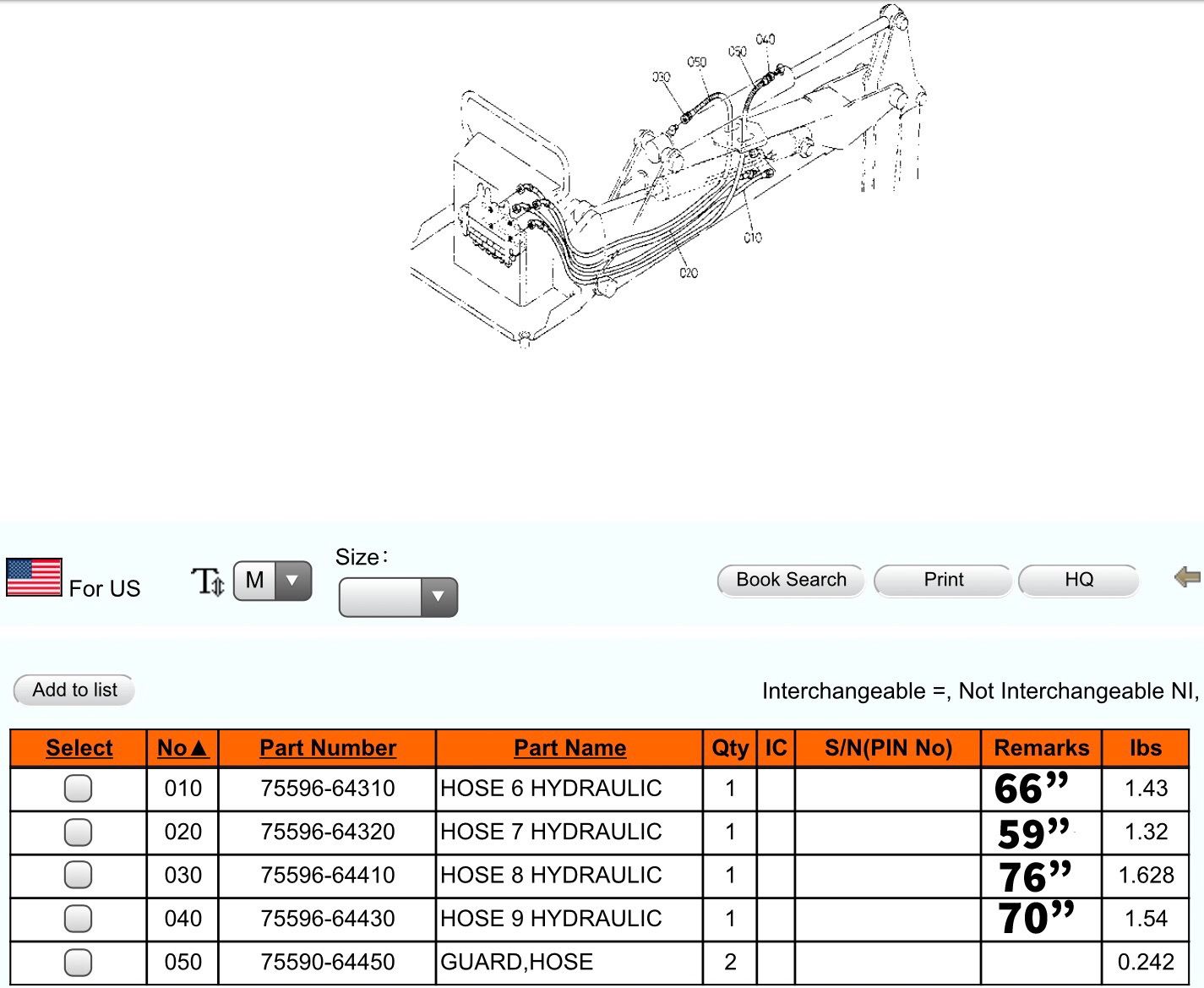

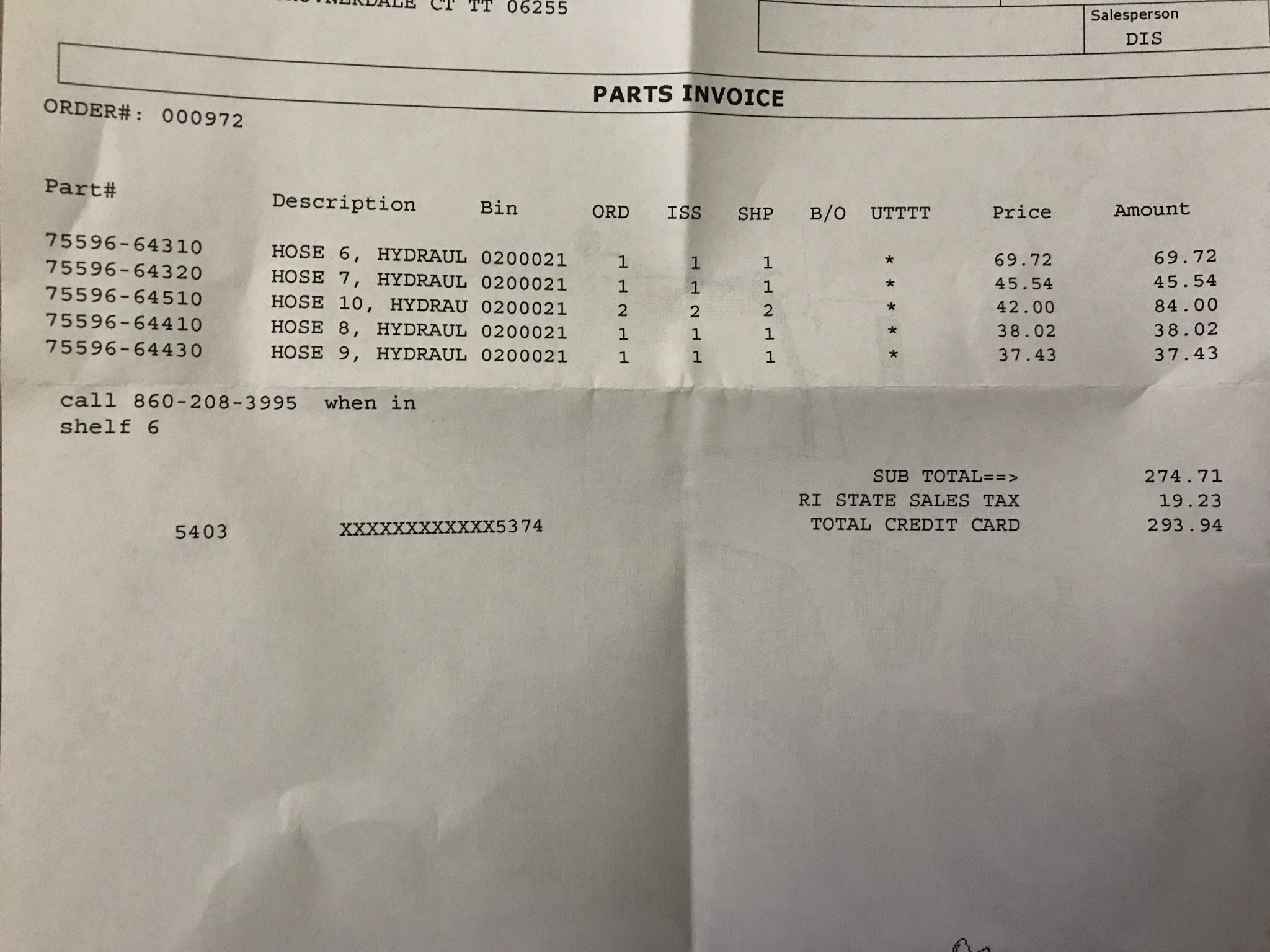

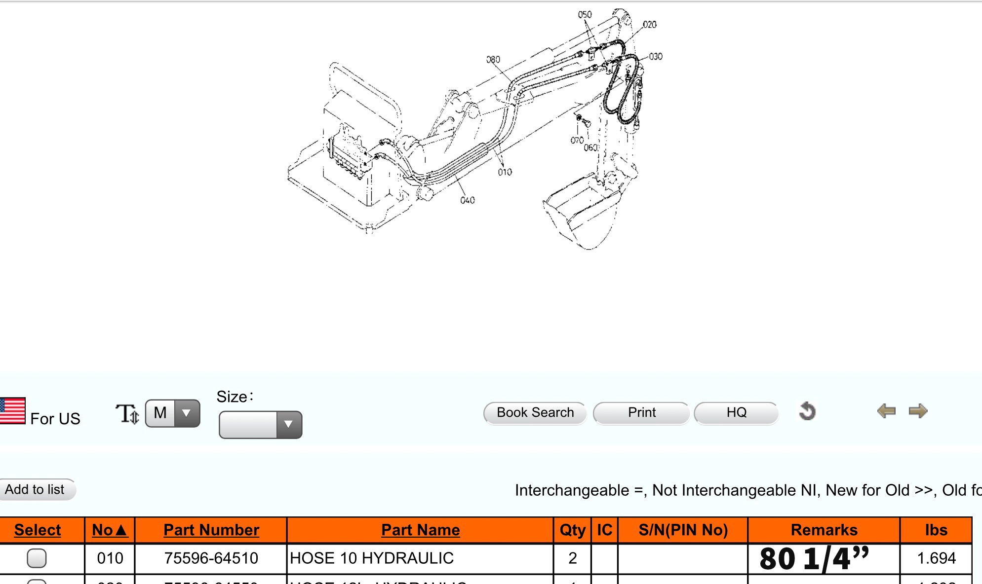

I replaced the six backhoe hoses that are run through the boom this summer. I brought them to two different places to have them made up; one was a hydraulic supply house and the other a Kubota dealer who made up hoses.
Both place the fittings were almost as expensive as the factory hoses complete. None of the auto parts stores close to me make hoses.
I was told by the Parker Hydraulics guy that the Kubota hose is a plastic hose not rubber and is more expensive than the normal rubber hose.
Total Kubota cost with tax was $293.74
P/n. Description Qty. Length
75596-64310 HOSE 6 HYDRAULIC 1 66”
75596-64320 HOSE 7 HYDRAULIC 1 59”
75596-64410 HOSE 8 HYDRAULIC 1 76”
75596-64430 HOSE 9 HYDRAULIC 1 70”
75596-64510 HOSE 10 HYDRAULIC 2 80 1/4”
Lengths are end of fitting to end of fitting.

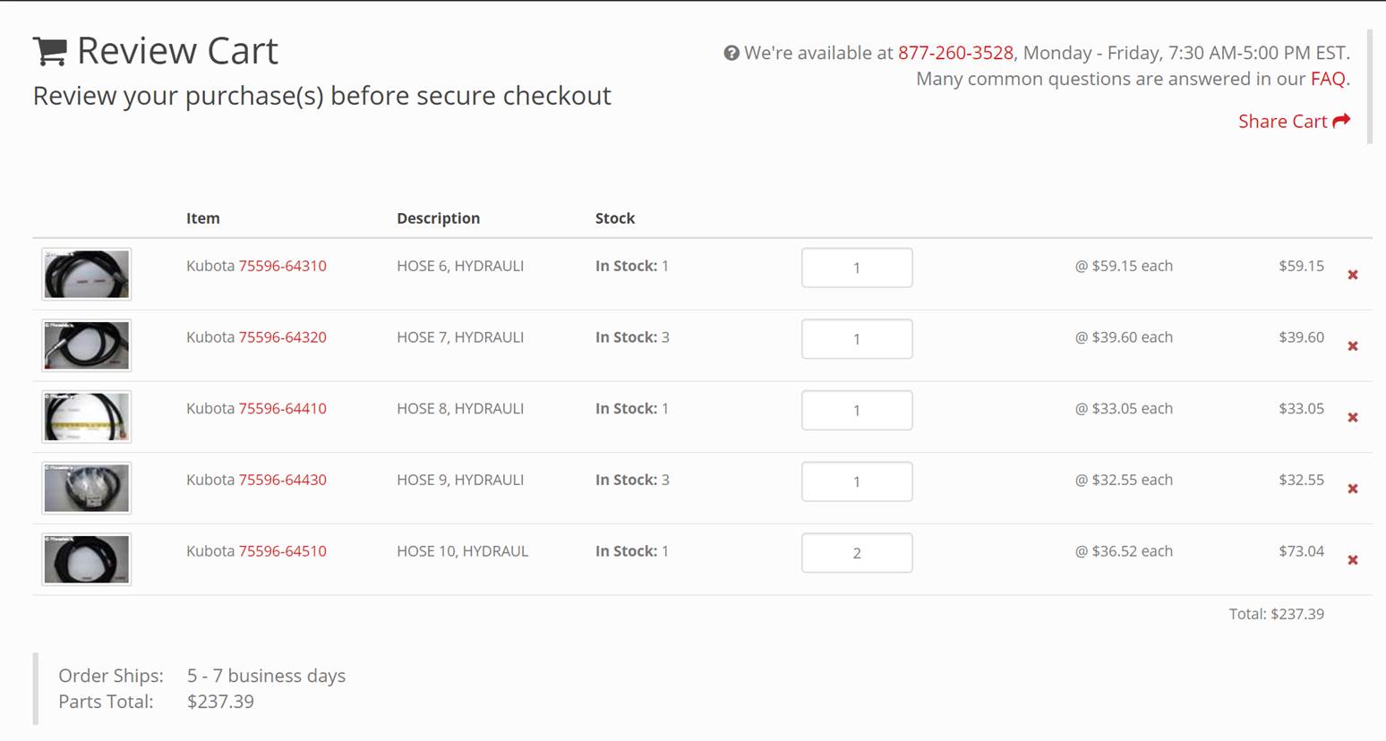

In the event it helps anyone...
Here's what the pricing looks like from Messick's for the individual hoses. $237.39
Added in Edit:
The PDF file didn't look so good, so added a pictures of cart.
