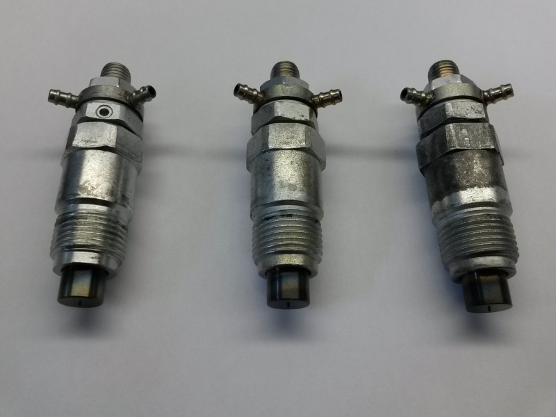

Looking at injectors for a '91 Kioti LB1914 with a 3-cyl 0.9-L TD950 diesel engine. Came across injectors for Kubota that look incredibly similar. Here's what I know about the Kioti injectors:
hex sizes from top to bottom: 19, 24, and 27 mm
marked with number: 2170
bottom thread size: M24x2
opening pressure: 1990.8 to 2133.0 psi
shim ratio: 0.1 mm (0.004") more shim = 142.2 psi more pressure
Here are my injectors after cleaning up the outsides:

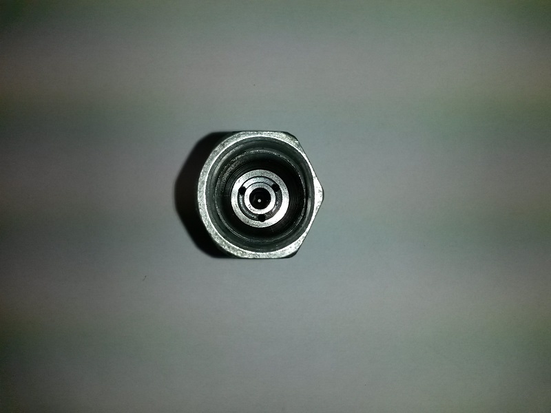

I took the frontmost injector apart to clean/check the inside and discovered that the top portion of the lowermost housing is ovaled (inside measures about 0.900" one way, 0.850" the other way). I had unscrewed things all the way, but the halves didn't seem to want to come apart. I believe that mating thread is M22 (0.866"), which explains why it would be digging into the sides that are 0.850" apart. I'm going to see if I can squeeze it back round in the vise or arbor press. Of course, it may have questionable reliability afterwards (best case: just the top portion is messed up and can be fixed without affecting the internal threads down lower). Probably more confidence-inspiring would be if I could replace that lower housing portion (anyone know who might sell rebuild parts for an injector like this?) or just get a whole new injector (would be nice to get one of those Kubota ones for ~$50 if they're interchangeable).
   / Kubota and Kioti injectors interchangeable?
Squeezed on the hex with a big Wilton vise lined with aluminum soft jaws and it now measures ~0.875" inside in both directions. It looks like they didn't get the hex on the centerline of the part when this one was machined, so a portion of the wall is thinner and could have distorted when wrenched.
Took the nozzle out of the lower housing (used pieces of wood to protect things in the arbor press). It has DN12SD12 marked on it, which appears to be a fairly common nozzle. Hand-pump tester should be arriving in time to mess with this weekend.

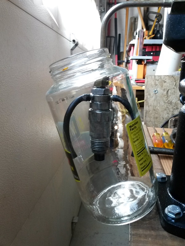

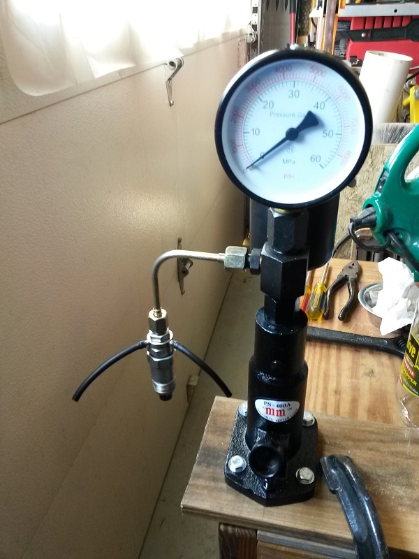

Got a working injector tester and mounted it to a piece of thick pallet slat with 5/16-18 tee nuts and bolts. I bent the adapter line 90 degrees with a tubing bender so the injector would sit vertical. Wasn't sure what the return barbs on the injector would do so I stuck some aquarium tubing over them. Injector 1 sprayed right around 2000 psi. Spray looked good and no dribbling. I'm plastic bead blasting the hard lines that go from the injection pump to the injectors. They look much better without all the gloppy paint on them. Plus, less chance of chipping/flaking paint getting in the connections. Speaking of which, does anyone know what standard those connections are? I found a few vague pages online about the machines that form the ends on the 6 mm OD x 2 mm ID tubing, but couldn't find a definitive answer as to what style they are.
