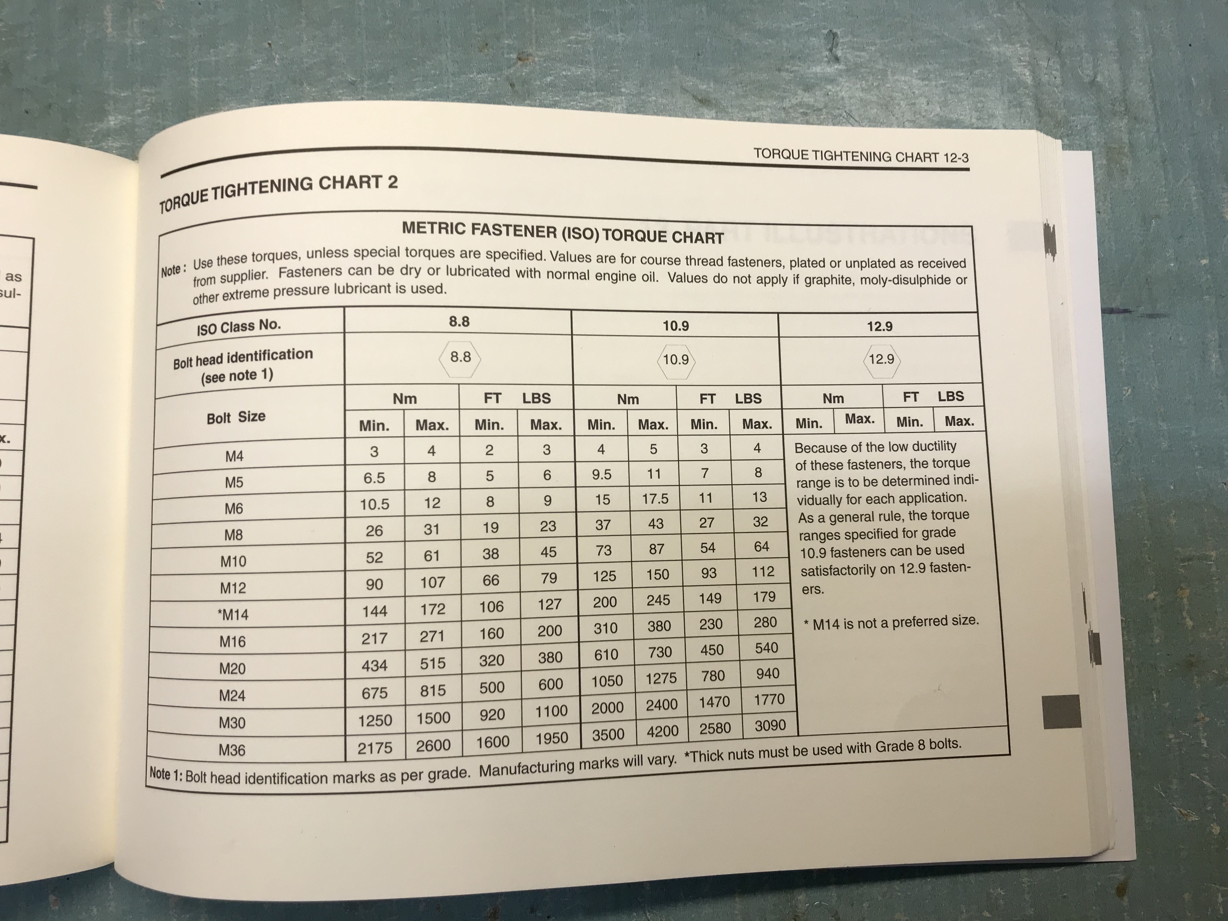

This is from my kl130 loader manual. Looking at the assembly instructions they list the size, quantity, and where to install the bolt. No other torque info so .... use the generic torque chart.
You have a larger loader and I would think larger bolts than what is listed in my KL130 assembly fig. Size your bolts and use the torque chart.

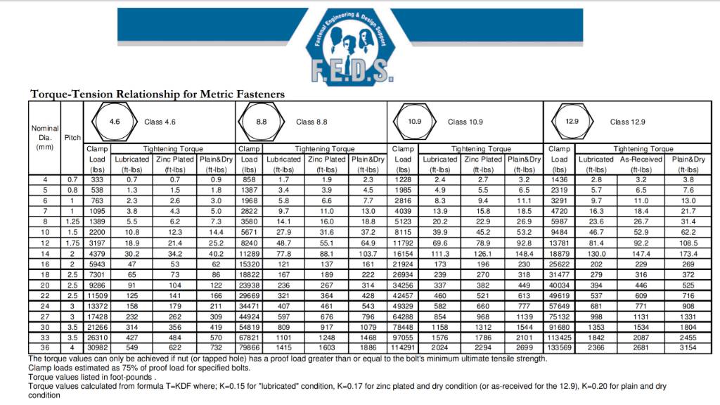

   / KL5510 FEL torque values #6
I see it didn't work. I try it different now. I have only the schedule for metric bolts. The imperial could be found in the net as well.Screenshot_20191026-081518_Drive.jpeg
