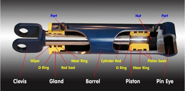

Best bet is often leaving the barrel side mounted to the loader, getting the proper spanner or rod in the hole, and hammering on the spanner or rod to spin the gland free. This way, the tractor is holding the barrel for you.
If the cylinder is already removed from the tractor, be careful with the vice, as these small cylinders can be crushed/deformed when clamping too hard.
Here's a basic drawing of your typical hydraulic cylinder to help newcomers visualize the task at hand. Note that there are many different types/variations of hydraulic cylinders, but this is a good overview.
